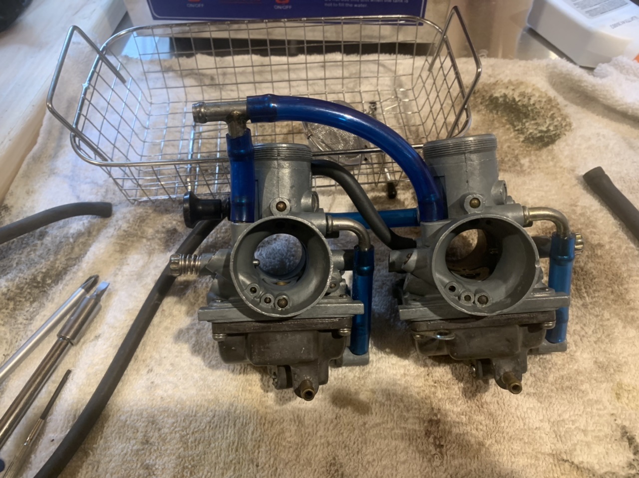

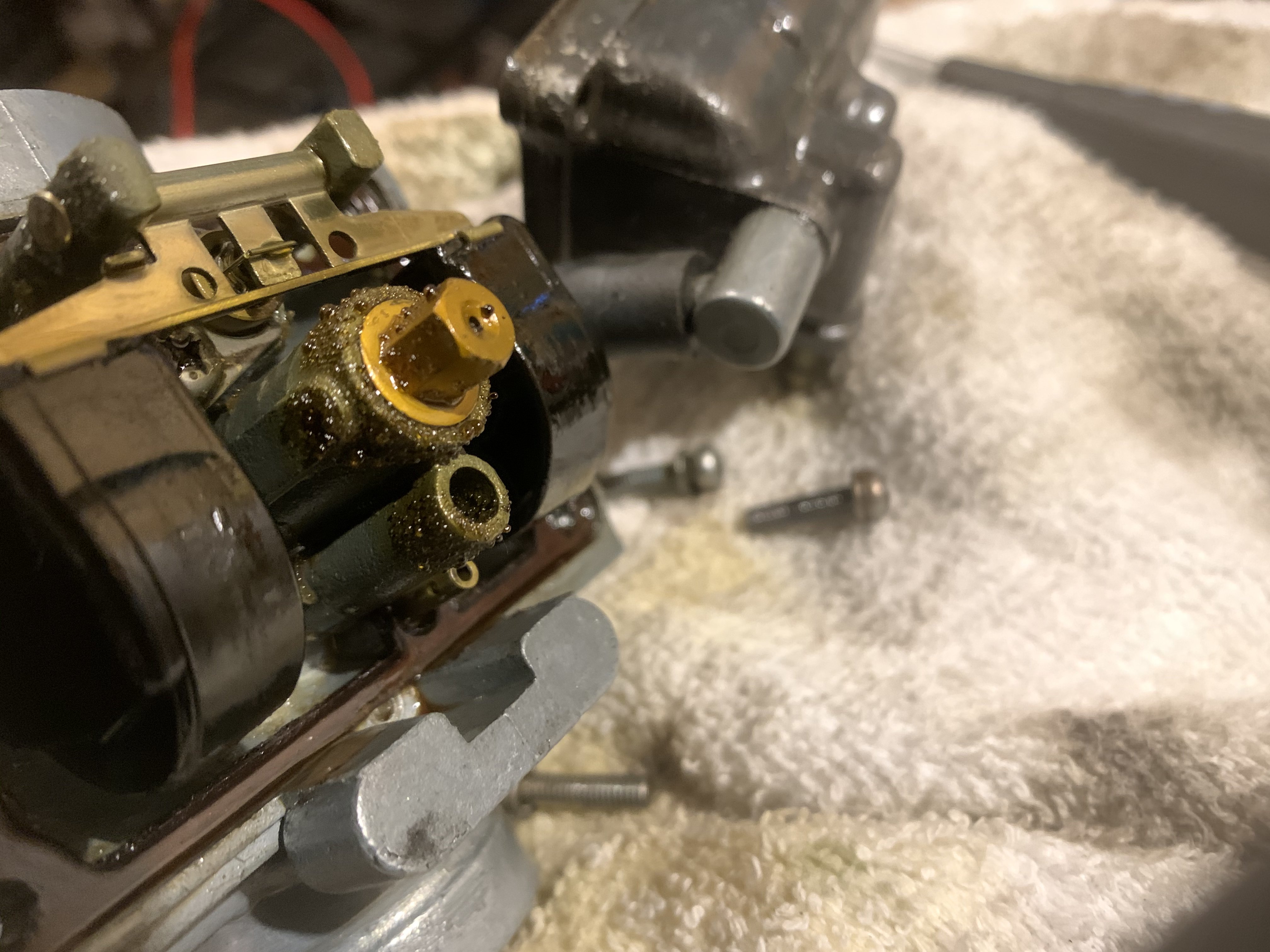

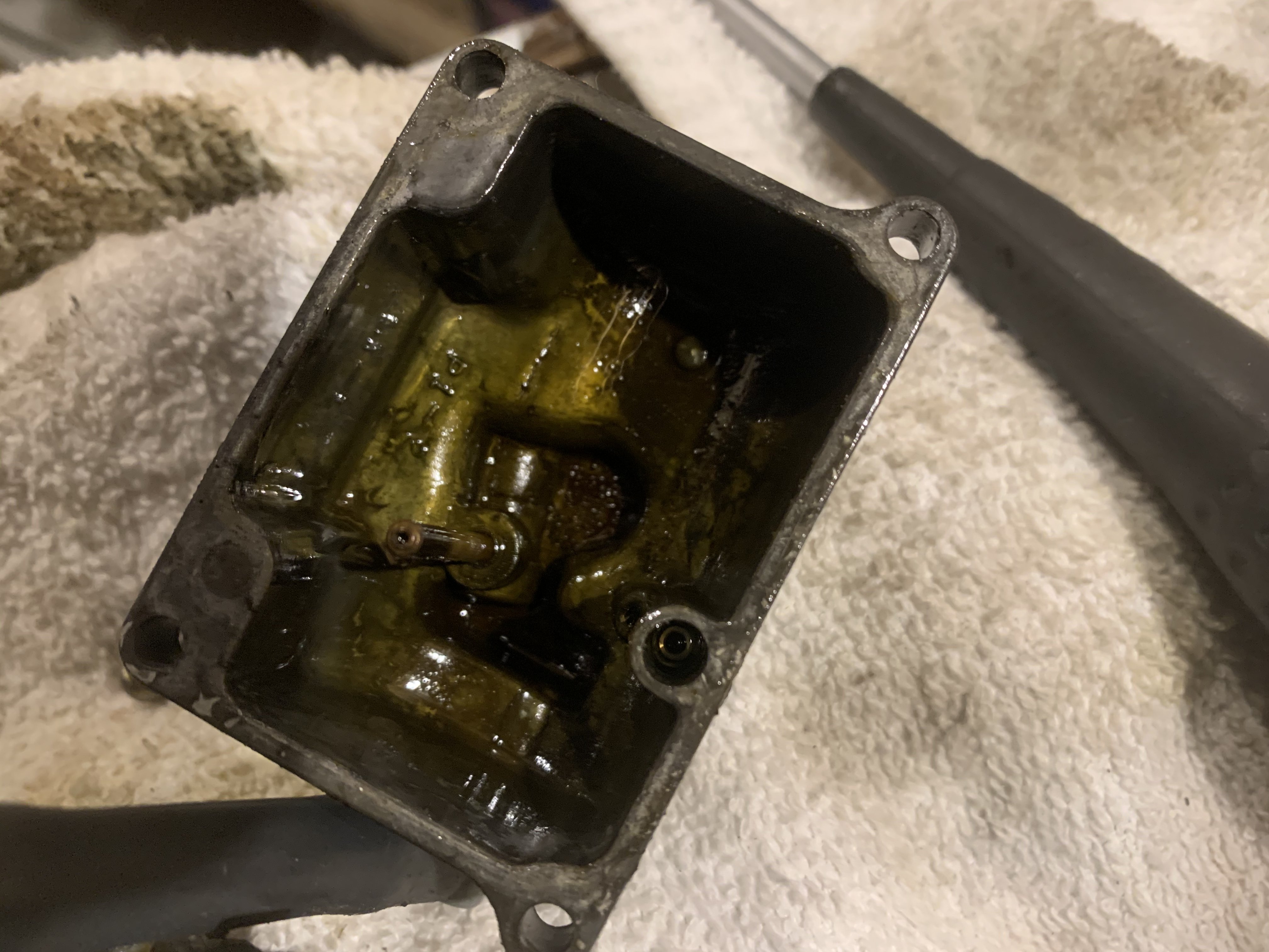

Opened the carbs for cleaning, bit nasty I’d say, and now the garage stinks. Need to give them an ultrasonic bath.

Carbs cleaned, and I'm kicking myself for not getting ultrasound cleaner before. I'm also kicking myself for not taking pictures of what I took off the bike as I have a brass fitting on the right carb, that has a line running from it, but I don't know where the darn line needs to go. The brass fitting is on the left side (inside) of the right carb and there is no obvious place for the line to run to. Anybody have advice on fuel line routing?
The carbs are not stock, but I found out the line is for petcock vacuum.
I’m freezing my ass in my uninsulated garage. I thought I had the carbs setup the right way, but it doesn’t look like it. The bike runs 1-2 seconds when I squirt 10-20ml of fuel in the cylinder and kick it over. Just enough to get some 2T smell in my garage. It seems that the carbs are not feeding fuel, or not enough fuel.
the photos show how I have my lines run. I hope somebody could give me some tips.
