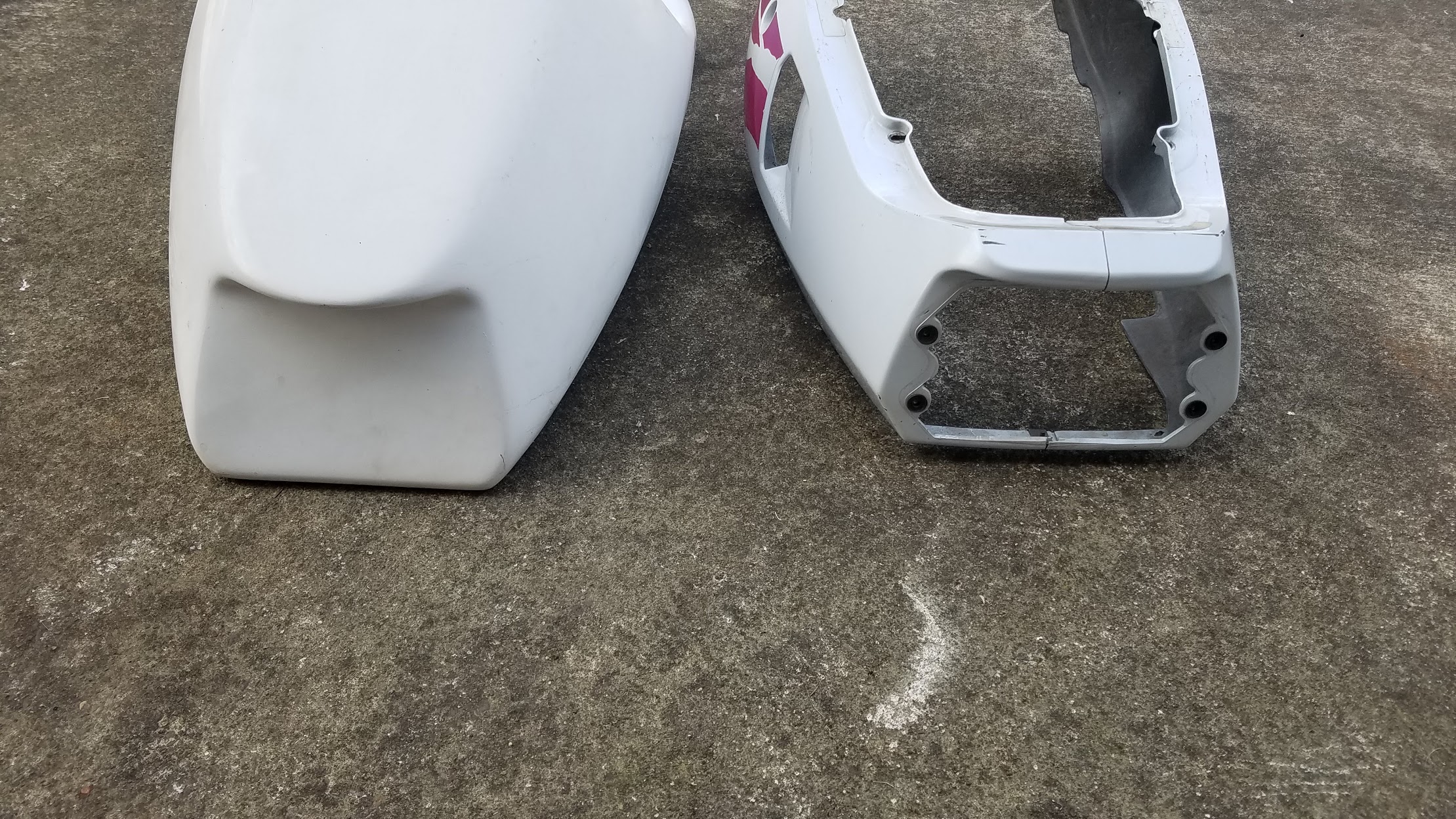

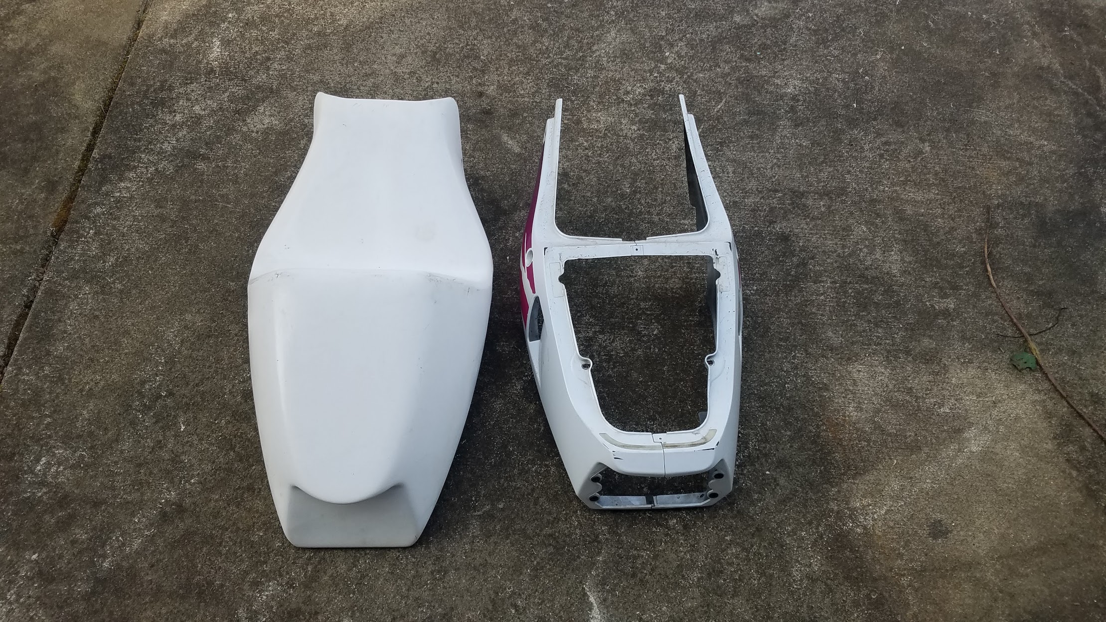

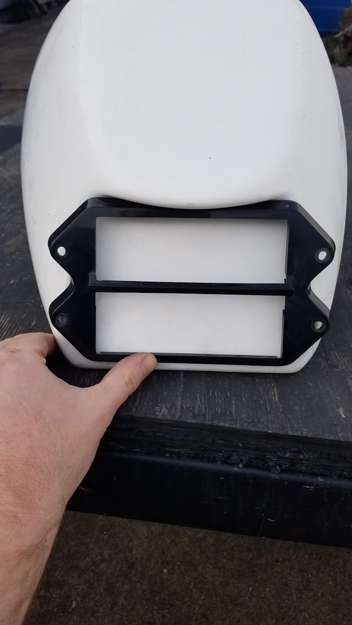

First thing I see is that the fiberglass tail section is slightly narrower in the rear than the original plastics. The original tail light is going to be too wide to mount. There goes my hopes of a more-or-less stock look. As with most engineering exercises, it looks like some compromises are on the table.

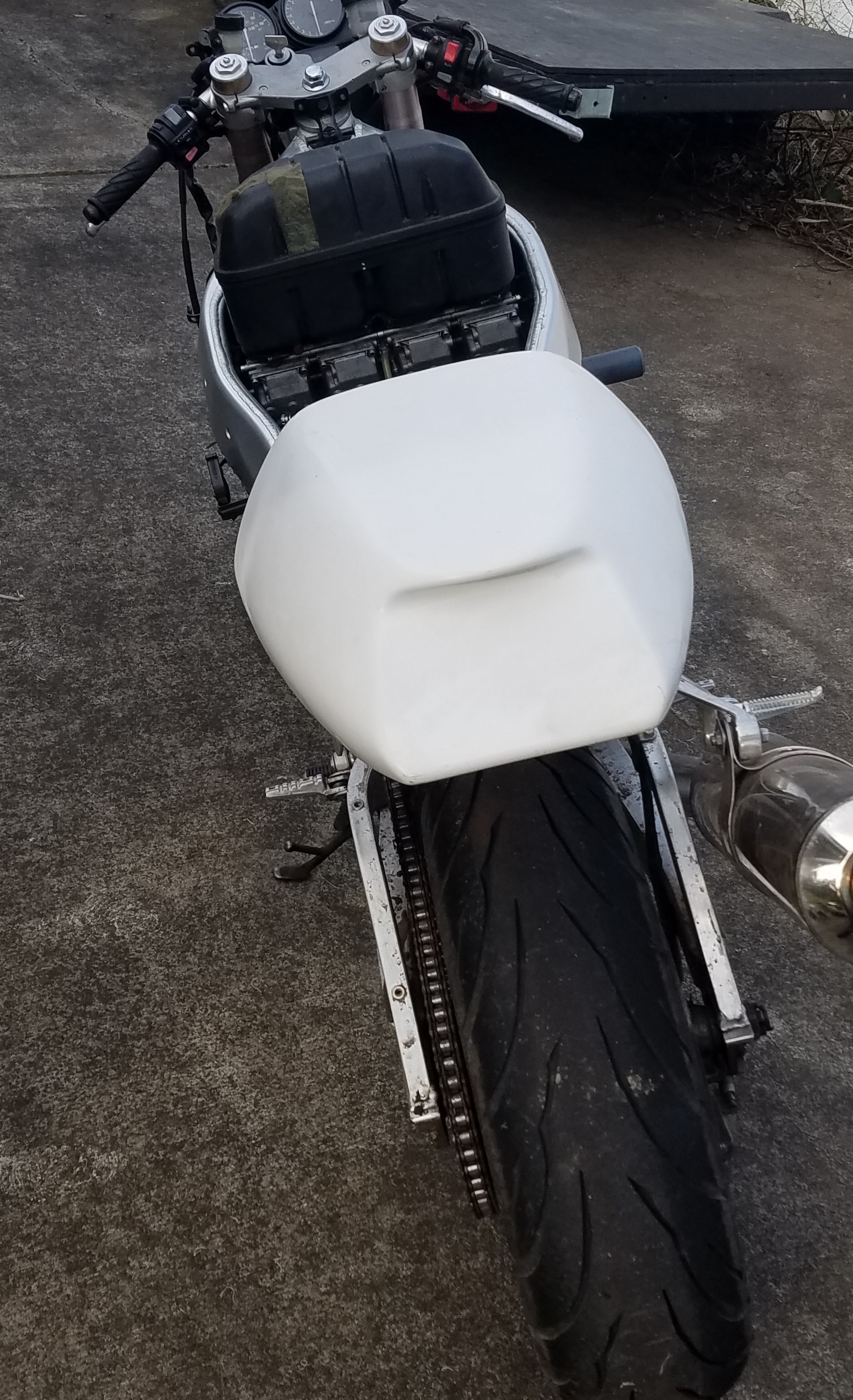

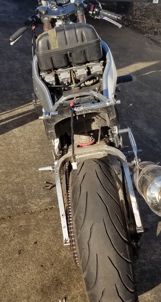

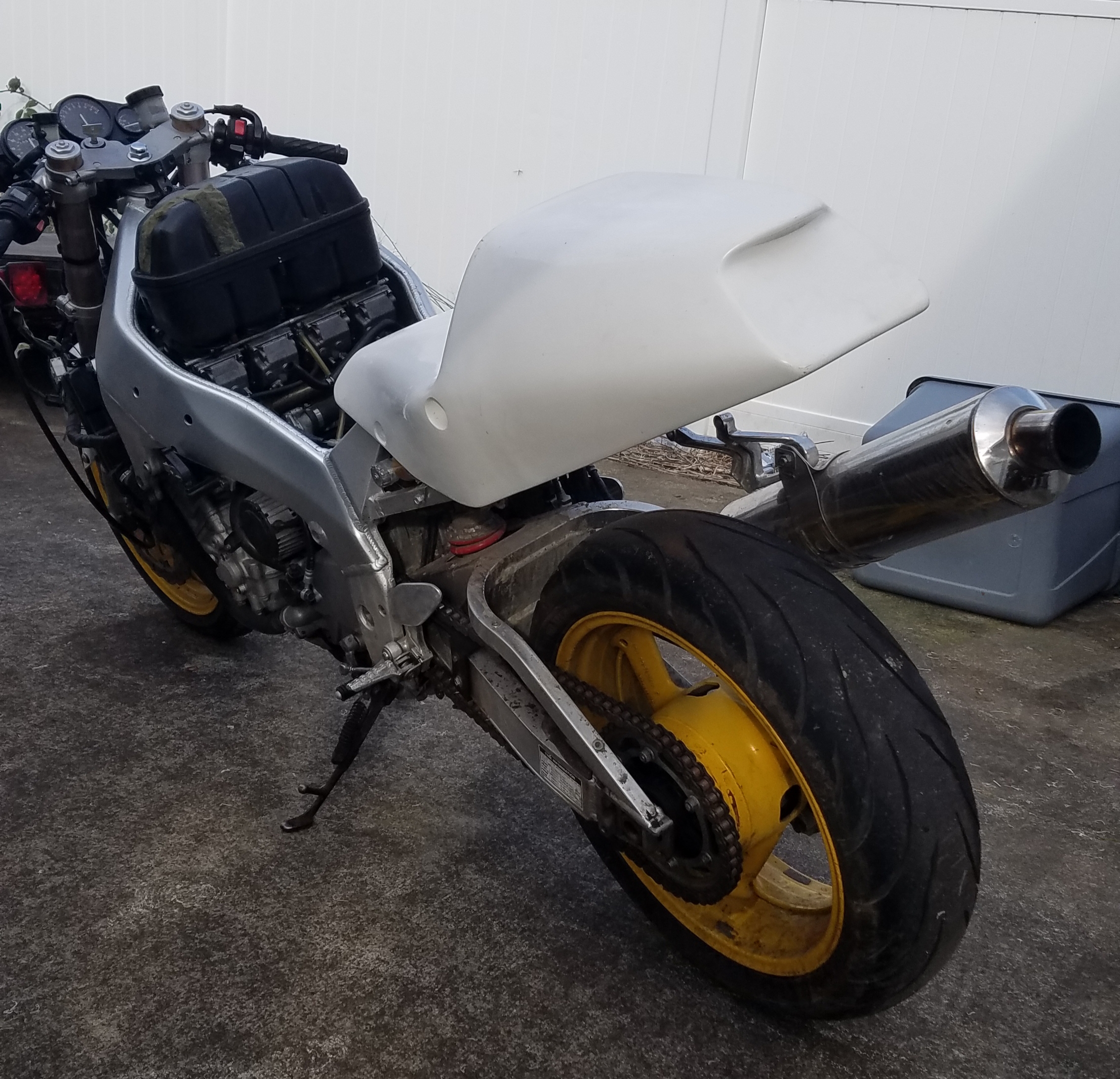

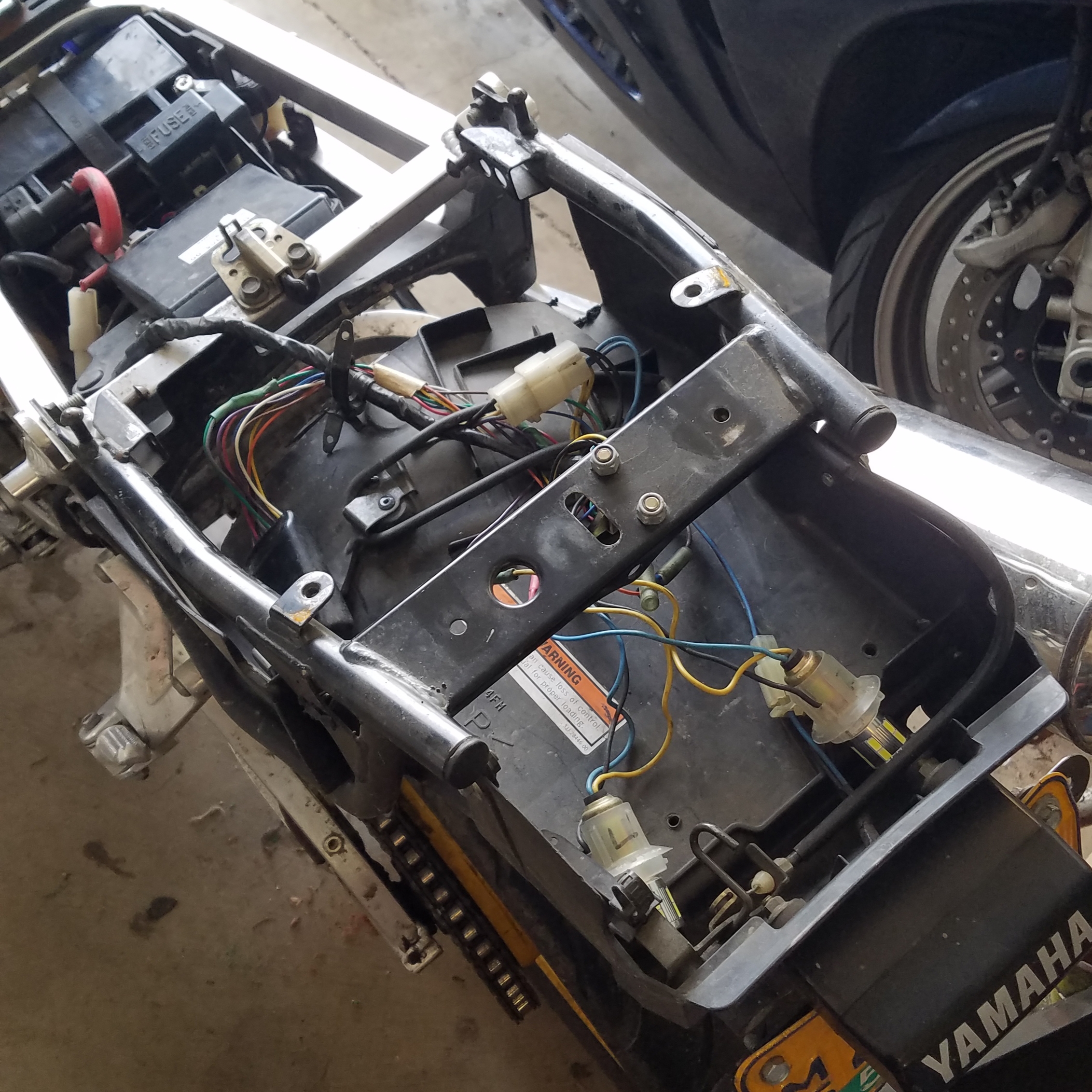

And it turns out the fiberglass tail won't fit over the rear subframe, so the subframe and associated pieces had to go. Goodbye pillion and passenger pegs.

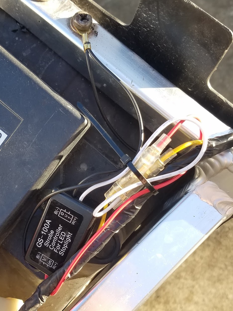

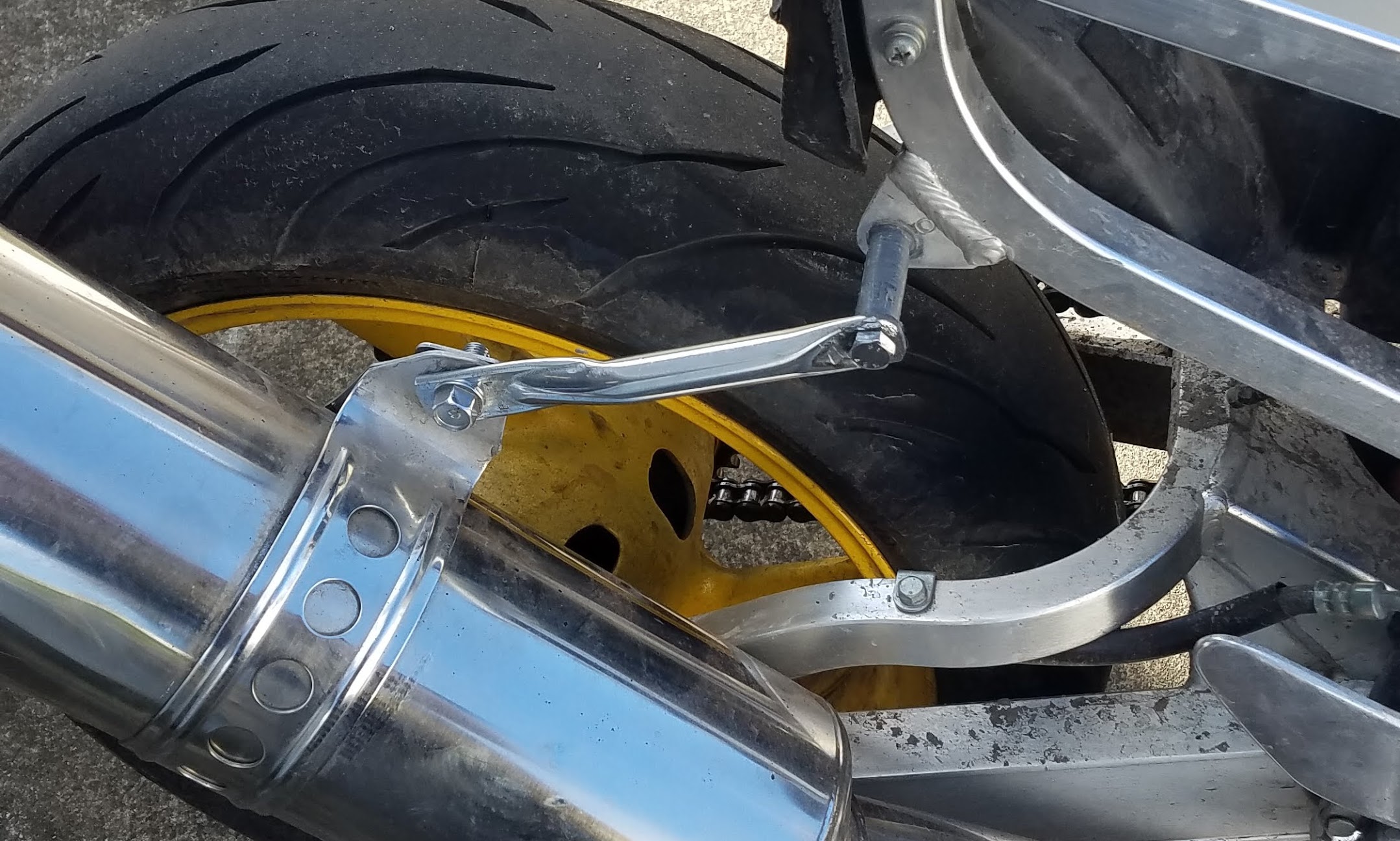

A new tail light is on the way from Amazon. I've removed the dual bulb setup and trailer module thing. Wiring is cleaned up and brake light modulator installed. The removal of the subframe also necessitated a new exhaust bracket (I cut up an old brake stay from a CB360) and a mounting method for the rear "fender". I drilled through from the old seat latch and bolted the plastic to the frame with a bit of extra sheet metal to act like a giant washer.

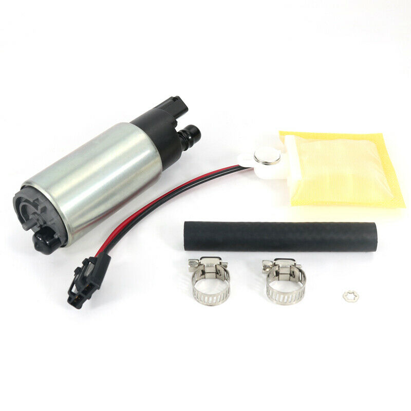

BTW, does that bike have a small cylindrical fuel pump? The 400 fizzer does and the point erode and the electrical components corrode from moisture in the breather duct. I had to replace the same pump on my late brother's Honda Hawk V twin and the spare for an FZR1000 I had lying around also turned out to have rusty and pitted points.

It has an in-tank mounted fuel pump.
In tank and Carbs? That's interesting. I'm used to in tank for EFI and external for carbs.

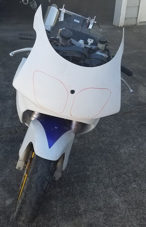

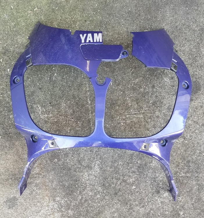

Old front fairing is a little broken, so I'm just using it as a template to transfer the cutouts to the fiberglass.

Unfortunately, it looks like we have some fitment issues here as well.
I'm assuming that this fairing was designed for race use, as the front mount is still several inches away from the fairing but the top is run up against the gauges.
Also, not pictured, is the locations for the frame sliders are now blocked.
Additionally, the headlight assembly mounts to the fairing (not the frame) and there are no cutouts for the bolt holes (which may need to be recessed).
Looks like I might need to consider some different options before I end up going too far down this rabbit hole.
