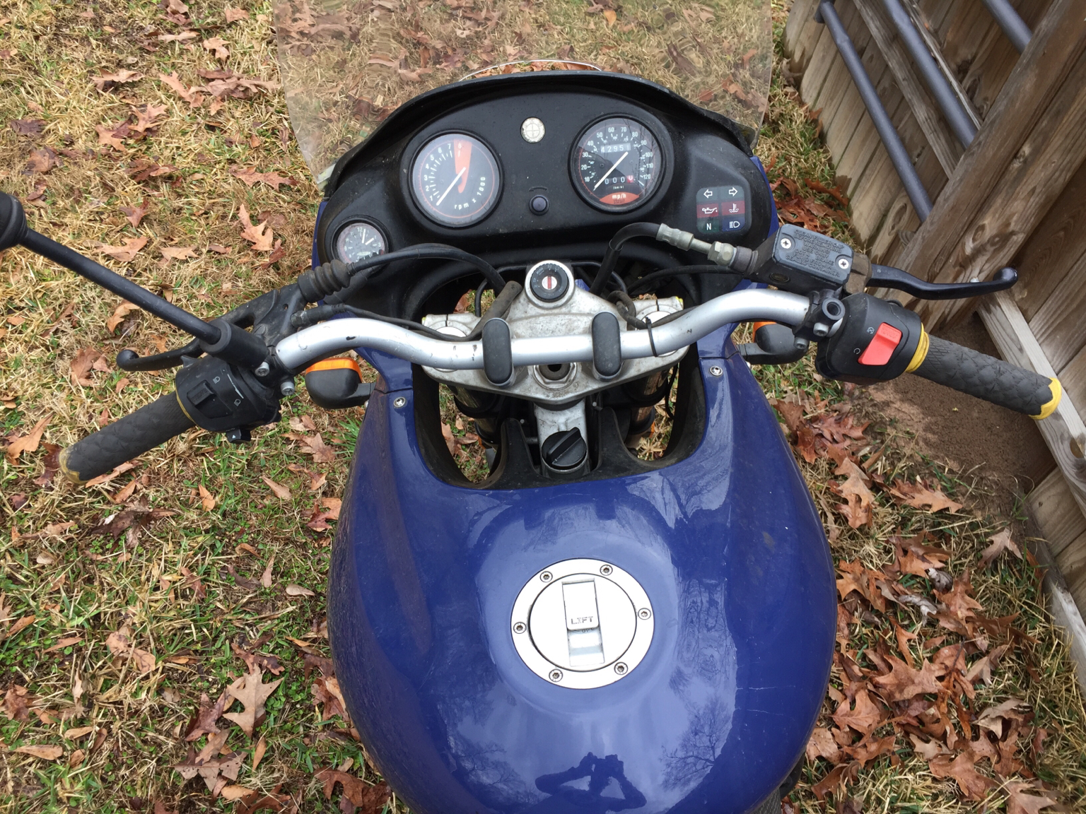

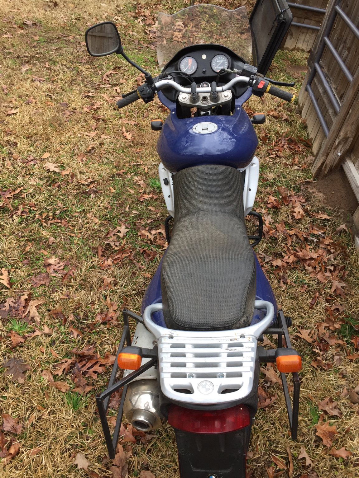

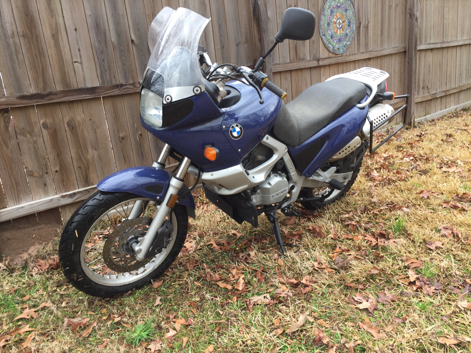

Over the winter I picked up this F650 ST. I had been wanting a newer, more reliable bike that I can use as a daily while I wrench on the vintage stuff. The seller disclaimed that it had some milky oil, and after doing some research on these bikes I narrowed down the possibilities to a faulty water pump seal, or a blown head gasket.
Once I got the old girl home, she looked pretty clean. About 50k miles and the motor should be barely broken in. The bike actually included all the original paperwork, and the maintenance records since new.
Besides the obvious coolant leak issue, a few cosmetic issues, leaking fork seals and some pretty thin brake pads will all get addressed.

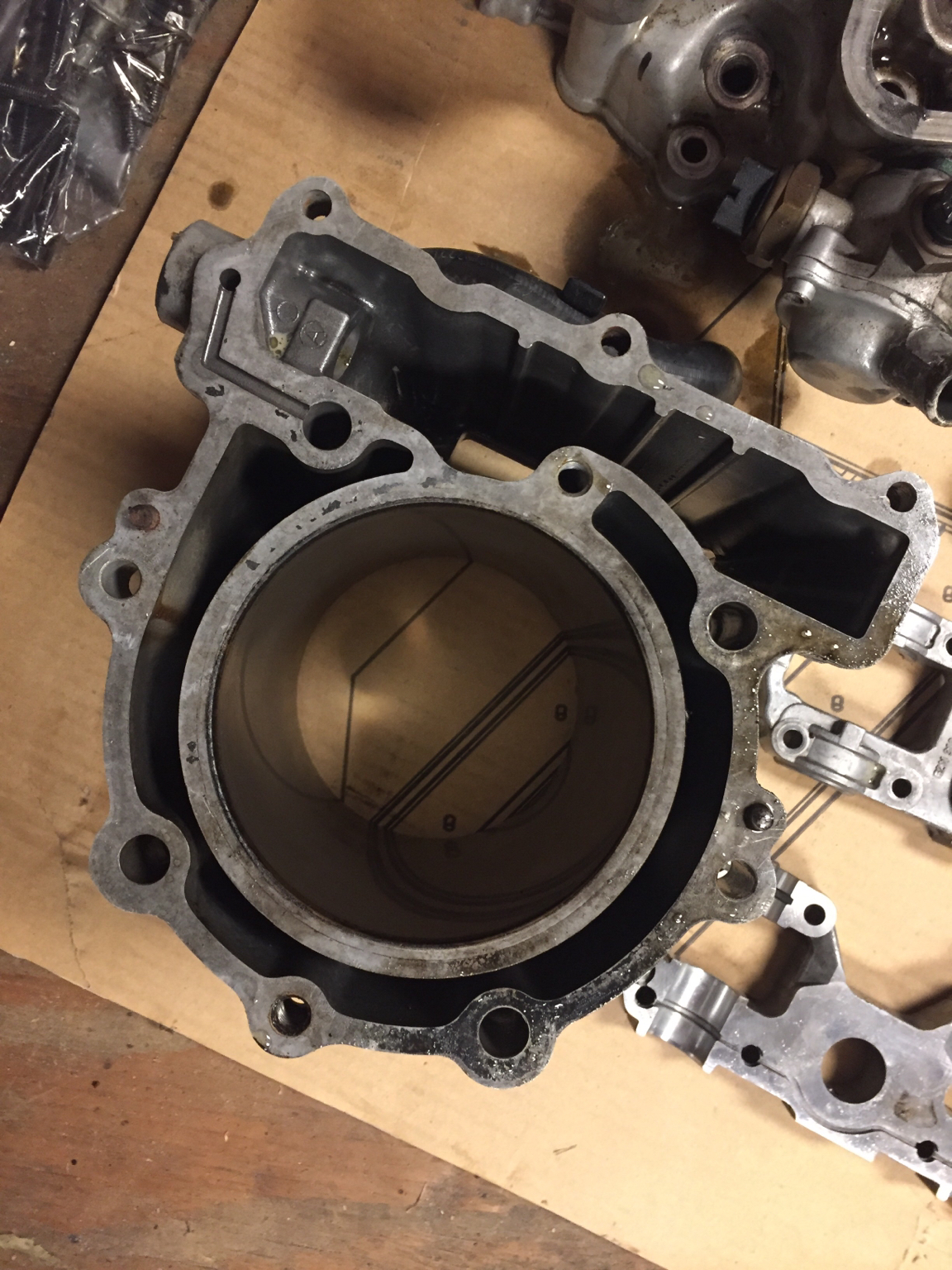

So into the motor we go. It’s a pretty straightforward motor and game apart pretty easily. Once I got the head off, it was pretty clear that the culprit was the head gasket.

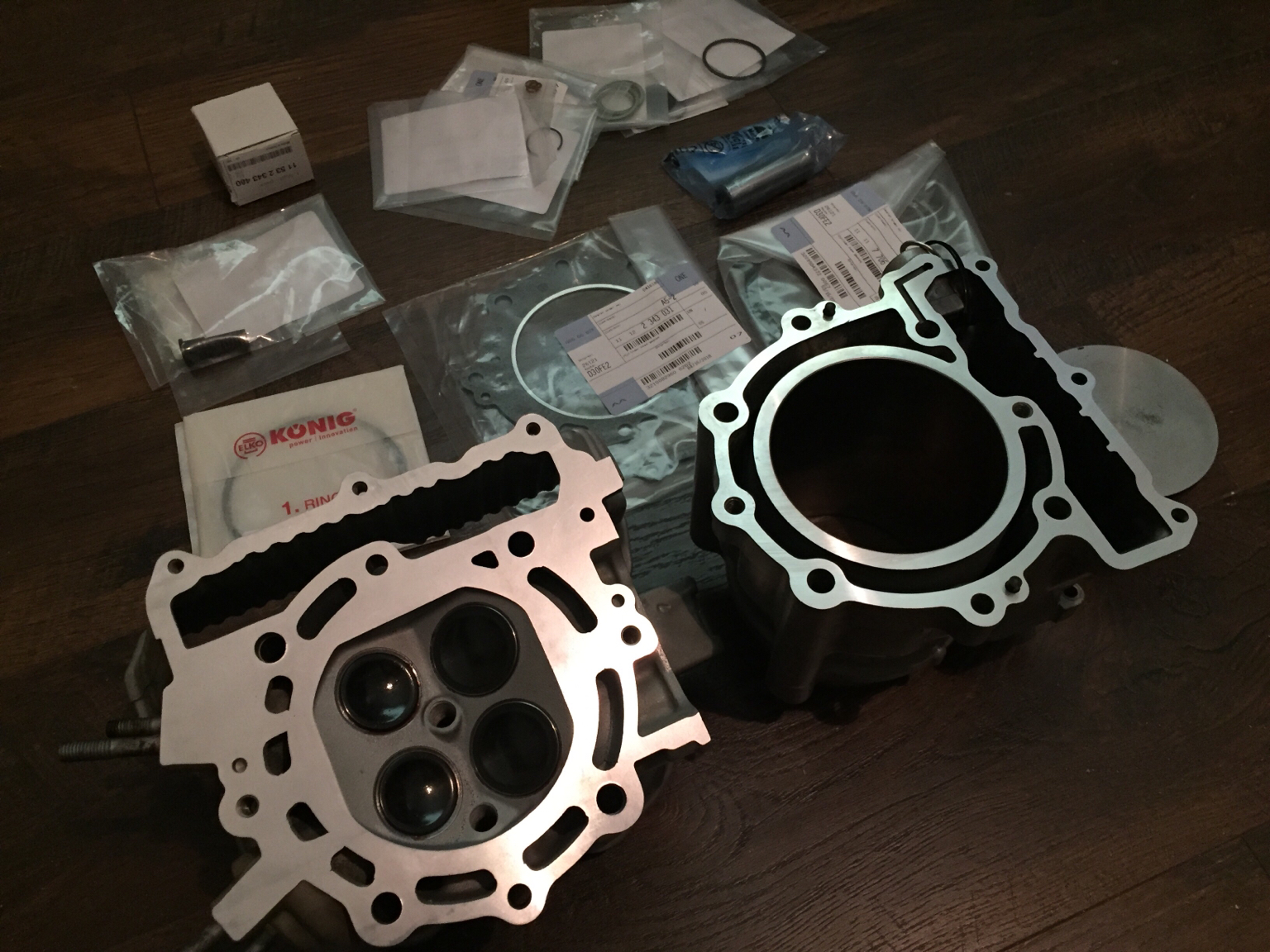

A pile of parts were ordered including new circlips, rings, a set of kibblewhite valves and seals, base and head gasket, etc.
I ended up replacing the thermostat since the PO had deleted it for some reason that is beyond me.
The whole top end went out to a local machine shop that builds racing motors. Cylinder and piston clearance measured within spec, and the original cross hatch could even still be seen on the barrel.
Machinist surfaced the mating surfaces between the head and cylinder. They pulled vacuum on the head and cylinder, skimmed about .003” off between the two surfaces, cut in the new Kibblewhite valves and shimmed the valves. I need to pop the valve cover off and check the clearances before I run it.

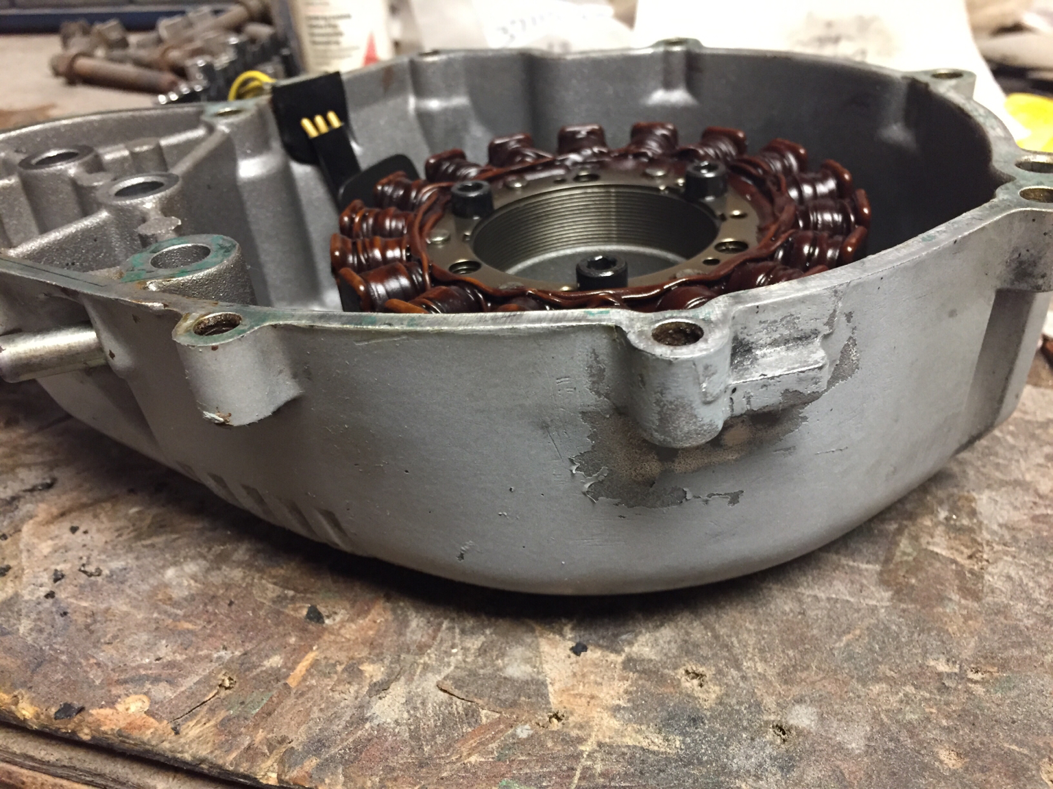

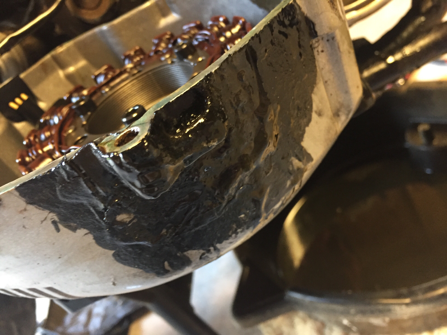

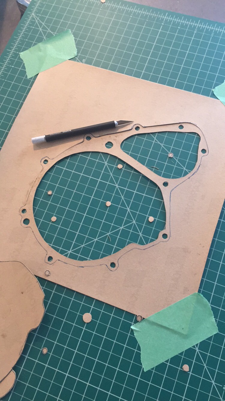

There was a big nasty blob of tar smeared along the bottom of the stator cover. I assume it was just weeping some oil and a PO didn’t feel like pulling the cover to replace the gasket. The cover itself is a little nicked up, so I’ll use some slightly thicker material to make a gasket and put a thin coat of Yamabond along that bottom edge to avoid any drips. I used acetone and a brass wire brush to get the crap off. What a mess.

Cut out some gaskets for the left and right side covers last night, installed new snap ring, greased and reinstalled the clutch actuator and then finally sealed the engine back up. Of course I forgot to grease the splines so I had to pull the clutch cover off again to grease them up, on the plus side I can tear down that side of the engine pretty quickly now lol.
