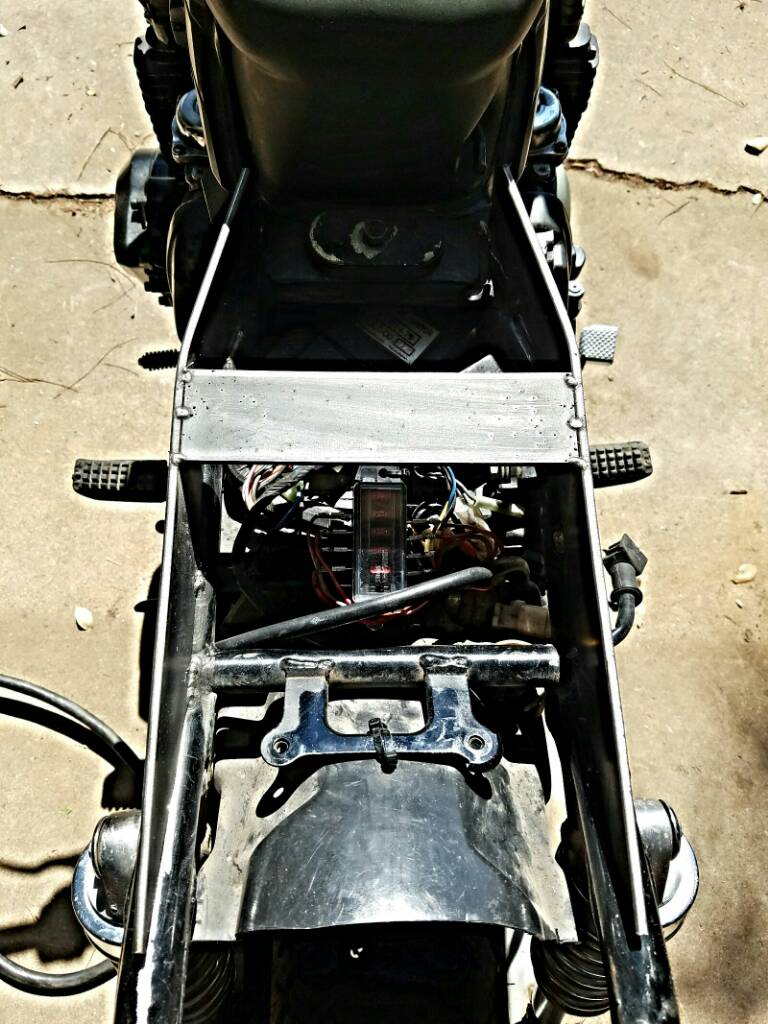

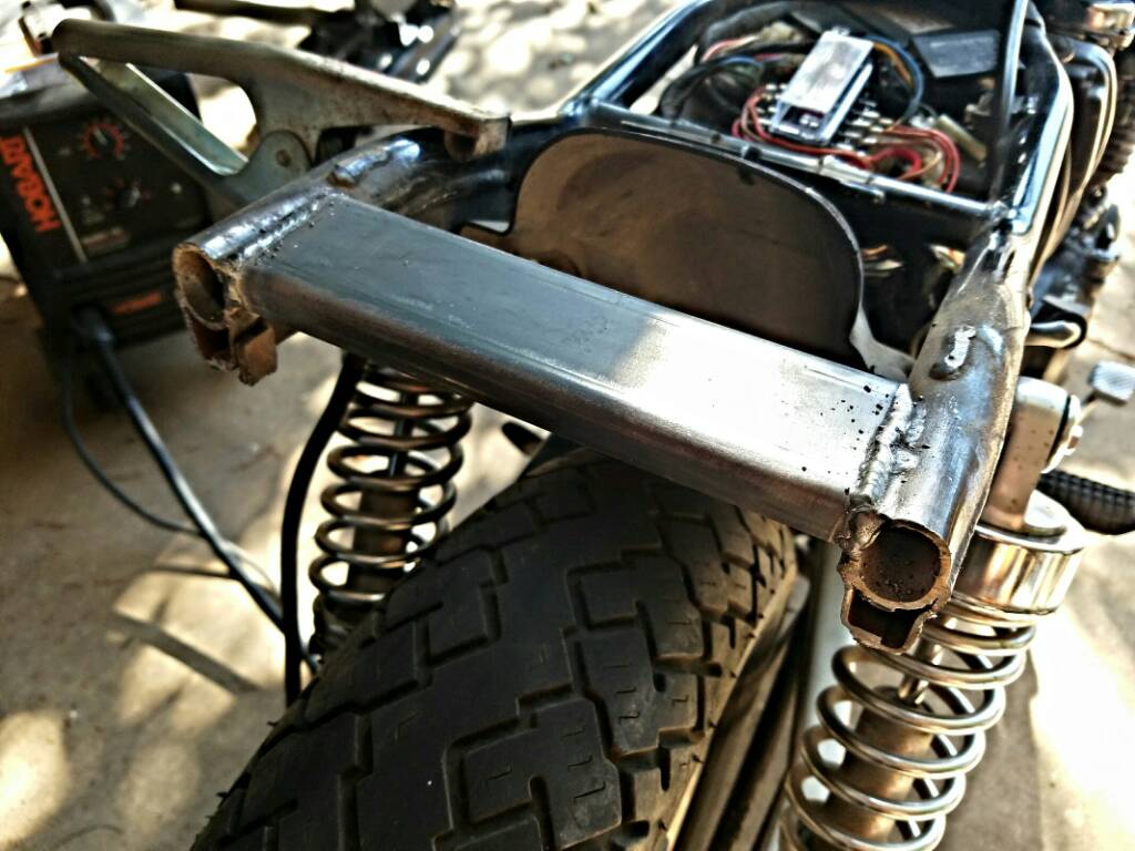

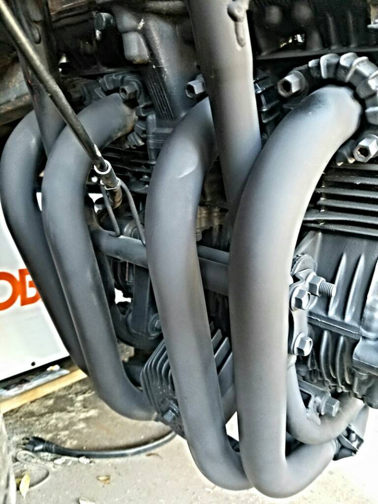

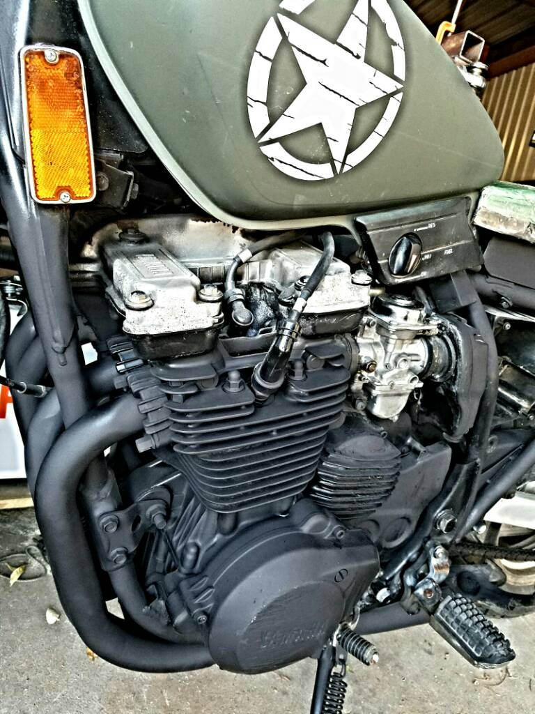

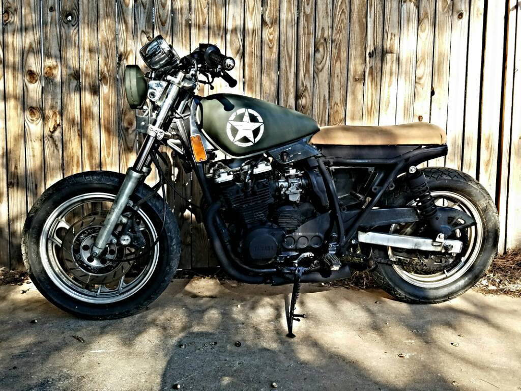

Update:
Today I...
-Applied weathered looking star decal to tank sides.
-Welded in rear frame cross member/seat support.
-Cut/bent/welded in sub seat filler panel/seat support. (to hide electronics and help hold up seat. New steel still needs paint.
Going to upholster seat this evening; using an old carhart jacket. (it's currently still just foam over wood).
Up next: clip ons, knobby tires, paint lower forks and rear swing arm, heat wrap exhaust.
...getting closer...
Sent from my SM-G935V using DO THE TON mobile app

Got a wild hair and decided to see what the rear coil overs would look like black. Digging it...

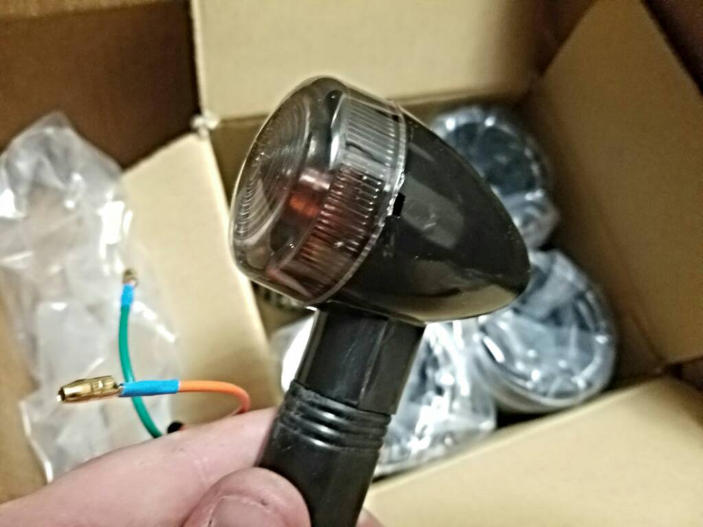

Clip ons, grips, turn signals and license plate lights ordered.

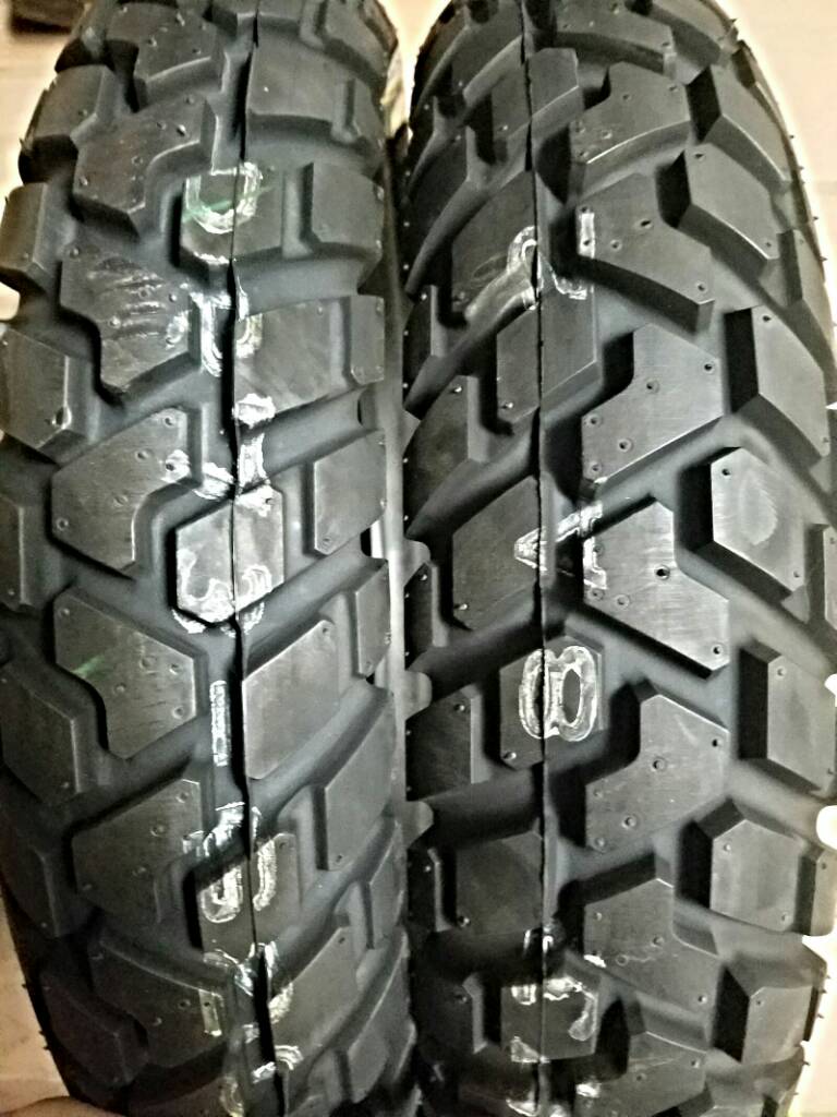

Also think I found the tires I want. Bridgestone Tw's.

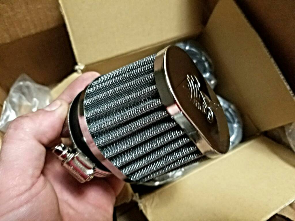

Tires and filter pods ordered.

I need recommendations on rejetting the carbs bc I know I'll need to. Anyone have any good pointers? Thanks!

You will have a hard time playing with carbs + pods. I have seen several FJ/XJ 600 builds with pods and they ran like crap. I went with stock airbox on my build and would advise you the same.

That's the advice I keep hearing, but being stubborn I want to give it a shot at least.
The stock airbox is massive and ugly, plus if I get rid of it I can more easily relocate the battery.
What jets did you unsuccessfully try with pods?

I didn't re-jet mine, but two bikes i've seen had the same jet setting and they didn't run the same way. Maybe it was the general condition of carbs/engine that was responsible. You could try making a custom airbox or velocity stacks? I've talked to a guy once who had custom made stacks with CV carburator and his bike ran quite well, but as far as I remember making the stacks required some havy math skills. Stacks for cylinder #2 and #3 were longer than #1 and #4 and pointed outside in order to compensate for the cold-hot air density. Air that reaches #2 and #3 carb is slightly hotter and has a different density. The stock airbox allows for air to mix and even out the temp.
Check out this bike :
http://www.pipeburn.com/home/2016/03/08/cafe-terror-xj600-by-custom-operational-group.html
It has a custom made "airbox", though it looks like a one big pod fiter in a box.
