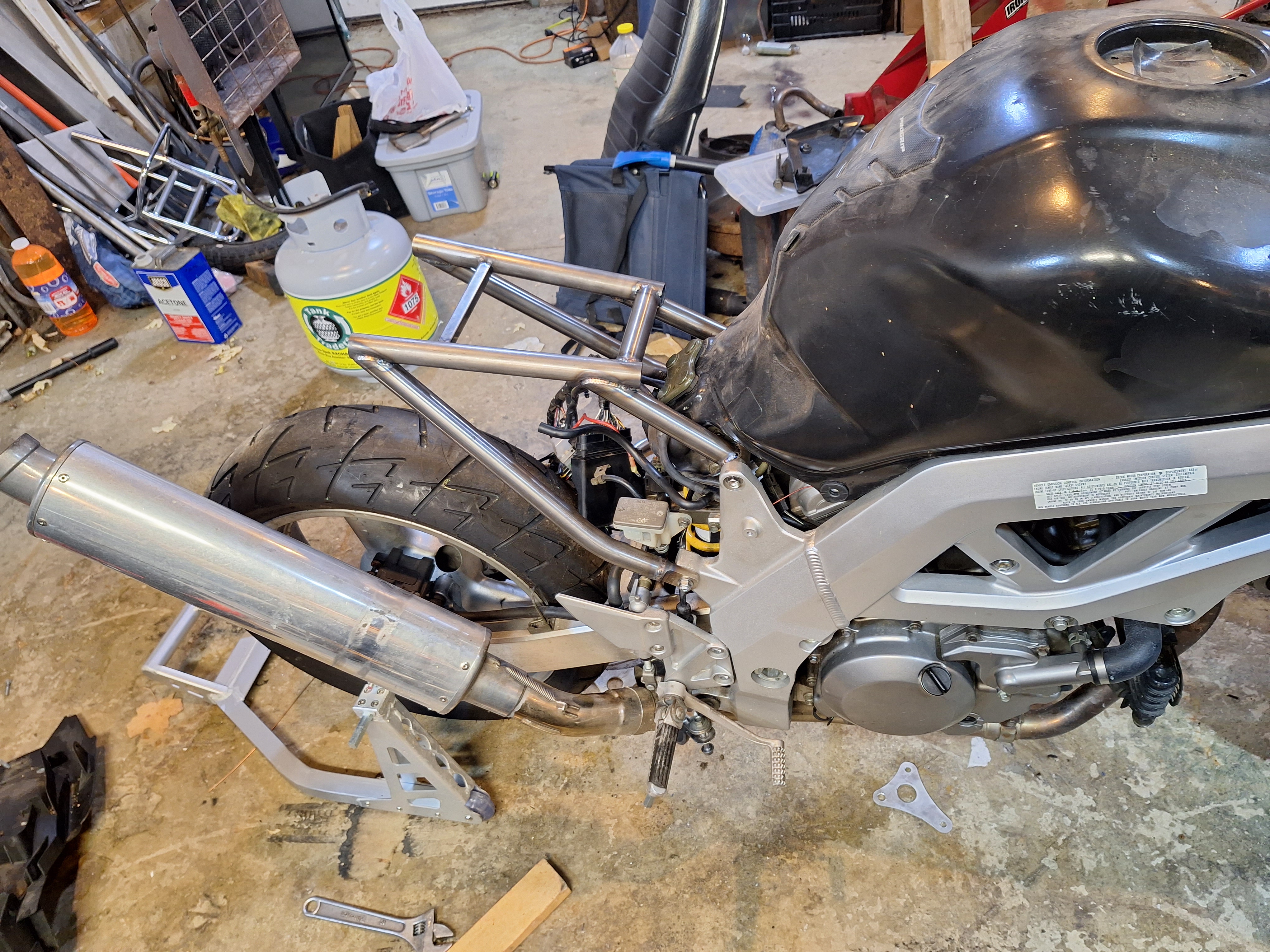

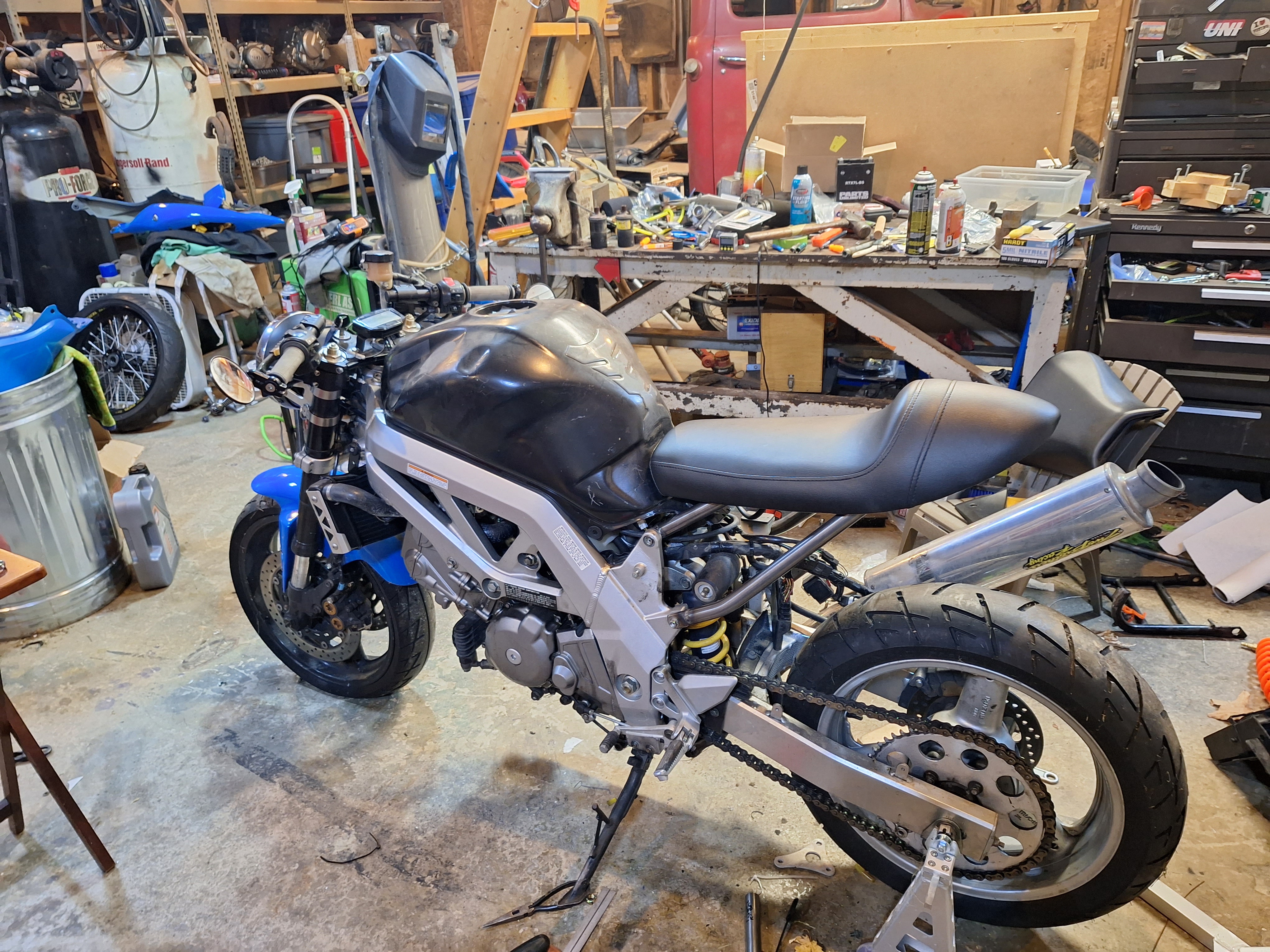

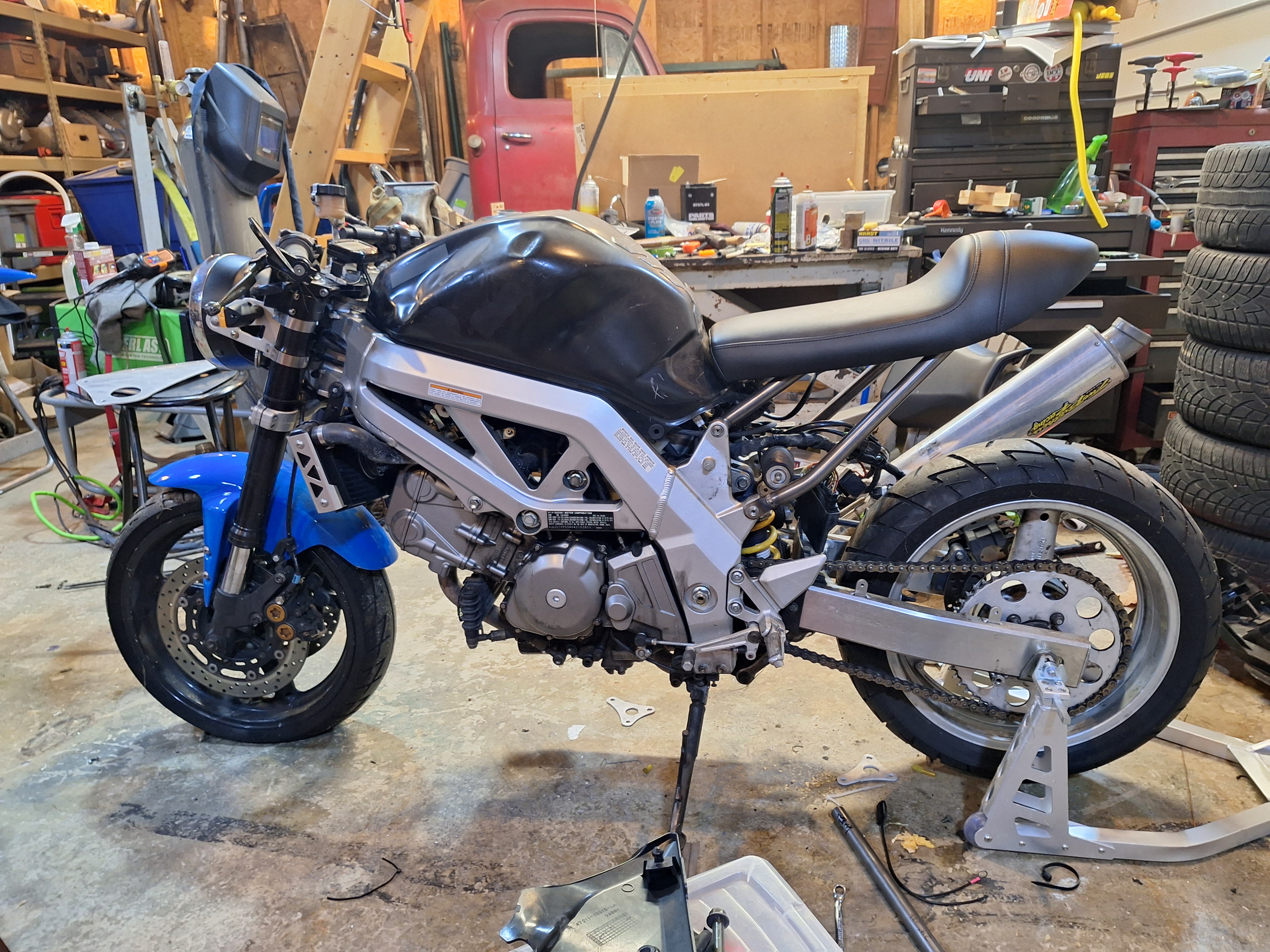

I do think that in stock form that the naked SV650's are good looking machines, but as most of us here, I enjoy a bit of a retro vibe and the factory subframe and tail section was just a bit too "early 2000's sportbike" for my liking. I ended up buying a pair of these "wrapped cafe seats" that used to be for sale by Dime City Cycles. I purchased them from the guy that made them for DCC and had two left over. After pulling the stock subframe off and throwing this on there, I decided that it was a good direction to head.
With a bit of measuring and Autocad work competed, I made up a quick and dirty aluminum subframe.
After putting it on the bike, I was able to confirm that I liked where the seat was positioned and it was a comfortable enough seating position. Though it may look extreme, it's actually in the same position that the factory seat was in.
Though I'm going to likely jettison the aluminum plate design in favor of one built from chromoly tubing, I am happy with where it puts everything and I feel that the proportions and position are where they should be. I am also using a spare tank during mockup as to not scratch the nicer one, but it has me thinking that the stock one may end up needing resprayed in black as well..

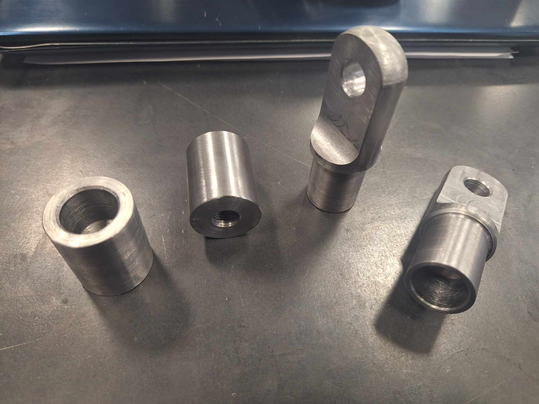

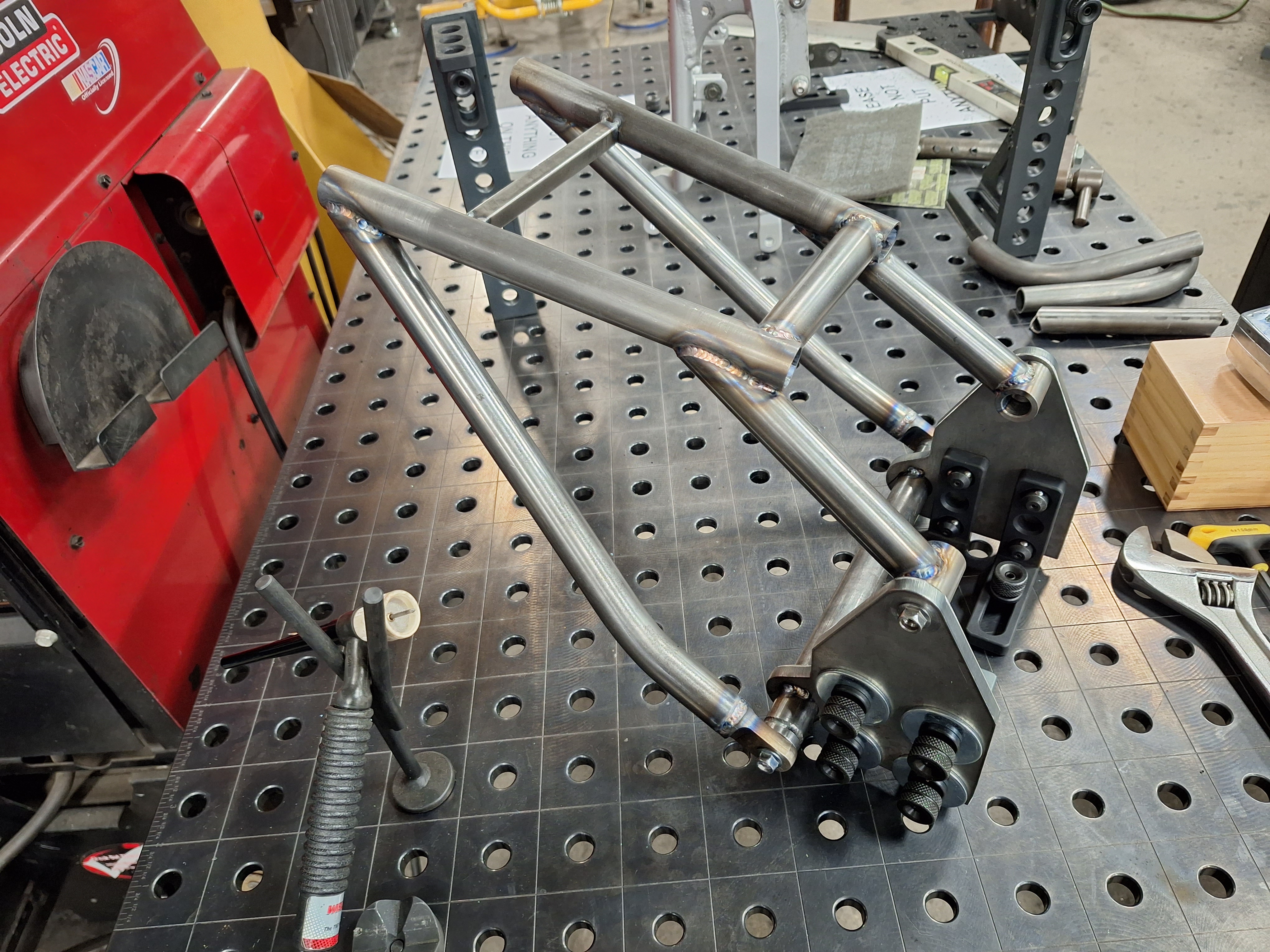

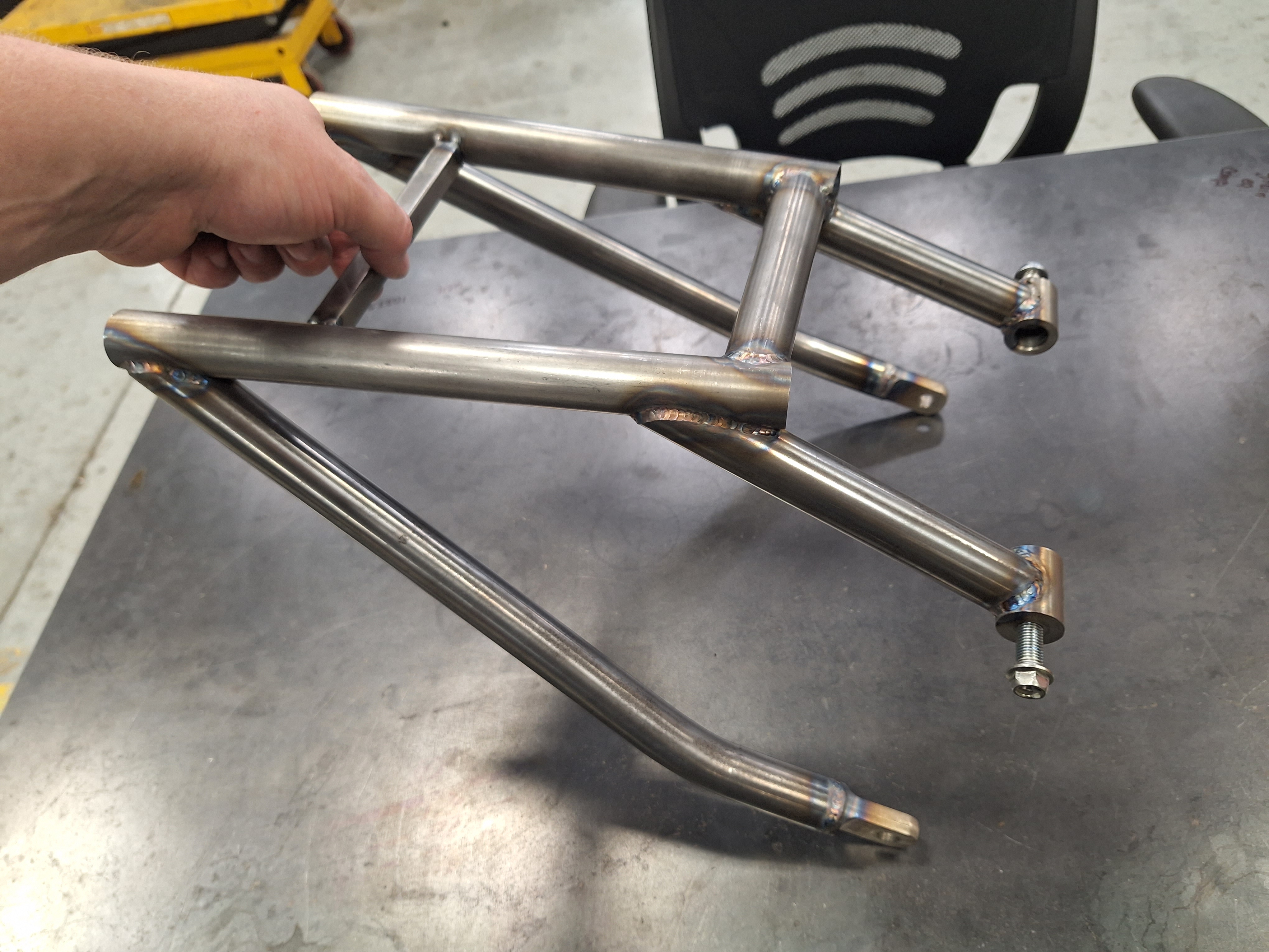

Thanks yall. I appreciate the kind words. The more I looked at it, the less I liked the subframe myself. It just had too bulky of a design, so I decided that I would fab one up out of chromoly. I still have to make the "bottom struts" but im getting close. I think it will look nice when done, though tidying up the wiring and hiding it under this seat will be a bit more of a challenge.
Got the main part of the subframe done. Now to build up a battery box and tidy up the wiring..
Is that a Kovosu fixture table? looks super nice. I have a Certiflat and its OK. I have been thinking about getting something bigger and the Kovosu seems like good value for the money
It's a seigmund 5x10 imperial (5/8" holes 2" on center)
A good fixture table is a game change for sure!
View attachment 238430View attachment 238431View attachment 238432View attachment 238433View attachment 238434
Nicely done, however, not to be nitpicky, but, the round tubing of the subframe does not aesthetically match the angular shape of the second gen frame. Perhaps if the subrame were made of rectangular tubing it would match better. Maybe you should whip up another one in your spare time so we can compare them. While you're at it, I liked the first one you made out of the sheet metal, except for the round holes. Maybe you can square off and elongate the holes into rectangles and we will see how that looks. :) Just kidding, it looks great, very racy.
Some super impressive skills! I actually quite liked the first iteration, though the second is awesome too. No wrong choice if you ask me
Haha thanks fellas. I didnt "hate" the first iteration with the aluminum, but it wouldve taken plenty to make it function right, and still possibly not even be any lighter than the stock unit. And I am lucky to have access to things like the fixturing tables, and theres always a good lesson on reverse engineering and measuring with my fabrication classes when a project like this comes along..
