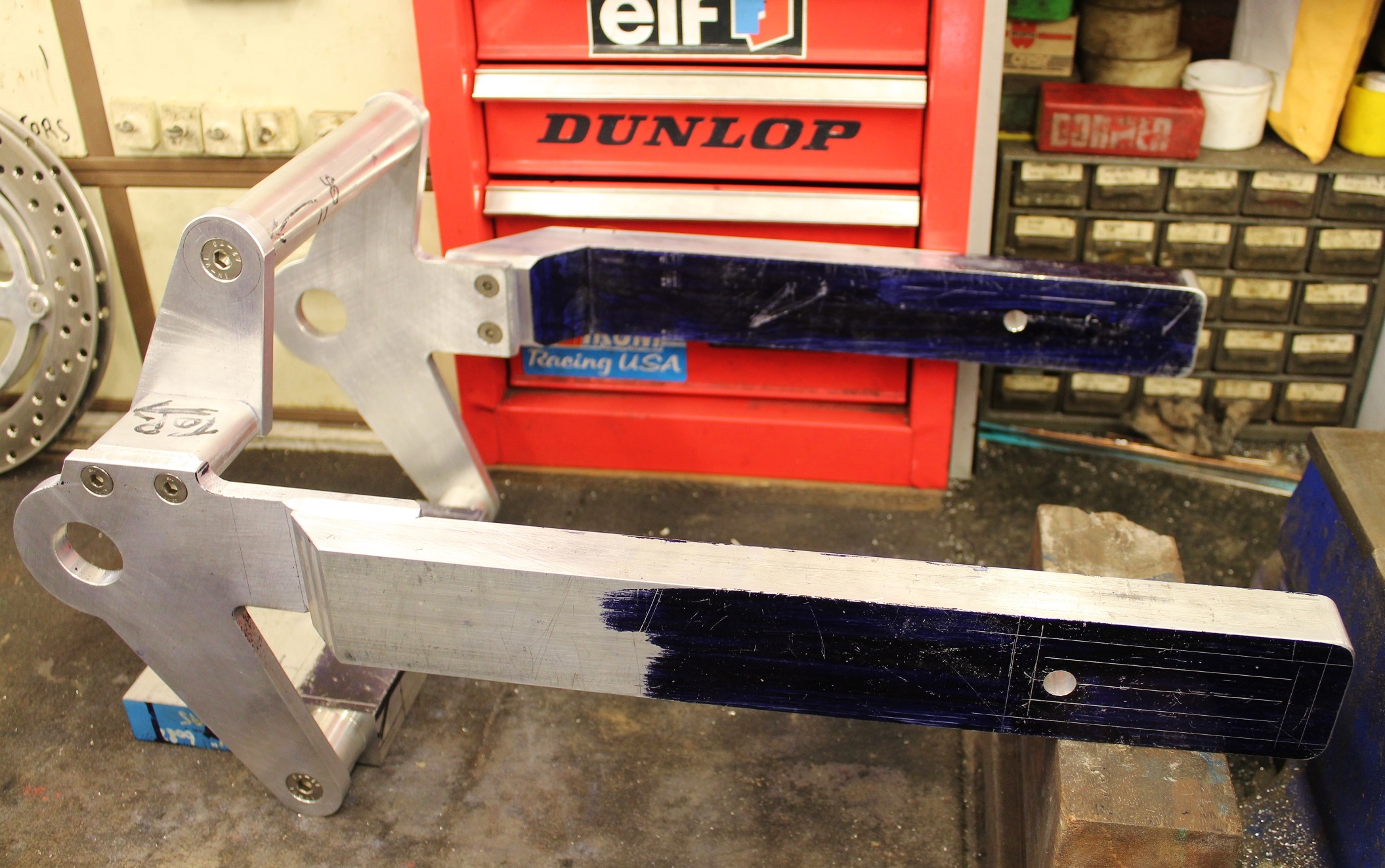

The alloy swing arm is progressing surprisingly well (touch wood).... 15 hours of machining so far, and this is how its looking.
Harley parts aren't known for being lightweight, and sure enough the original swingarm of my aftermarket chassis weighs a hefty 34lbs. My target is to halve that with this new alloy copy, so far with all components it weighes 20lbs, but there's still a pound or two to lose, so the target is possible. 17lbs is still a boat anchor in sports bike terms but its better than 34lbs.
Note the 'V' shaped grooves machined into the arm where two pieces are bolted together. This is where its going to be welded, as the groove allows for a neater stronger weld.

Since the frame and swing arm is aftermarket and non standard, the only way of having an alloy swing arm would be to commission one from one of the few decent frame builders in the UK. Last time I asked (a few years ago) Spondon wanted £3000, so I didn't bother!
So far the new swing arm has cost £130... £40 for the bearings and £90 for the alloy, so not too bad. Though it may end up in a new project, haven't decided yet.

£130 is damn cheap for 'custom' swing arm, I guess your not paying for CNC time?

I don't have access to a CNC miller, its all done by hand on a miller made around 1965.. that's why it takes so long.
Far more impressed when you 'twiddle the knobs' by hand ;D

The alloy swing arm is making good progress, this weekend the holes for the wheel adjusters will be milled out, along with removing some material from the inside of the spars to lose some weight. It shoulds be ready to be welded up early next week..

The slots for the adjuster blocks have been milled out of the two swing arm spars, while another half kilo has been saved by milling out the inside of the spars. I quick guesstimate says it'll be less than half the weight of the original steel arm when finished.
