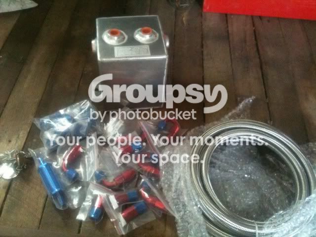

I have most things that i need to get the rb20 in and running but one thing i need is a fuel delivery system. I recently purchased a surge tank but i still need the lift pump and main pump. I will probably use a vl turbo for the main pump but i am on sure what pump i will use for the lift pump.

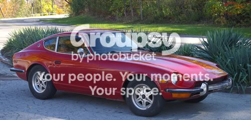

Here's a picture of mine. 1971 240z - 1st Generation. Worked on it off and on for 6 years, finished it last may. 280z Block with 5 speed manual.

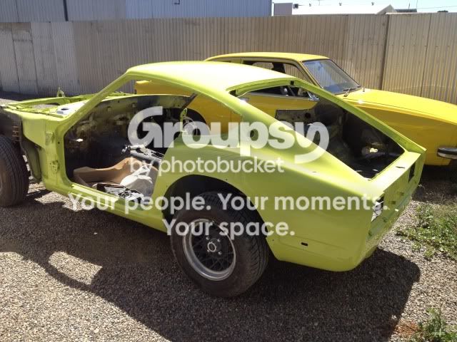

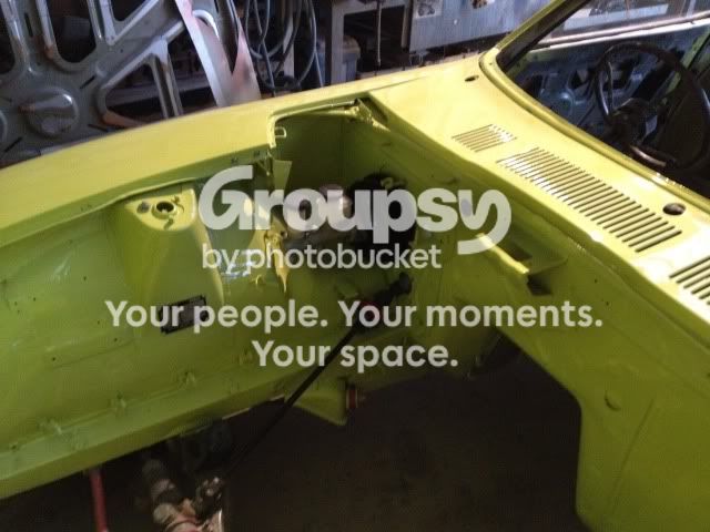

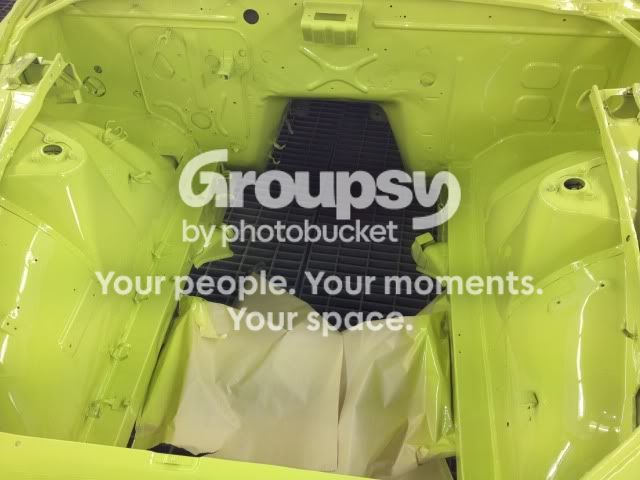

All the body has been painted at last ;D Now i just have to wait for all the trims and garnishes tyo be painted and there will be no stopping me putting it all back togeather

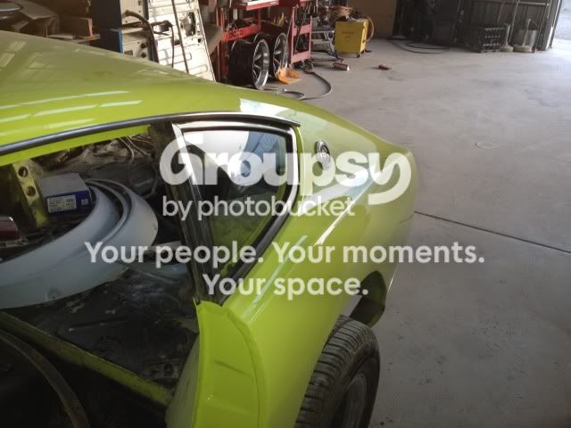

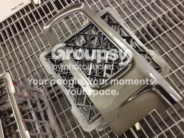

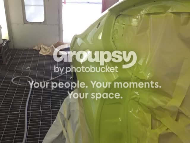

had the tail light surounds flares and bumbers painted today

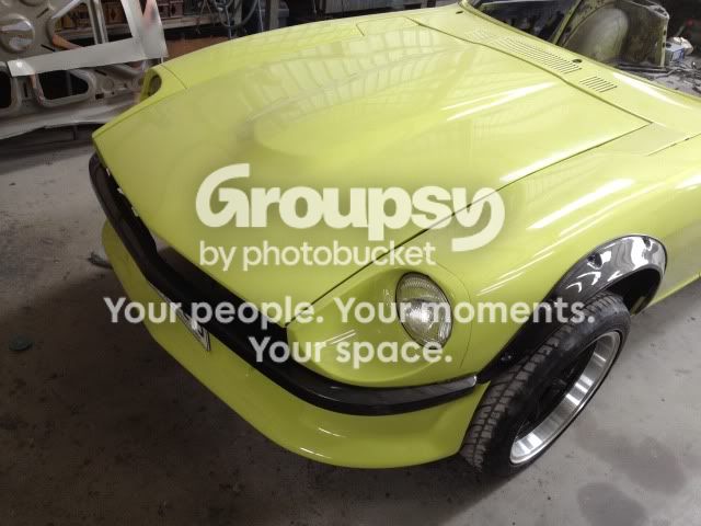

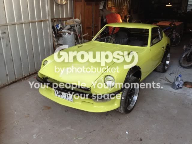

I fit some old second hand rubber to my rims for now so i can fit up my willwood brakes. unfortunatly they would not fit in side the 14 inch rims and i still need to be able to roll it around. I will put some new tyres on when it gets closer to putting it on the road. These tyres are 235/45x17 all around but i will more than likely run 245 when the time comes.

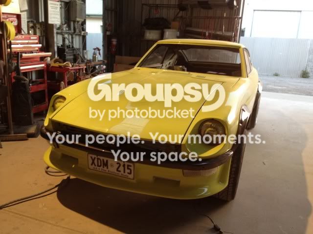

More pretty pictures ;D next week i will be putting in some brakes so i can bring it home ( i have a rather steep drive way and would like atleast a hand brake so i dont lose it through the back of the shed :o
this week i have been working on getting the brakes fitted up. the fronts were easy as they came in a kit. but the rears are from an r31 skyline and i had to do some work to make them fit, Next week I will be fitting up the brake lines and hand brake cables and hopefully it will be able to stop when i roll it down my drive way :D I will be rebuilding the rear brakes before the car goes on the road. ;)
