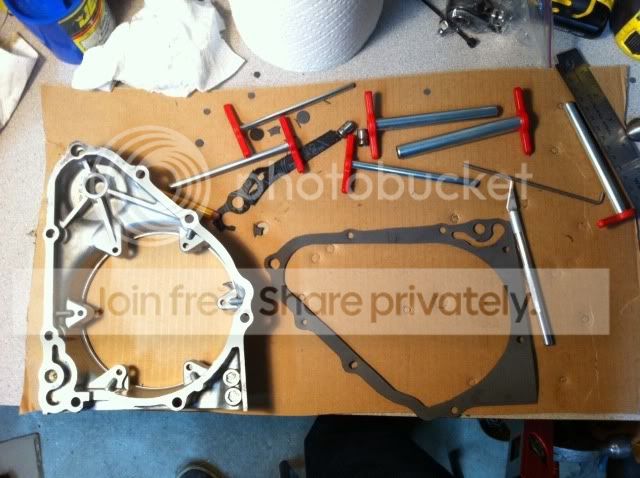

My first try at making gaskets. They came out awesome, and it was only $5 for the roll of material.
