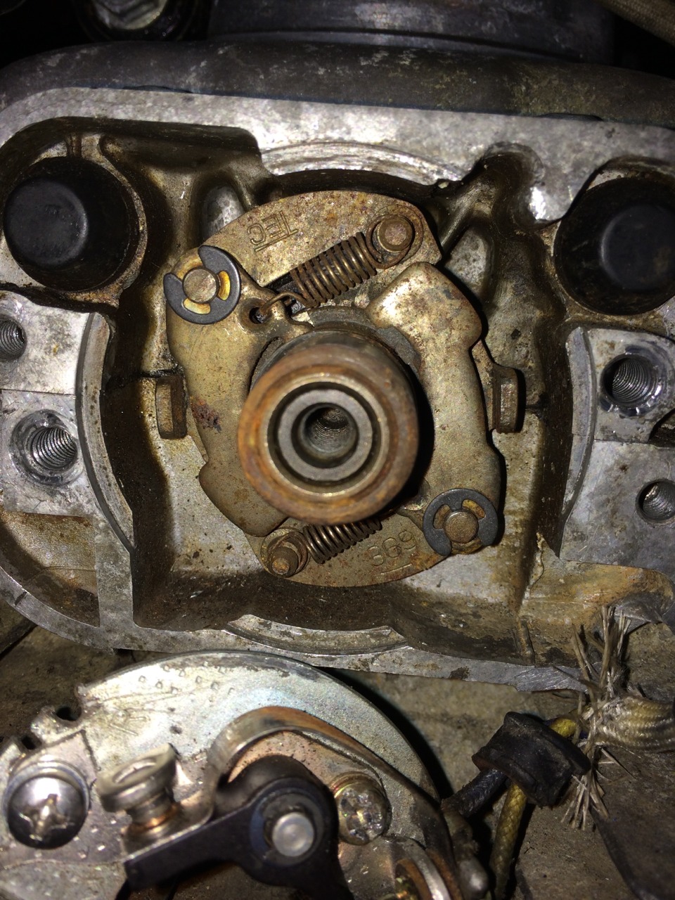

on a related note for the big brains, how can you tell if your advancer is 180 out?

You say it seems like the timing is 180 deg out? Shouldn't hear a loud bang unless that spark fired on an open exhaust valve. If you have the timing set correctly, there's only two things I know that can do that.
Coils are are hooked up backwards. This can be in the wiring under the tank you can have the wires in the points housing going to wrong points.
The next one is the one that gets most everyone, the cam on the end of the advance unit is 180 deg out. People take them apart clean them and put them back together wrong. That DOT you are talking about on the end of the cam needs to face the arrow side of the advance unit.
If you have got all that figured then just ignore this post.
You know what...now that you mention the advancing unit that makes the most sense to me. The timing is not 180 degrees out, i've made sure of this by making sure its on compression stroke(mentioning timing off the points). The wires are correct coming from the points/condenser/coils, theirs only 2 colors? 3 colors? Blue, Yellow, Black/white stripe for coils, so thats an easy mistake but I'm somewhat familiar with how it's suppose to be setup. I swear that wiring harness is imprinted in my head after dealing with this bike and it's really simple when you think about it. I've even had a buddy of mine go over the wiring incase I missed something.
So the dot on the end of the camshaft facing the arrow side of the advance unit. This is something I didnt even check ! ??? I've been so caught up on the timing/fuel/ wiring i didnt even consider it...

Sorry for making another post but I have one more question.
If i were to take off the points plate and snap a quick picture of it would you be able to tell if it's 180 off? Or would I need to take it off and find some reference point.
What i'm getting at is I can make a quick stop to my buddys garage before I head out and snap a quick picture of it and upload it to see what were dealing with.
Yup I'll be around, I've made that same mistake, figured I would at least mention it.
Okay so unfortunately this is all i could snap before work.
Pleasee tell me this is fucked up ::)
Thanks for helping me out with all of this btw
