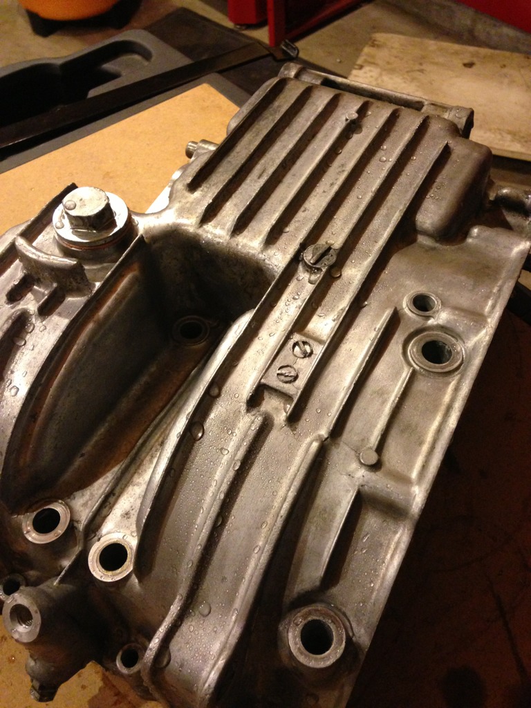

Basement cleanup on the lower case tonight. Two dips in the degreaser and a nice pressure washer bath does wonders.

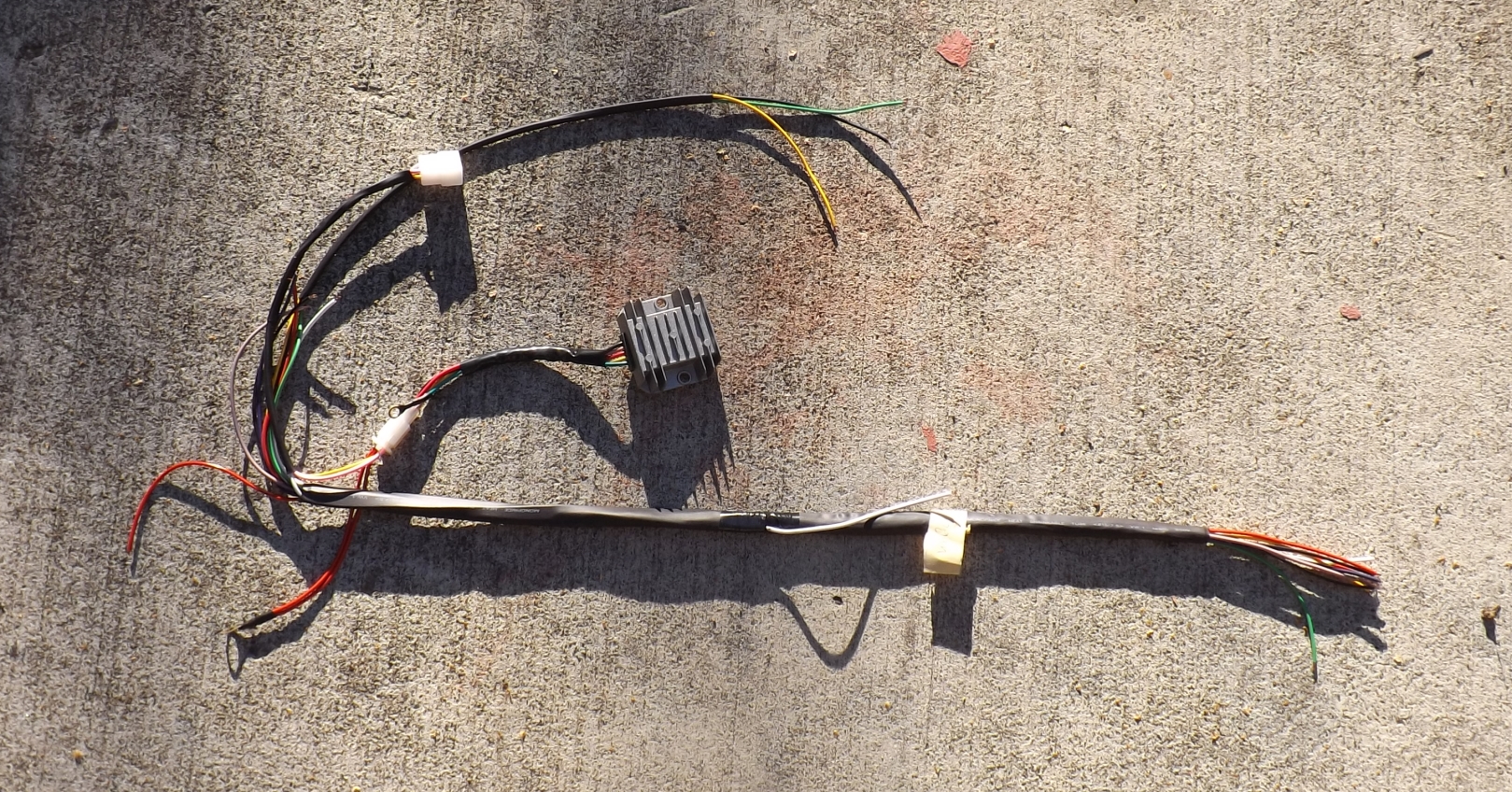

Harness in progress!
