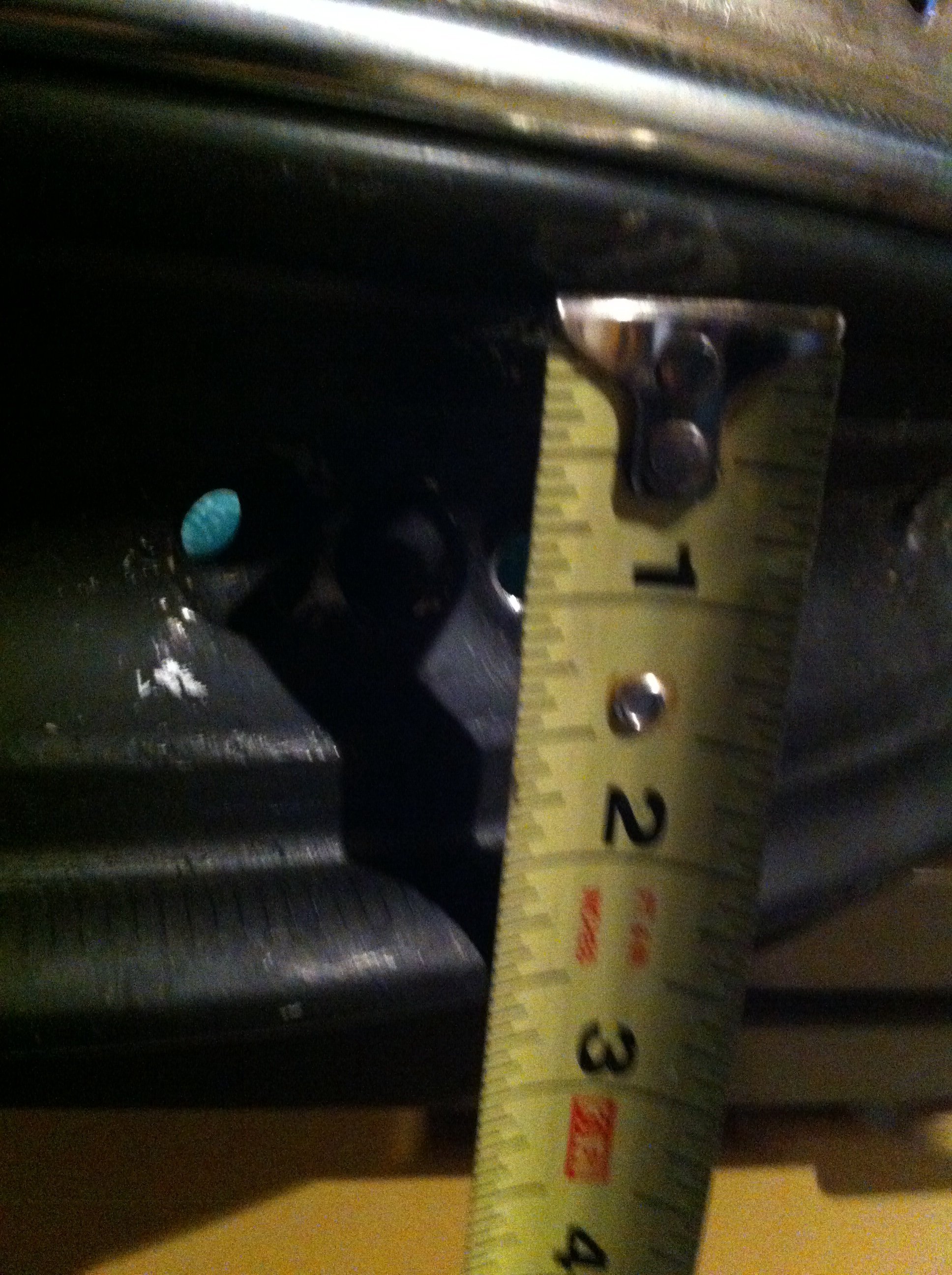

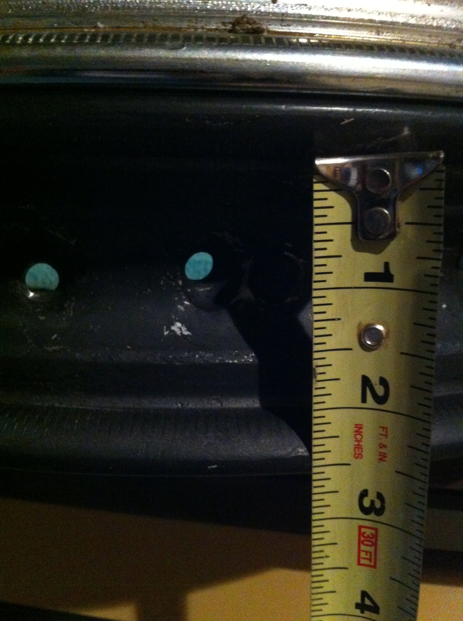

Yes the tire I took off says 3.50-18 and the new tire says 4.00s18 4p.r. The bike is a 1975 honda xl250 the rim is off a 1975 xl175 I'm building a cafe.
measure the rim between the inner edges where the tire seats it will be either 1.85 or 2.15"

Avon has a good resource for recommended rim sizes relative to tire size. The minimum recommended rim size for a 100mm wide (4 inch) tire is 2.15.
