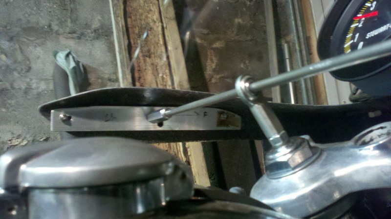

Here is a quick stand I made for my 175 with the motobits rearsets. I did see one in use before. So its not an original idea.
Also an idea for a upper fairing cross-member swivel.
