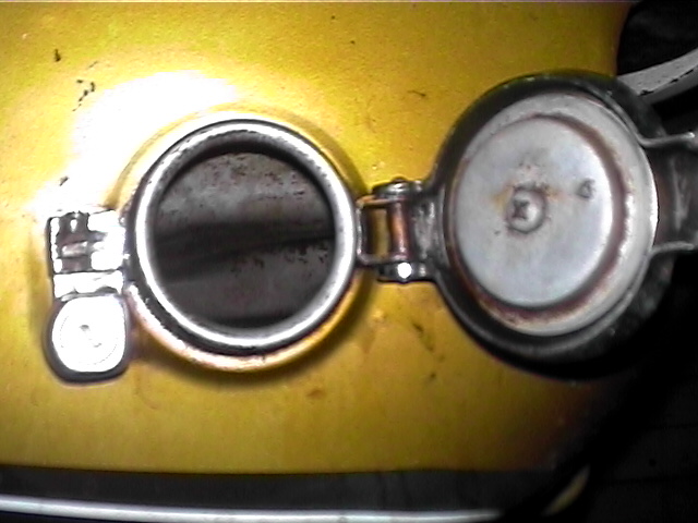

I recently read here or on another site of a way to clean rust from within a gas tank for $30.00 and does not require coating. It is very simple to the point of being unbelievable but it WORKS!!!! First buy a large box of 1" long sheetrock screws, $20.00. Then buy 4 gal's of white vinegar from the grocery store, $10.00. Then simply insert all the sheetrock screws into the tank, close the cap and shake the hell out of it by hand. I shook it on and off for a day. Every time I walked past it I would shake it. This process knocks off all the loose rust within the tank. I removed the screws. Then simply filled the talk to the brim with vinegar and closed the cap. I let it set for two days. I then poured out all but approx. 1/2 gallon of vinegar. I then added the sheetrock screws again and shook the hell out of it again. Removed the screws again and refilled the tank with the same used vinegar. Let it set another day. Drained the vinegar out and flushed the tank out with a water hose. After flushing it out, I immediately pourd gas into the tank and sloshed it around good to evoraprate the water left in the tank and to keep it from flash rusting. It was that simple. It took it down to bare matal......... Mine looked so good after that I didn't even have to Kreem it inside. Wish I'd have taken before pics.......................

Hi ben, I think that the screws are vital to a good outcome. They seem to break up all the loose rust scale in the tank to allow the vinegar to do a better job. I have done it both ways, with and without the screws. The best outcome is achieved WITH the screws. Here is a pic of the huge pile of finely powered rust dust that came out when I emptyed the screws out..................The other pic is a tank I am currently soaking with vinegar. I will post the after pic when its done..........

I see your point there.I haven't had any really bad tanks to do but I am about to start on two.They are so thin in spots that I can push holes through the side with my thumb nail.I hope I can save them.Lets keep the back and forth going on this.I have a feeling I am about to learn something. ;)

I posted an after pic, on this page, located several post back, of the tank I was cleaning out with vinegar. It really works!!!!!!!!!!!! Check out the before and after pics....................
