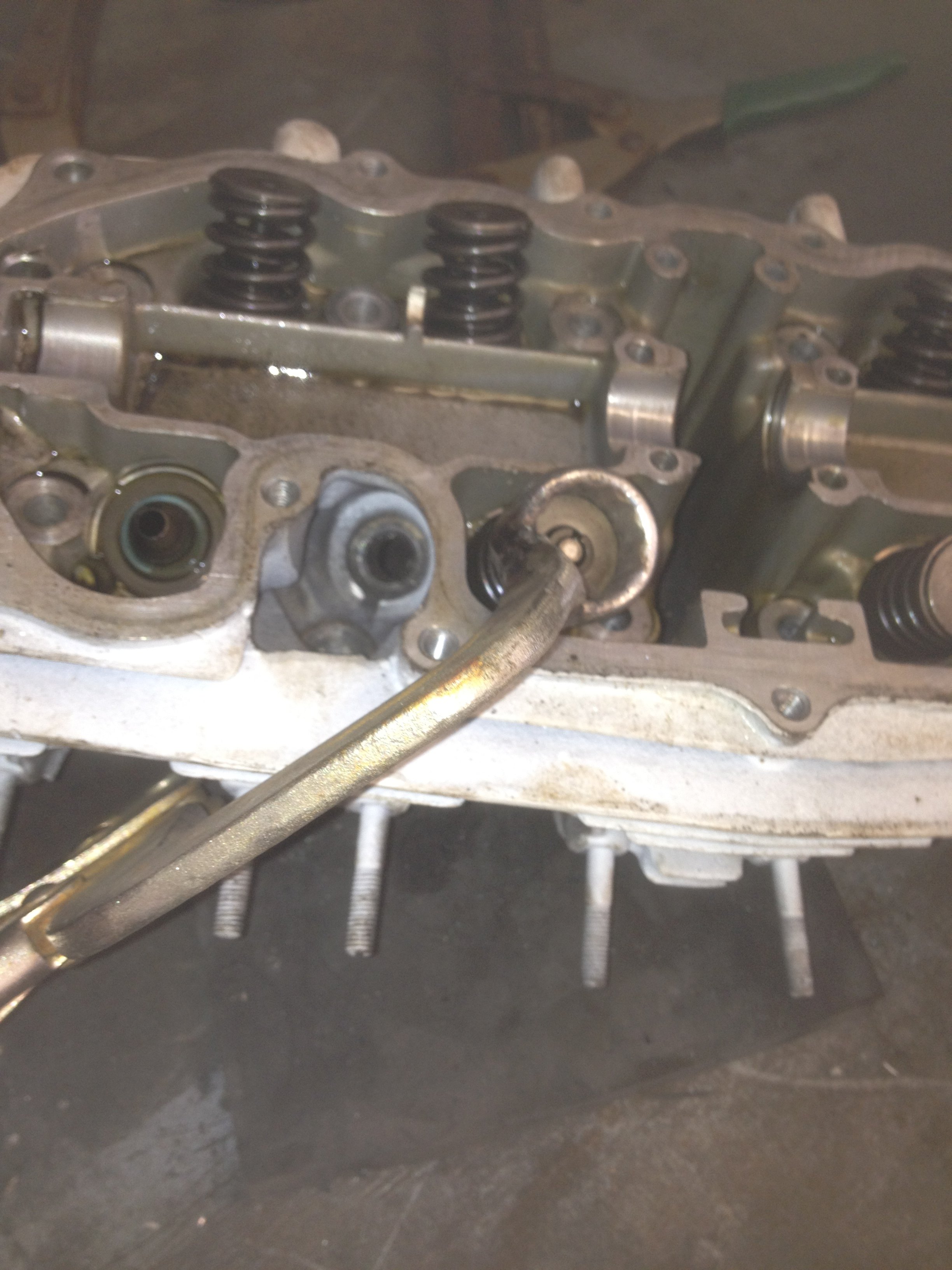

Ok, dont know if it has been done before(haven't read all 71 pages), but this is a quick and simple valve spring compressor for the cost of a spanner and a set of C clamp locking pliers I had laying around the shed.
I cut the ring head of a 25/32 spanner (who uses that size? ???) and welded it onto the C clamp making sure that when the pliers are in the closed possy that the spanner head is square to the other end of the clamp and there it is, a locking clamp that holds springs down securely while you pop out the collets with a magnetic screwdriver (or your fingers if they are that dainty).
Took me about eight minutes to remove all collets and springs and more importantly will only take that long to reinstall without flying collets and springs all over the shed floor
The best part is it is a one handed operation so you can use the other to take the pics :P ;D
Ok here it is locked in position with the little suckers just waiting to be plucked out ;)
