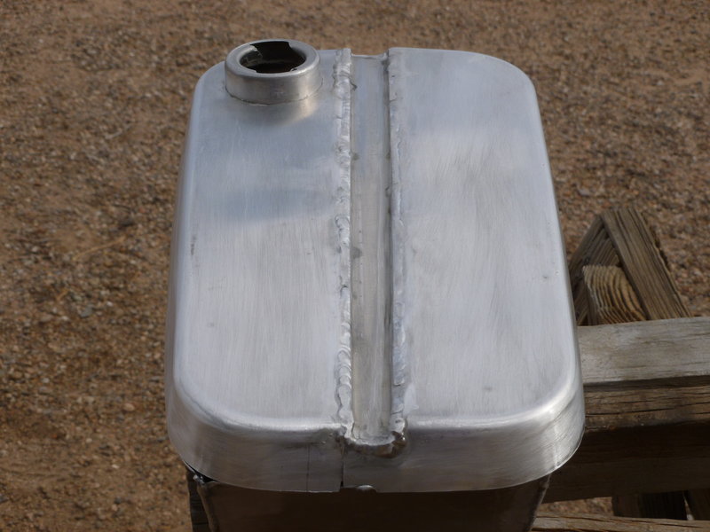

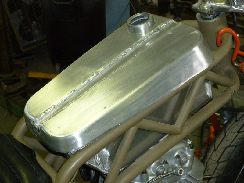

OK here's some pictures of the tank that Pop's is fabbing up for the chassis...

Whats the capacity (approx) on that tank?..Looks great. Looks like you could make an even larger tank by going higher and extending the range....
That tank is pretty.
