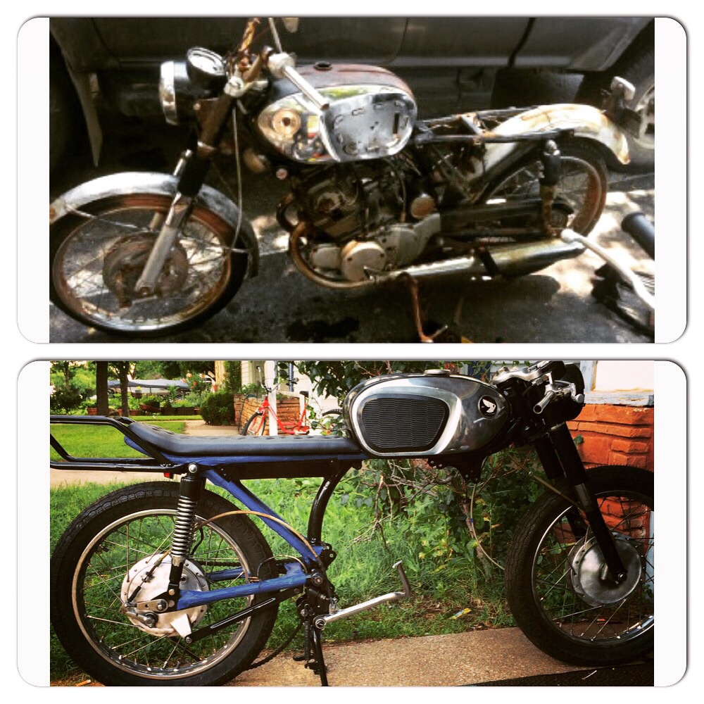

Before and "later" pics of the bikes

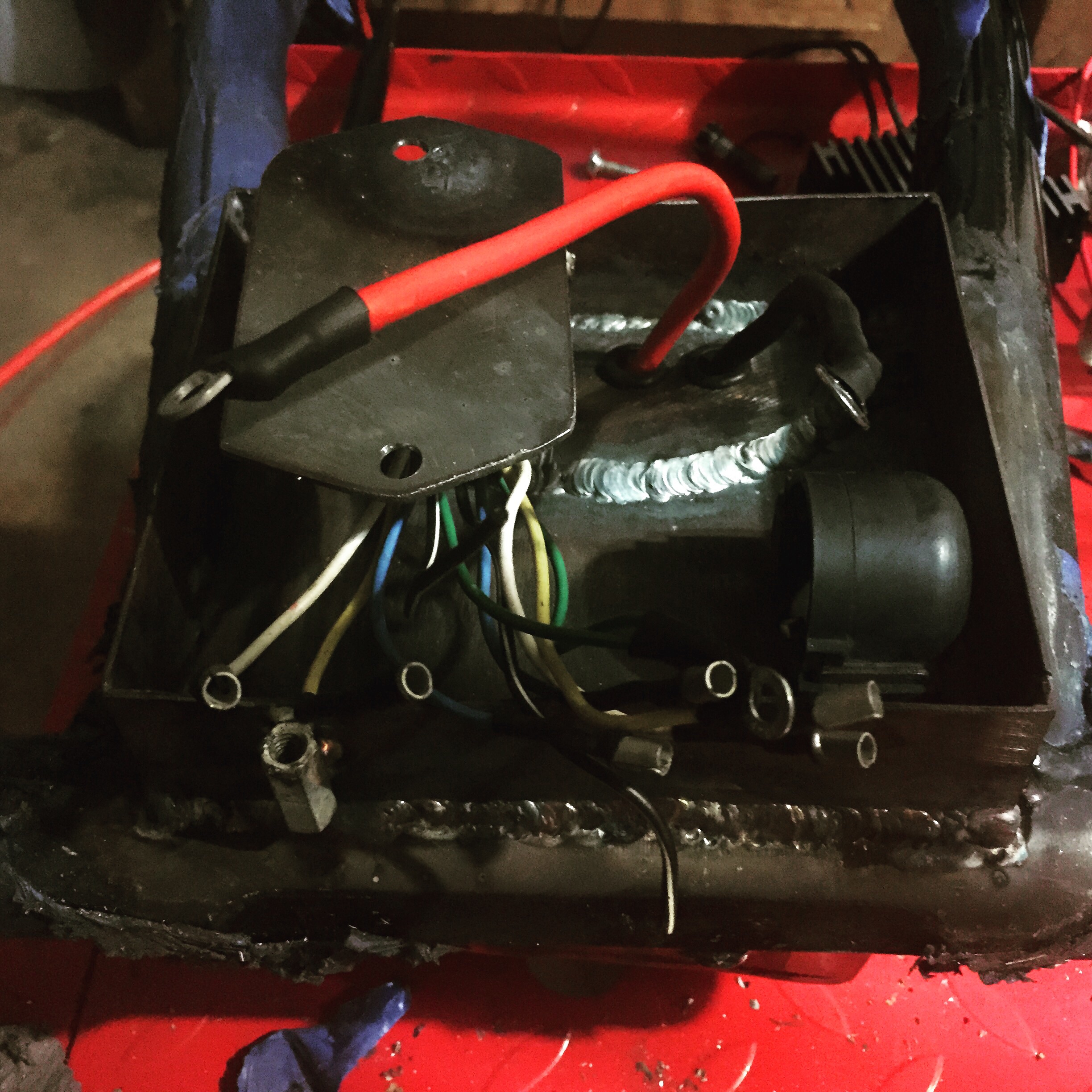

Cb750 electronics box. This was allot of work. Left the reg rec out in hopes that it would stay cooler

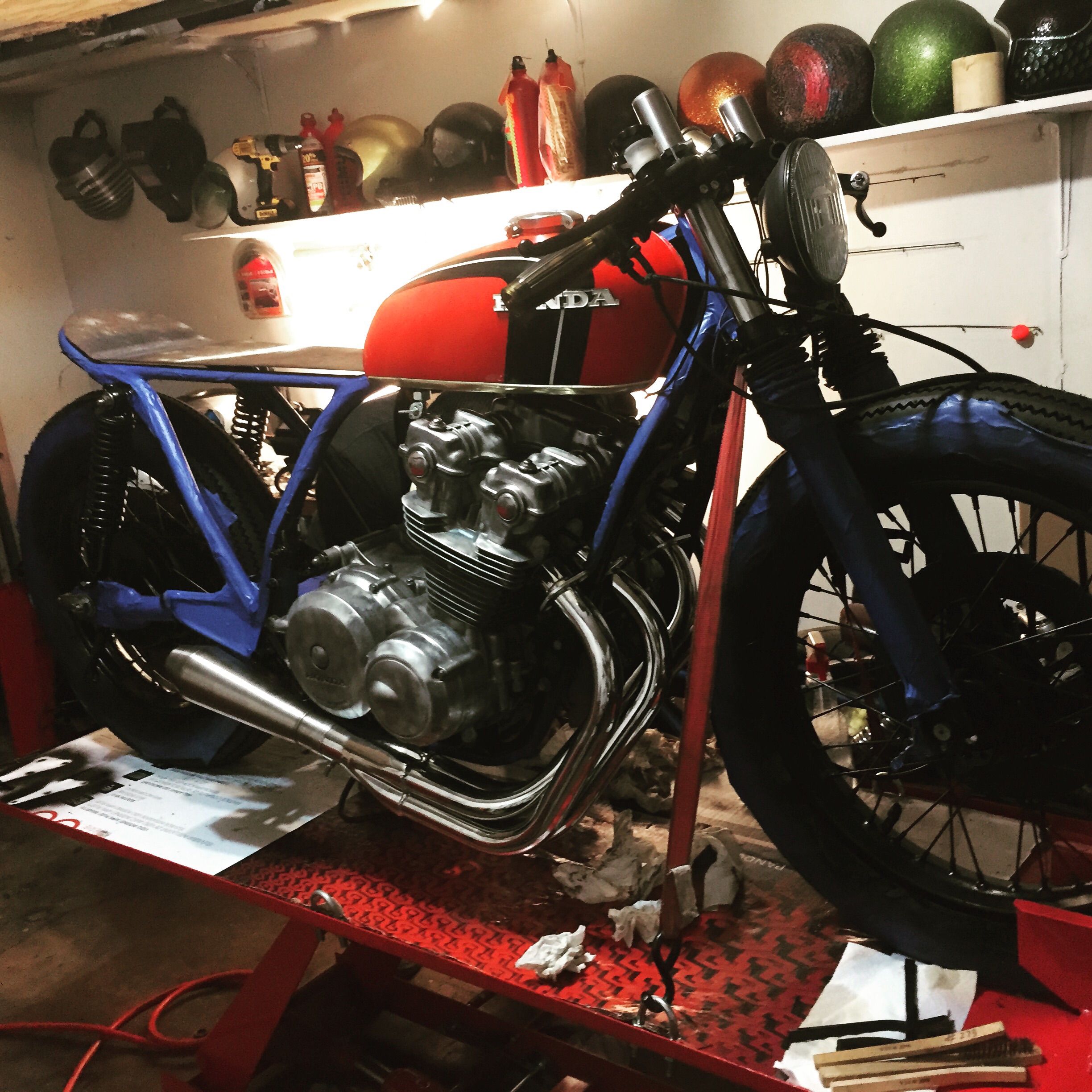

Carbs on. These things are a breeze to tune and work great with pods. Try it at home
