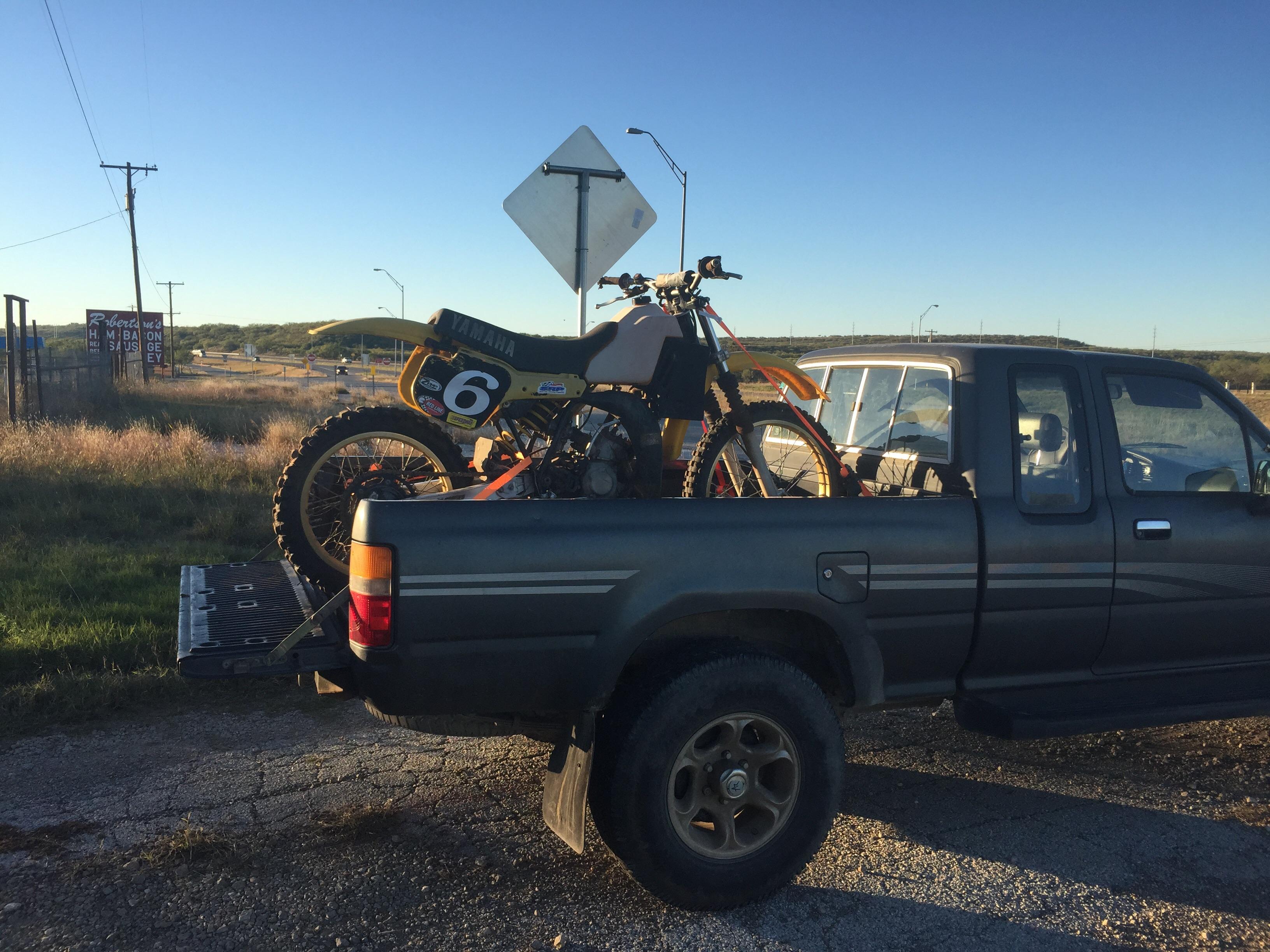

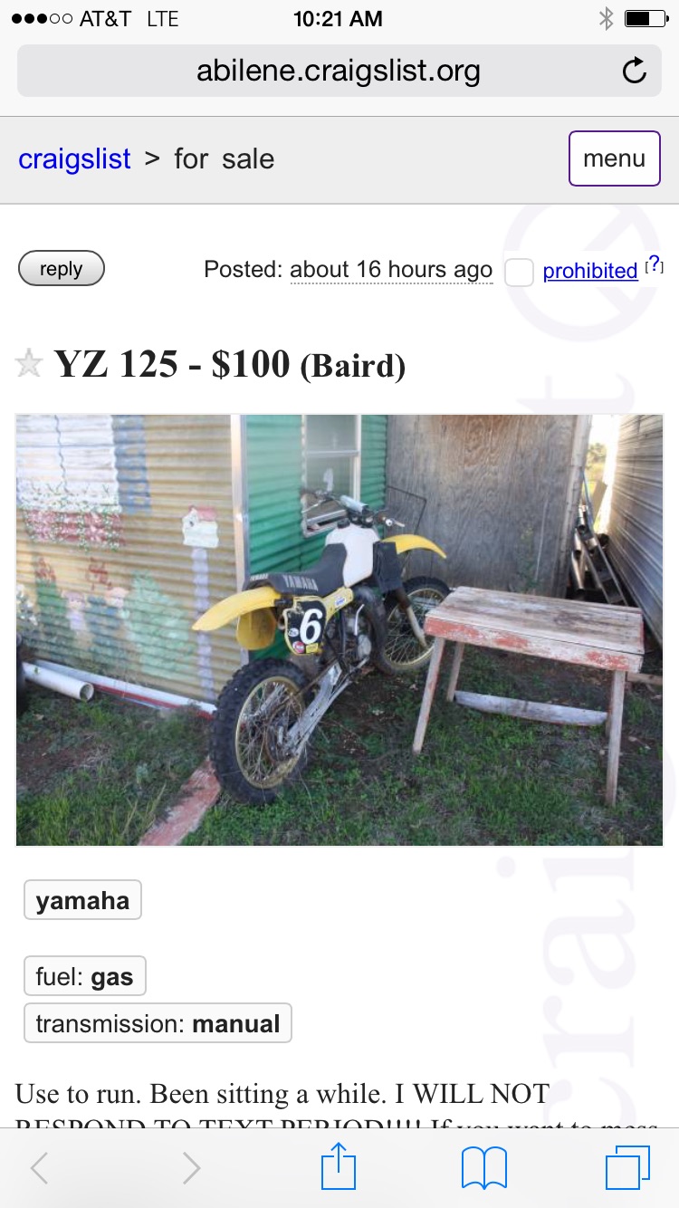

Oh yea and I nabbed another craigslist bike. This one was 100$ and the dude I bought it from was a nice old man who promised me it ran when he parked it ( which is what everybody says right ) so I put some gas and oil in it kicked it about 30 times and it freaking started.
It was gonna be just a diner for my cb400 scrambler project but now it seems a shame to take the mutabo to it, but that's prob how it will end up after I ride the piss outta it

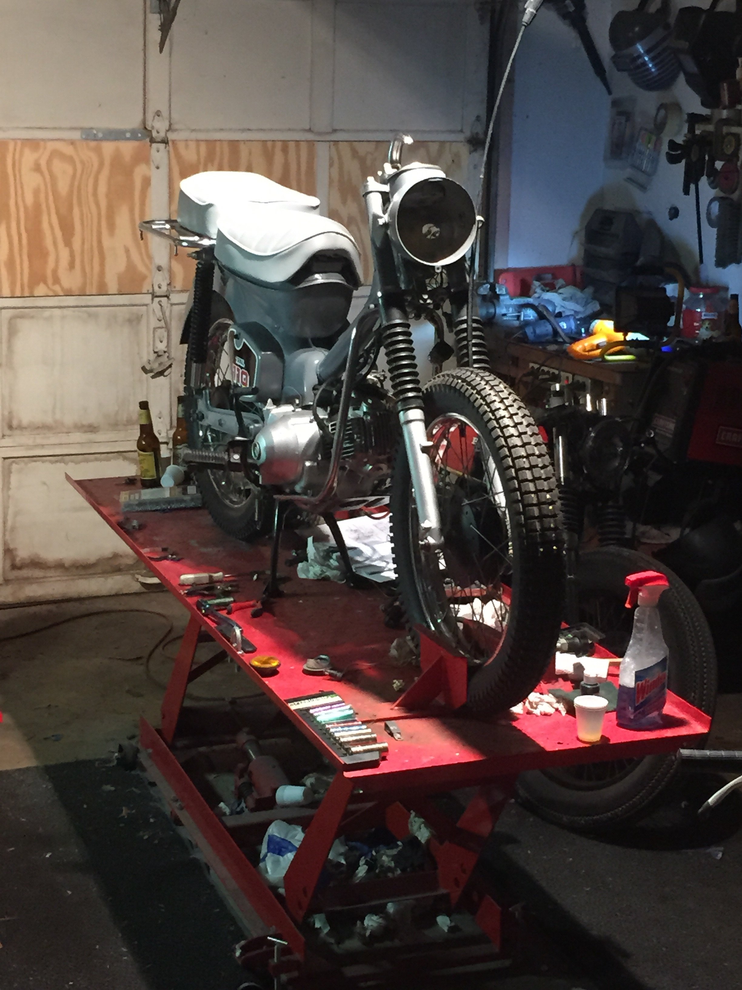

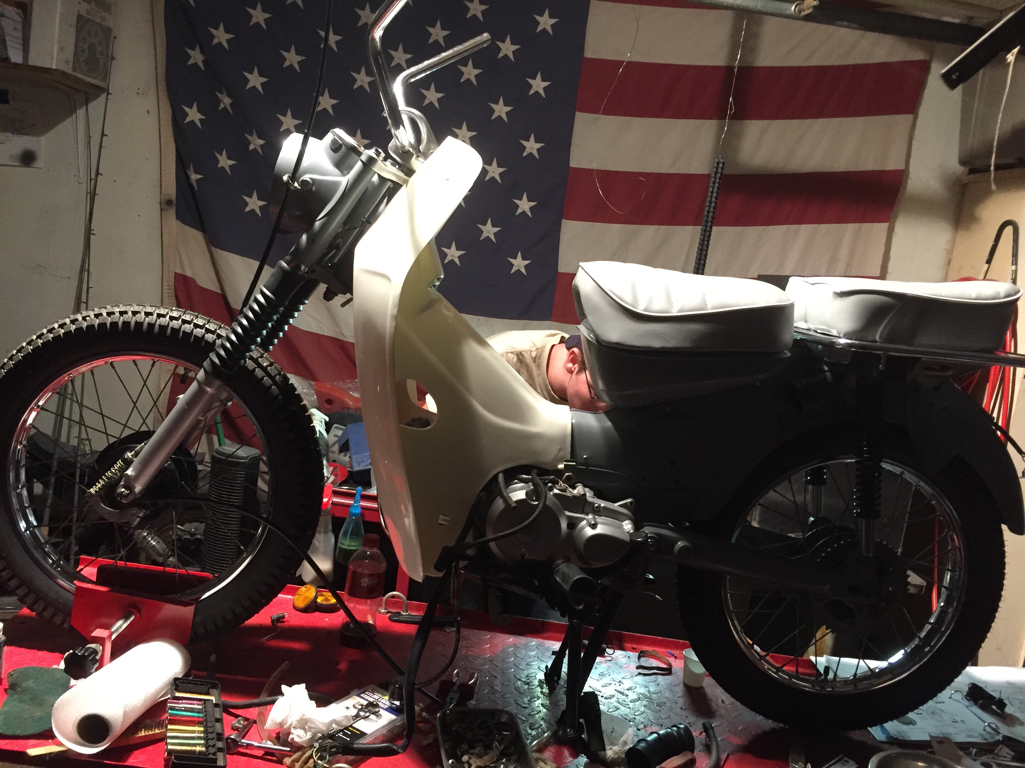

Well I'm sure I skipped a lot of steps and the bike isn't 100% squared away but it's in the mid 60's here and supposed to be in the 70's next week so had to get the 110 off the lift for tue night bike night
Here she is
