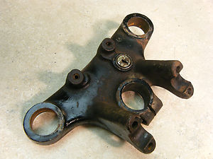

Picked this up last week to get clearance for my handlebars against the "new" tank.
B44 top triple yoke... should be the same forks as my A65 as they were both '67s so an easy swap. The handle bar mounts are farther forward and just holes in the yoke instead of cast in risers. With these I not only get my clearance I need but can later decide clip-ons or standard style, be it clubmans or Normans "M" bars.
index.php
Compare my new one above from the B44 Victor to the original A65 unit below...
