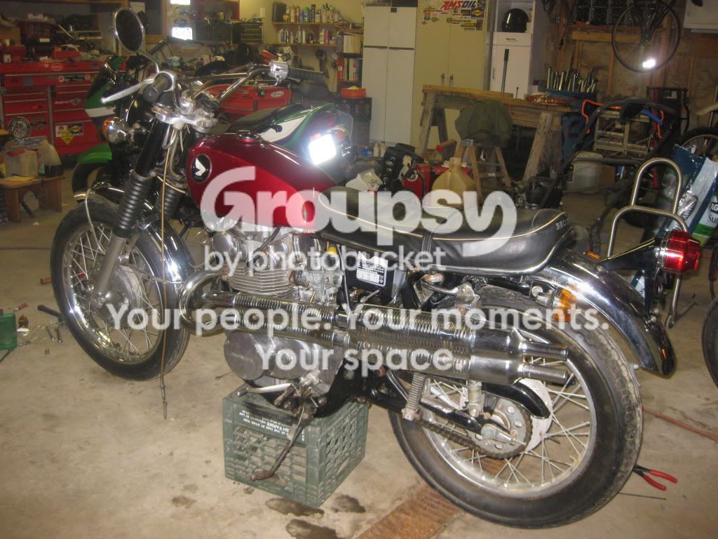

This is what it looked like before I dented the tank, bent the bars, broke a signal lens, and parked it for the winter. It's not wearing the side covers in these pics, but they look good--match the tank.
And, yeah, I know the Honda wings are on backwards. I didn't put them on that way, and I don't plan on changing them anytime soon. I have bigger fish to fry. Last year, I replaced the neck bearings with an Allballs kit, installed a new battery, new plugs, large K&N filters, rebuilt the carbs, set the points, and replaced the voltage regulator with a later model unit. More to come.

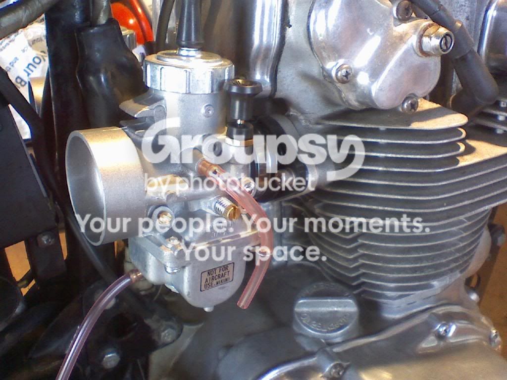

Bought the Powerbarn Mikuni setup:

The Mikunis really woke up this bike, and everything in the kit worked pretty well, but as I said, the cable assembly is a bit tricky until you learn the exact right way to cut through the cable, the exact amount of force to use when crimping the ferrules, etc. Once the bike was running though, it didn't take long to realize that the high/hanging idle issue from last summer had carried over.
At this point, I have to mention that this issue has seemingly more varying diagnoses online than just about anything I've encountered on a motorcycle. Float level, synching, tired mechanical advance springs, valve adjustments, worn out rubber/plastic carb pieces, kinked fuel lines (causing lean condition), and mixture screws are all offered as possibilities. The thing is, if the 45-year-old stock carbs are set aside in favor of a brand-new set of properly synched Mikunis, many of those reasons go out the window. The thing I kept coming back to was the mechanical advance. When dealing with the issue last summer, we decided to cut a coil off of one of the springs, and that seemed to do the trick...for a while.
When the issue returned after sitting through the winter, I figured I would trim the other spring down to tighten things up again, and if that changed things, then look online for a new set of springs. Well, it did make a difference, temporarily. I'm thinking the more I cut off, the faster they're fatiguing. However the second part of the plan didn't really work out. It turns out that it's easier to play Pick Up Sticks with your butt cheeks than to find new mechanical advance parts for the bike.
Long story--short ending: PAMCO electronic ignition with e-advance is on the way. I bit the bullet. I'm sick of chasing ghosts.
