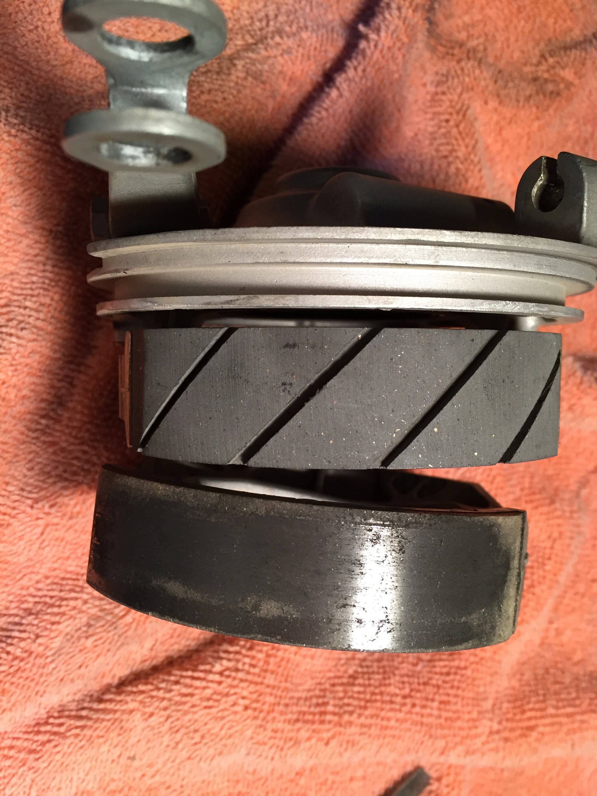

I had a conversation with Terry Miller (http://www.millervintagecycle.com/index.html) about better brake shoes. He recommended these from EBC
they are sintered metal and listed as rear shoes for an XL200. I got them from JC Motors in California they were $42 delivered for both sets. I'll fit them when we are back North md April and let you guys know how they are

fitted the sintered brake shoes today they are a perfect replacement.

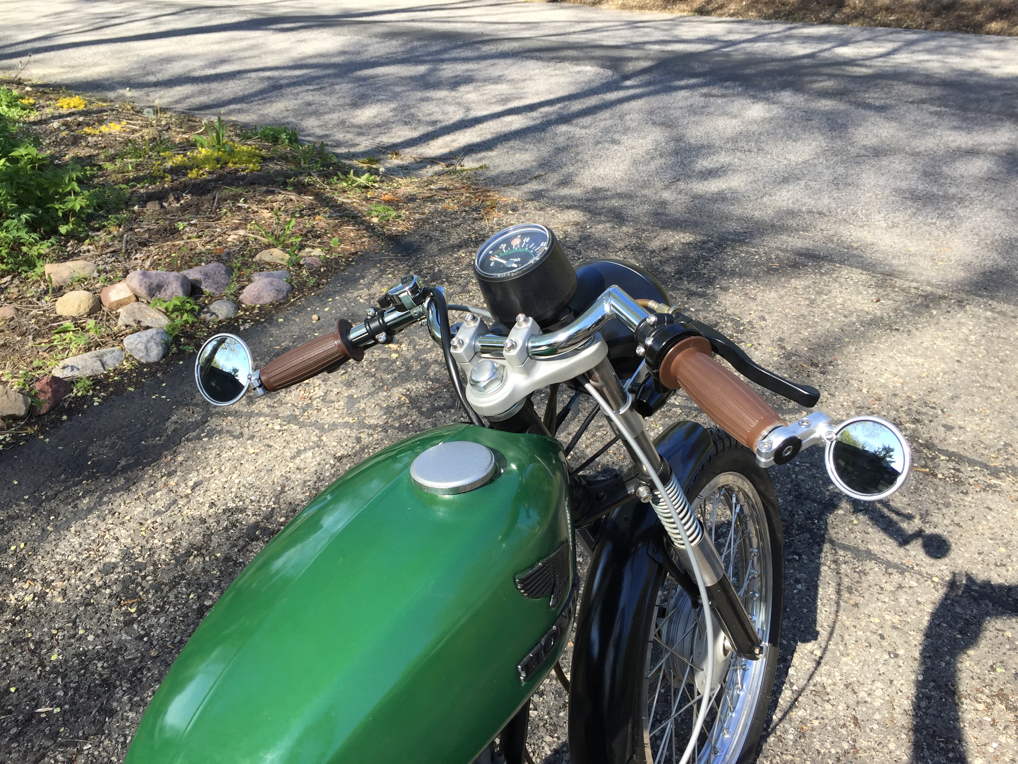

Made a change to the bars. I had originally planned on using these moped m bars but was concerned that they were too low. After riding with the renthals last fall it felt a little cramped. Took a longer ride with them today and they are really good. Also got a chance to test the new brake shoes. They are a definite upgrade! I have a short emgo lever on the brake and one it pulls up solidly with a two finger pull. I now feel safe in stop and go traffic which I didn't with the stock replacement shoes.
