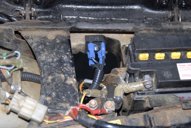

Here is what it looks like now, much, much cleaner. In the second picture that is the regulator right? How can I test the regulator?

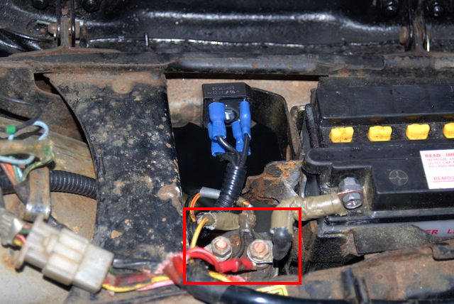

Also, can I just run a direct line from the battery to the rectifier and delete the starter solenoid? I don't even have a starter on the bike. Just to confirm this is the solenoid for the starter?

My carbs don't have vacuum ports, so I don't think I can use gauges on it. I mounted the rectifier with rubber washers so there is not contact. I don't think I needed to but I did just in case.
