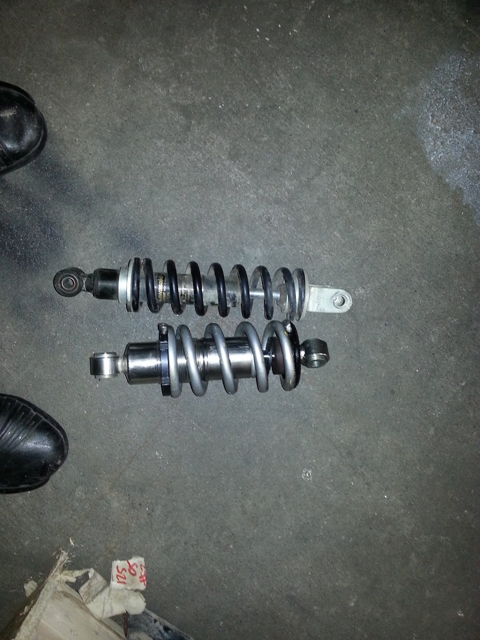

After first kid and 5 months later...I get a minute to work on the mono again. I've decided the shock was too heavy after 400 or so miles. My wife confirmed :) as she is back on two wheels as well!
Trying a slightly "smaller" shock from an EX 250 Ninja. I figured it is similar in weight to my CB500 and should be a little more forgiving on my back. The only problem is that it's several inches longer.
I mocked it up in there by making one side to the bottom plate and drilling another hole in the top. It makes the bike stand quite a bit higher, which is a little bit of a bummer. So I'm going to see if there's any room to move the top mount forward and down slightly to make up for that extra Inch or so that I would like to move the tail end down a bit. That's all for now.
Critique welcome of course. ::) :P ;)

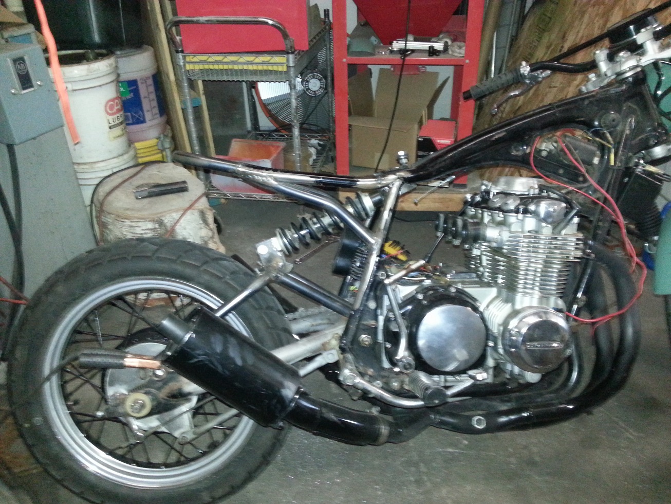

Re: 71' CB500 monoshock with no name.
Forgot to update, so here we are! Finished a few things up and she rolled over 1000 miles since I finished the main phase of her transformation. My wife was nice enough to sew a seat for me (well it is HER bike afterall...) I need some more foam and to shape it a little more to my liking, but here she goes. We just went on a ride recently and she did 3+ hours of riding on it :) Thanks for everyone's input, it's been a fun ride and I'm calling it "done" for now. Might add something to the tank, but this is pretty much it! ;D 8)
