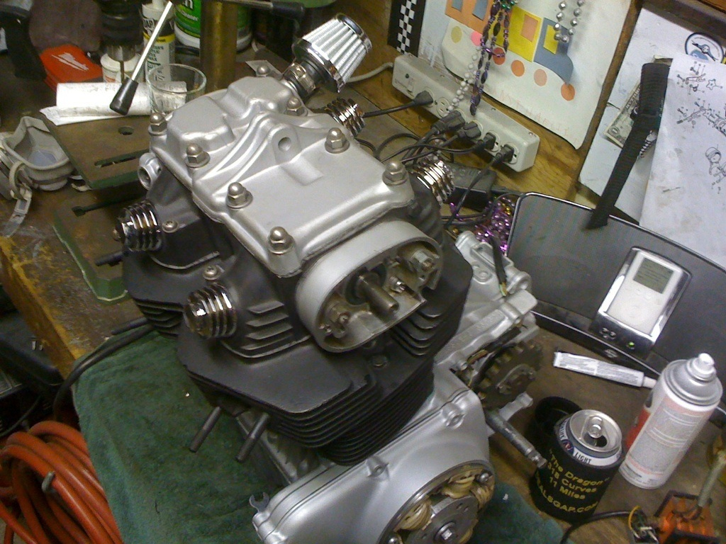

Dang! That sure is a perdy motor.

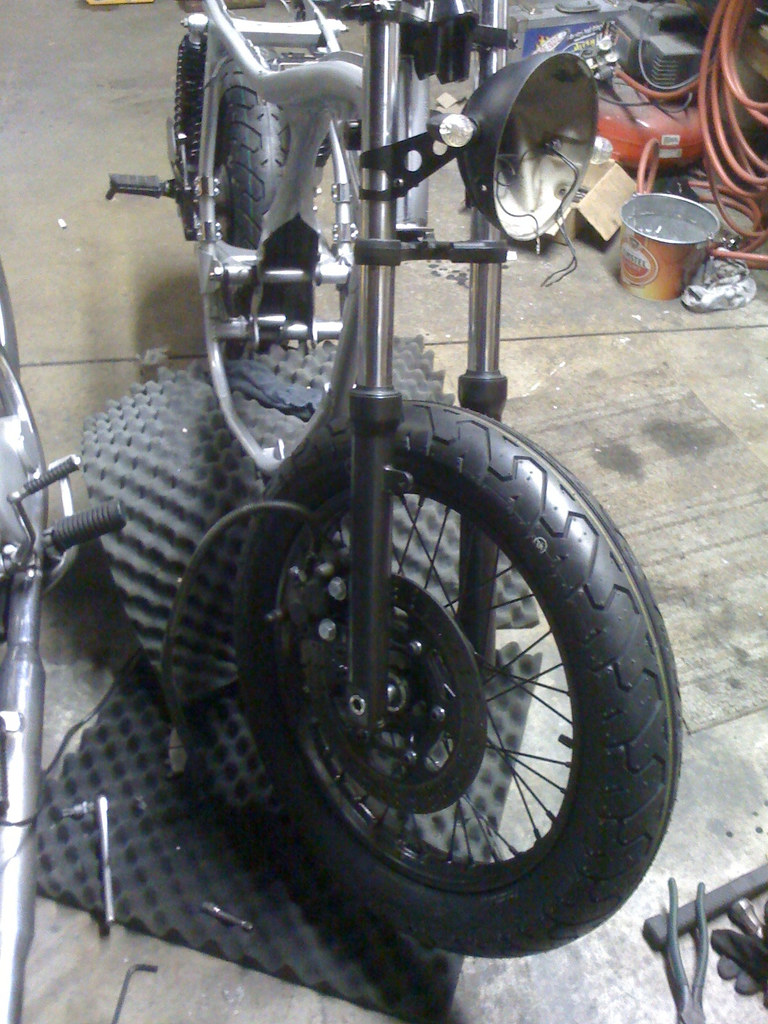

W00t! Front wheel and brake are on. I just blows my mind how versatile these bikes are. This front set up is such a hodge podge of parts but it works beautifully. I had to make the receiver for the speedo drive out of parts from the original CB360 one and a new receiver for the EX500. Amazingly it worked great. I also had to grind the rivets off of the 360 rotor and replace it with the proper rotor for the EX500 caliper. Again to great success. Very good night in the garage last night. I should have dropped the motor in but the Jameson was flowing in celebration and I figured it'd be wise to wait until tonight.
