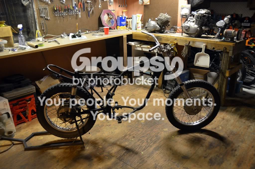

Discovered the forks are tweaked. They're square with the frame in this shot...look at the tire. Yikes. Anybody have a spare set of '69-'71 TS250 forks laying around? Or rather, just the left one...

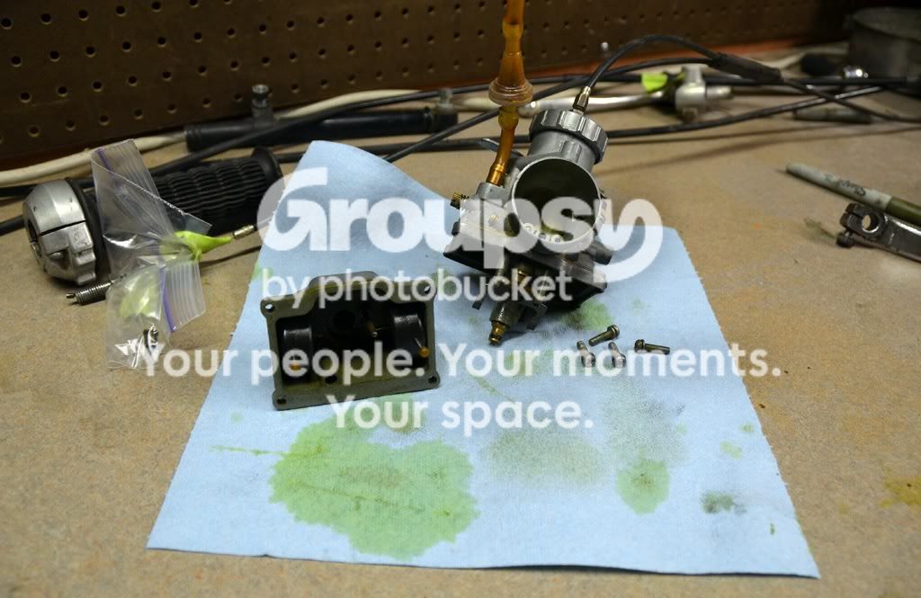

The gas in the float bowl was NEON green. The PO thought the bike wasn't running due to a "blown seal." Based on how he thought the bike was a '69 (it's a 71!), I'm going to wager he had no idea why it wasn't running. Fouled carb maybe?!? We'll see...
And since I watched The Big Lebowski recently, it was white Russian night in the shop. My brother helped me strip the bike, and needless to say, by the time we were finished we were pretty hammered. Him a little more so ;D but he does look happy with his bike, no?
