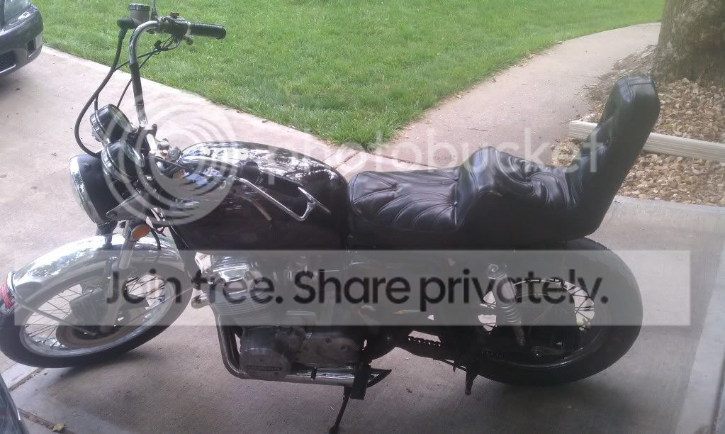

First thing to go was the seat. Pulled that off and ordered this gem which should get here hopefully this week and if not, then early next week:
That seat comes unpainted, so when I repaint the bike it the bubble on the back will be the color of the bike, which I plan to make Ford's rio red color that I loved oh so much on a 94 Cobra I once owned.

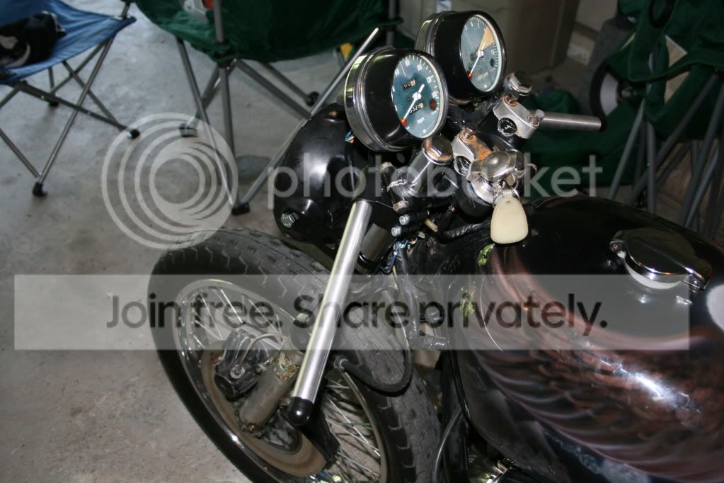

got my clip-ons in. mocked them up... now confirmed that ill need new brake lines (ill probably just get a whole new master cylinder from a new bike), as well as a clutch cable.
I think I'm going to try to keep the controls as clean as possible, and have as little wiring coming from the clip-ons as possible. I'll have no turn signals, and I'll put the headlight control/engine kill switch/electric ignition buttons on a switch panel that I'll mount to the original risers. I've got an engineer buddy who's going to draw the stuff up in solidworks, and we'll cut it on his CNC. Might even do a 2 tone etching style job to label things, but it should look neat.
Seat and rear cowl should be here by the end of the week, so I can mock that up too.
No pictures of the clip-ons mocked up... but here they are after I opened them:
Theyre woodcraft 3 piece clips. Even better in person than in the pictures.

Got the clip-on's on. Now I need to find a master brake cylinder that I like as well as a different clutch perch. I decided I'm going pretty modern with the look of the controls. Ill have no engine start, horn, turns, or hi/low beam switch on the bars, but rather on a switch panel just below the guages. I'll completely get rid of the turn signals, as I dont need those.
The seat also came in. Here's a crappy cell phone picture to give an idea how it sits.
That seat quality is amazing. It took about 2 weeks from the time I ordered it, to the time I got it... but it was a made to order thing. I order the seat, they lay the glass, upholster it, and send it out. The seat is just amazing... can't wait to paint the hump.

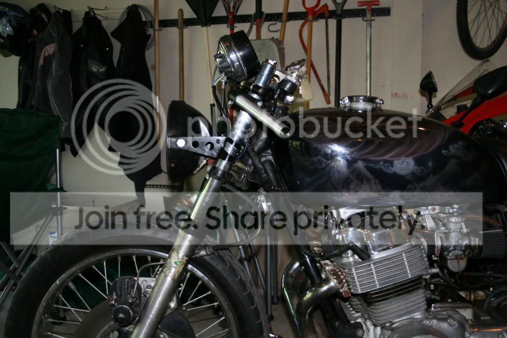

Headlight ears came in today. Got delayed in heading out to get my throttle assembly and clutch perch/lever/cable until tomorrow. Hopefully I can go grab that stuff tomorrow and stop by a local shop to pick out some grips for it. These are the ears, not sure if I'll mount them the way I'm holding them, or upside down. I'll mock it up both ways.
mock up (headlight isnt in the bucket)

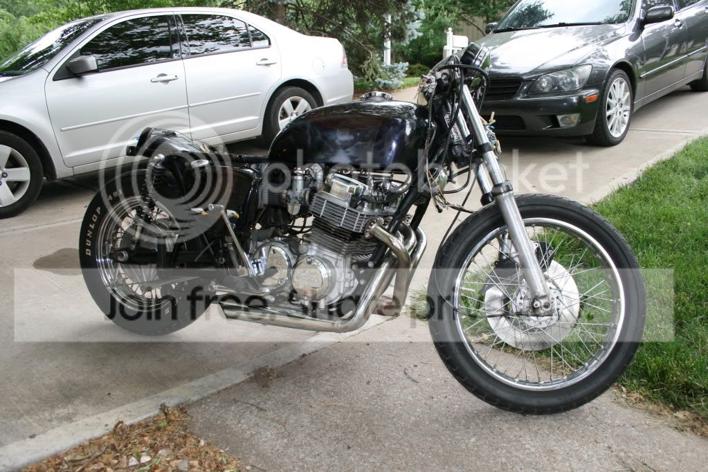

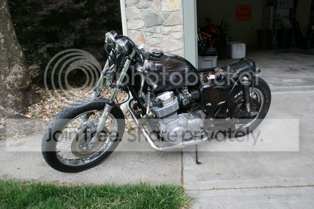

Soo... been a little busy. Didnt get to update the thread much, but at this point the bike is rideable. Paint will come shortly as well as a few other odds and ends to clean things up. What a blast to ride!!! Who knew these things were so much fun?? No wonder they have a cult following.
Here's a couple photo's :)

LOVE the paint
Love the look of the cross over exhaust ! Gives it a mean 'don't mess around with me' attitude!
I agree with the front fender, I just chopped mine down a little bit, but it does act as a brace, and you do not want those forks wandering around, even at slow speeds.
Any color scheme in particular? How do those pipes sound?
