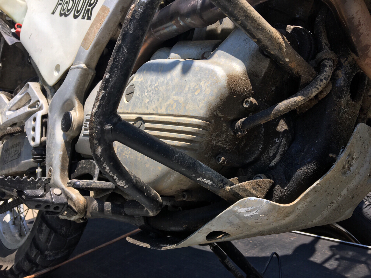

It wrecked me, but it did it’s job too...
