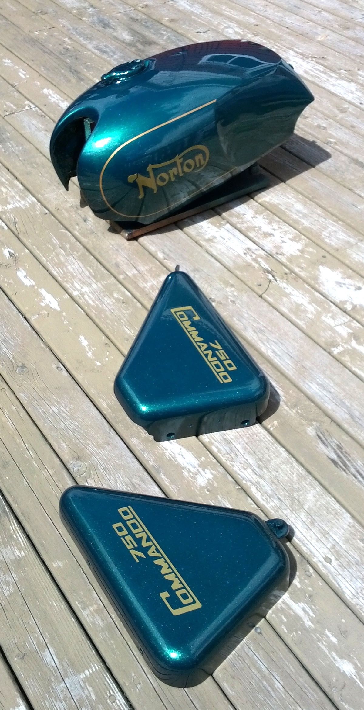

Finally got some time to put the stripes and lettering on the tank and side covers. Then a few days later the sun came out, so I pushed the other bikes outside and sprayed the clearcoat...I'm pretty pleased with the results. The owner was out the other night and I ran it up for him...he has the registration sorted out now, so all we are waiting for is a plate...and that may be along by the end of the week. Getting closer!!!
