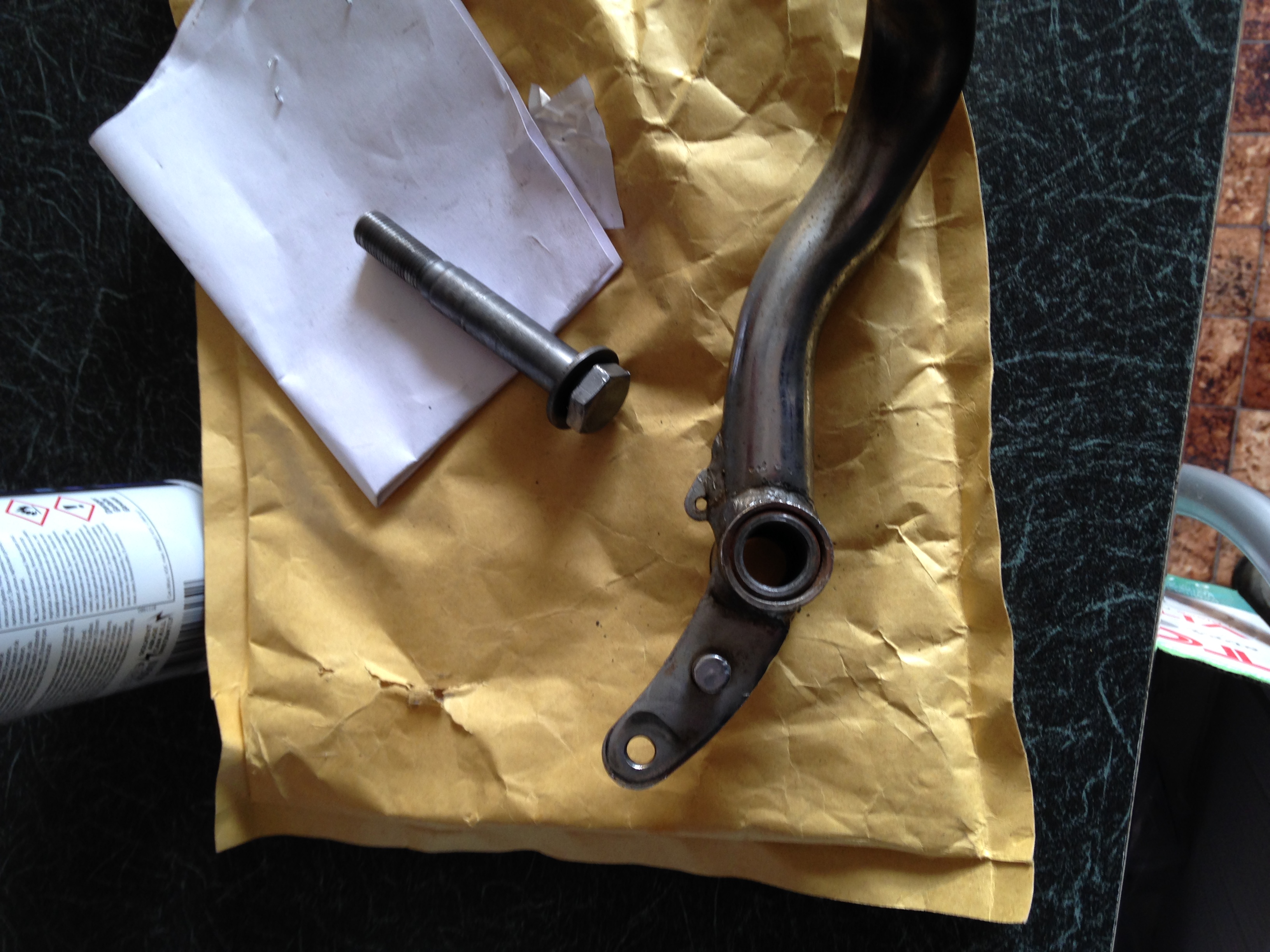

I 'think' I may have sourced a cl350 brake lever to modify so I can connect my rear sets properly. Going off of cmsnl, it looks like it will mount directly to k4 frame using the same mounting bolt.
Does anyone have the dimensions of the rear brake pivot bolt, or one lying around they don't need?

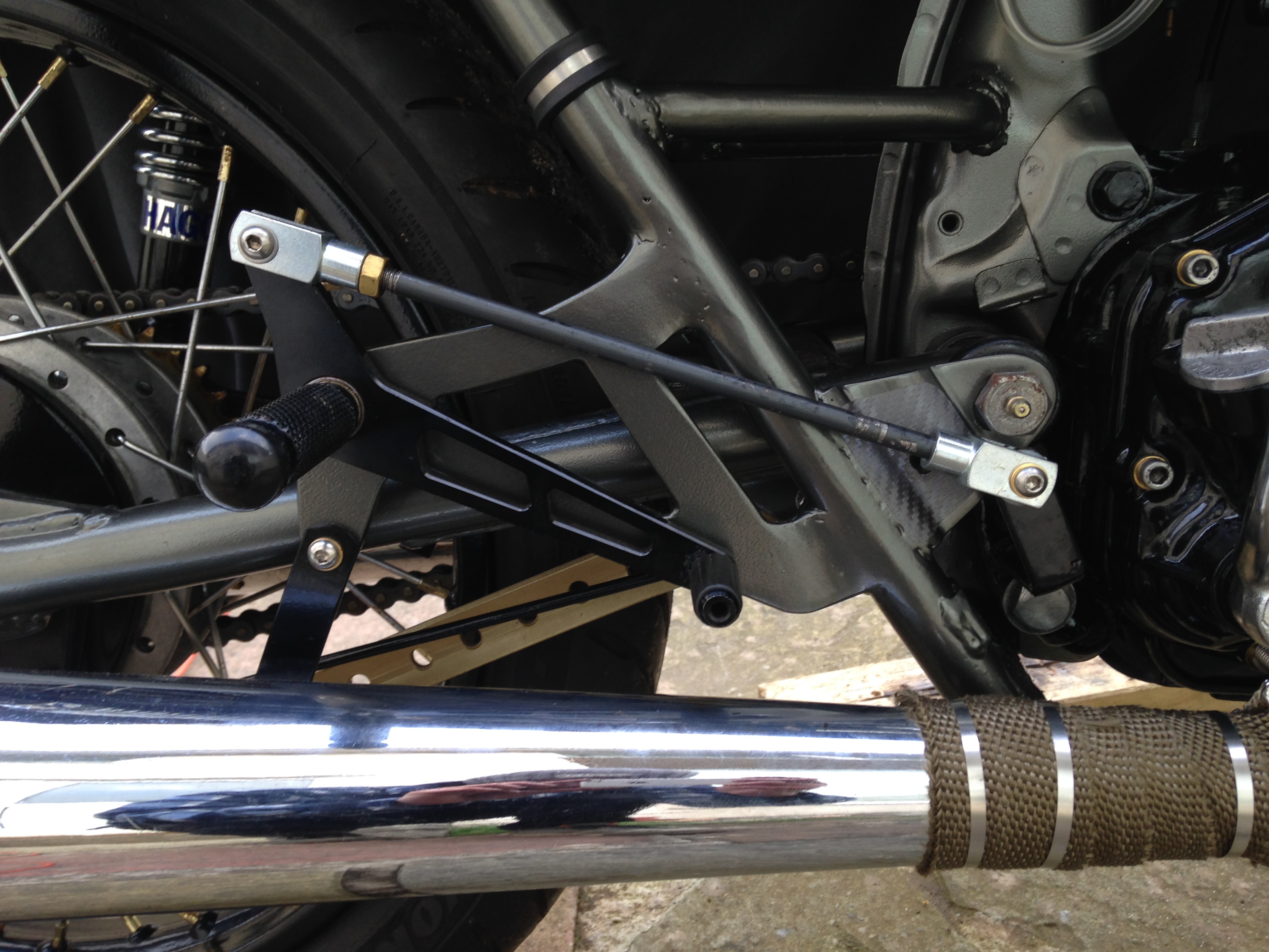

yeah I can picture the setup, but it will be cheaper and easier for me at the minute to go down the modified bell crank and mechanical linkage as it saves on fabrication and part sourcing.

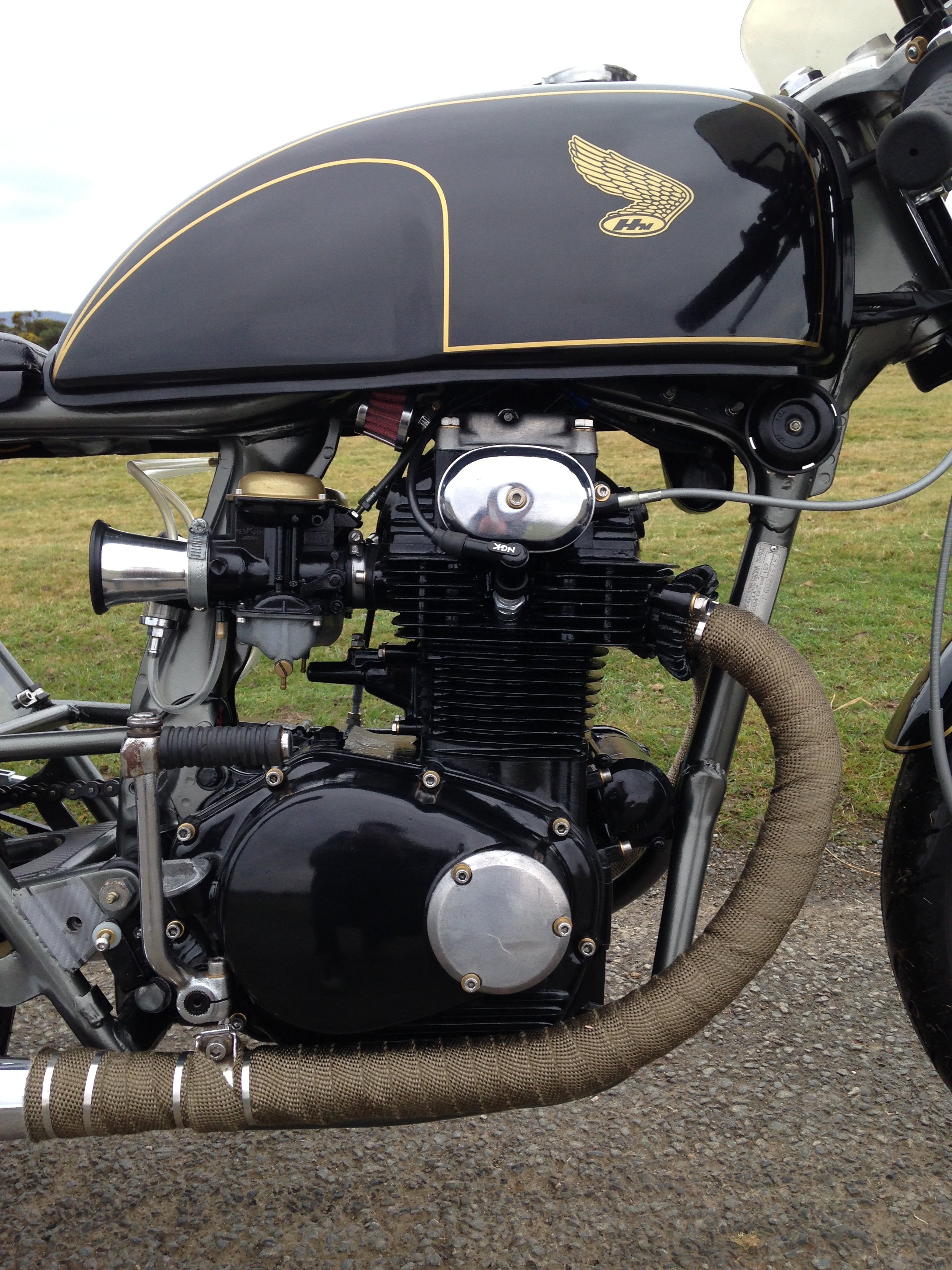

I also had to wrap my pipes because I couldn't clean up the rust spots. I prefer the unwrapped look but this will do for the time being and looks a bit cleaner I guess.

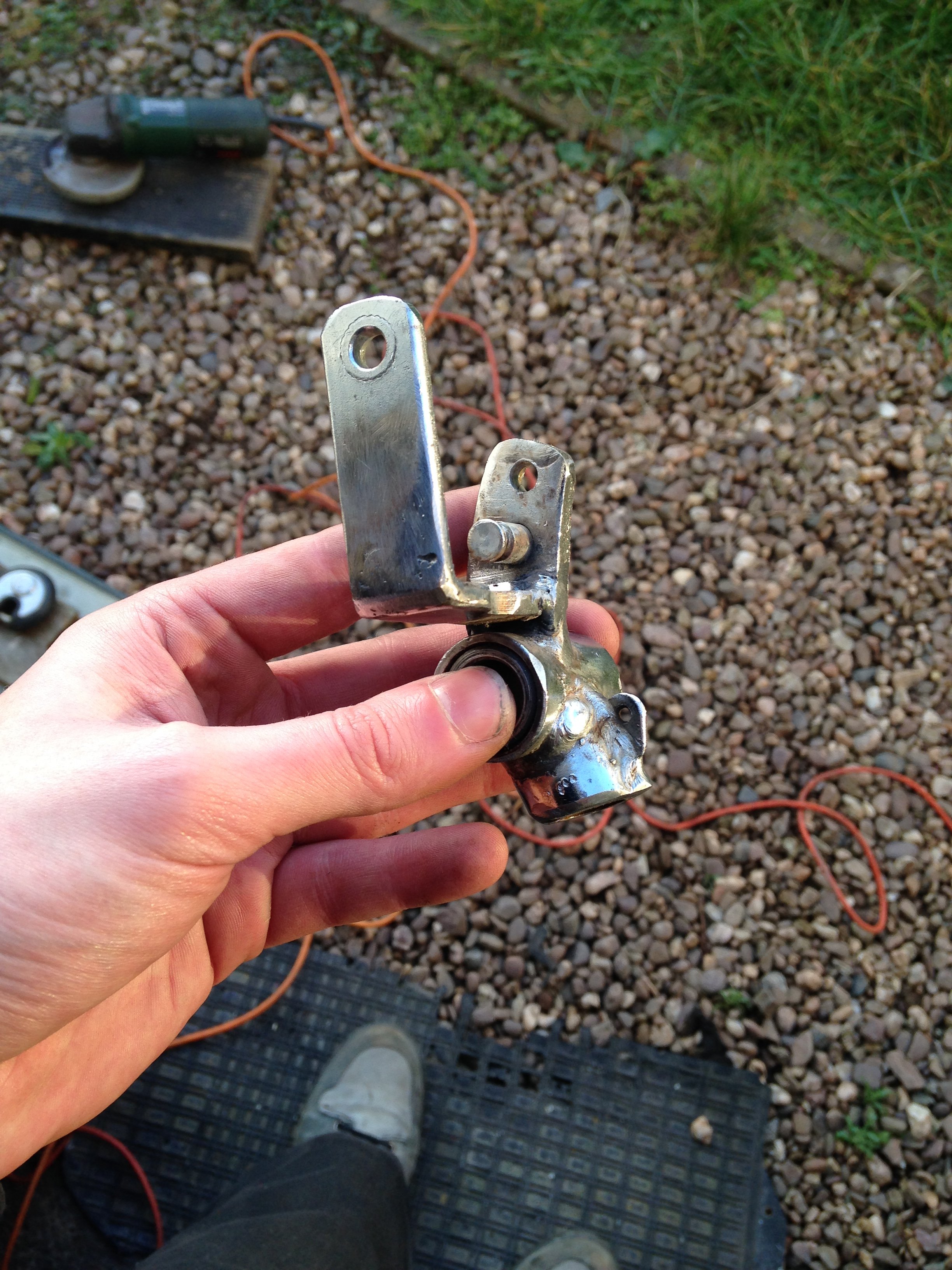

I got the eBay brake arm through and it looks in pretty good condition, so tomorrow I am going to make a start on the rear brake linkage and bellcrank. Also going to clean up and paint the fairing brackets.

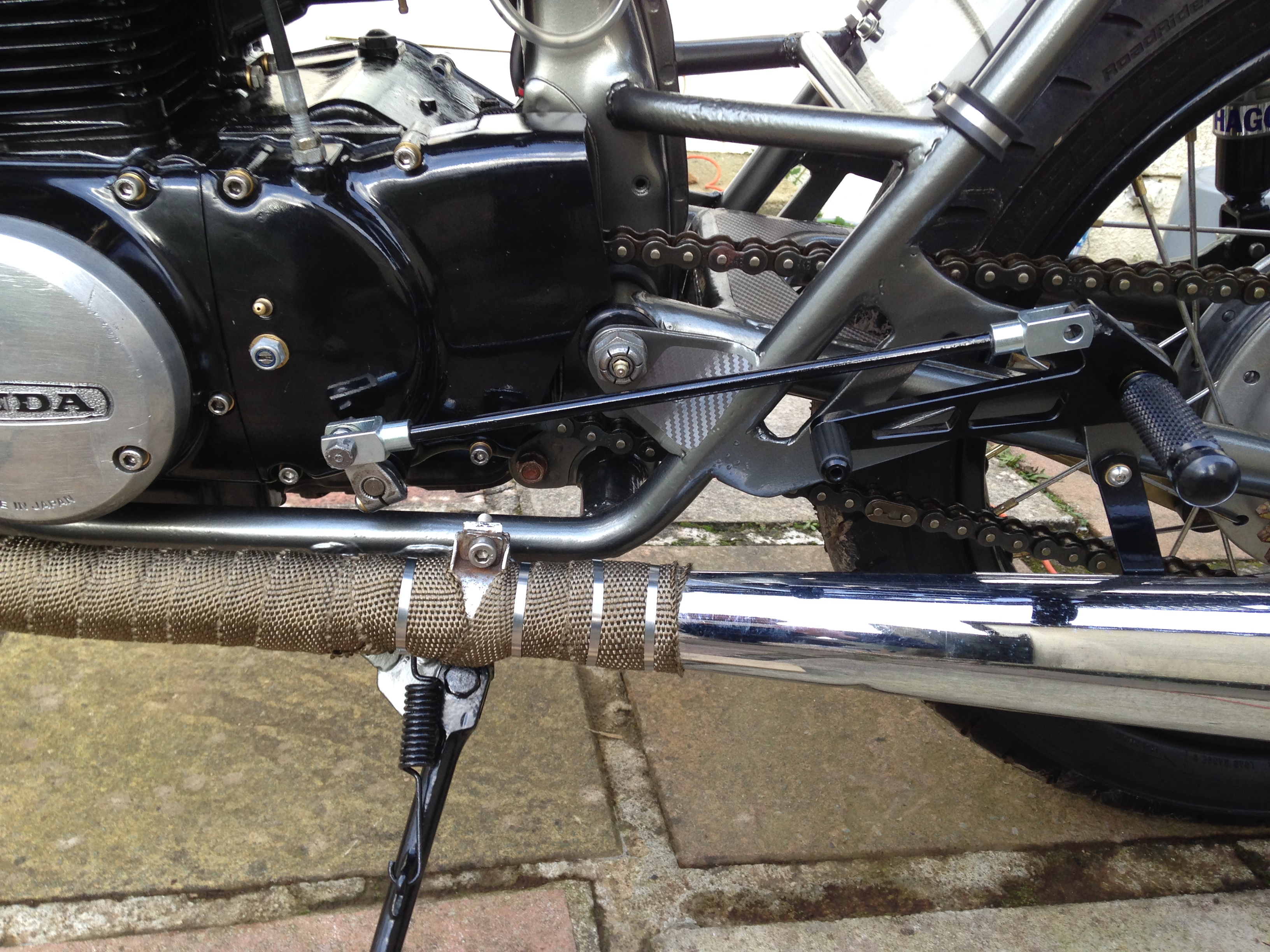

Modified, tidied up and painted the fairing brackets. They are drying over night so pictures will come tomorrow.

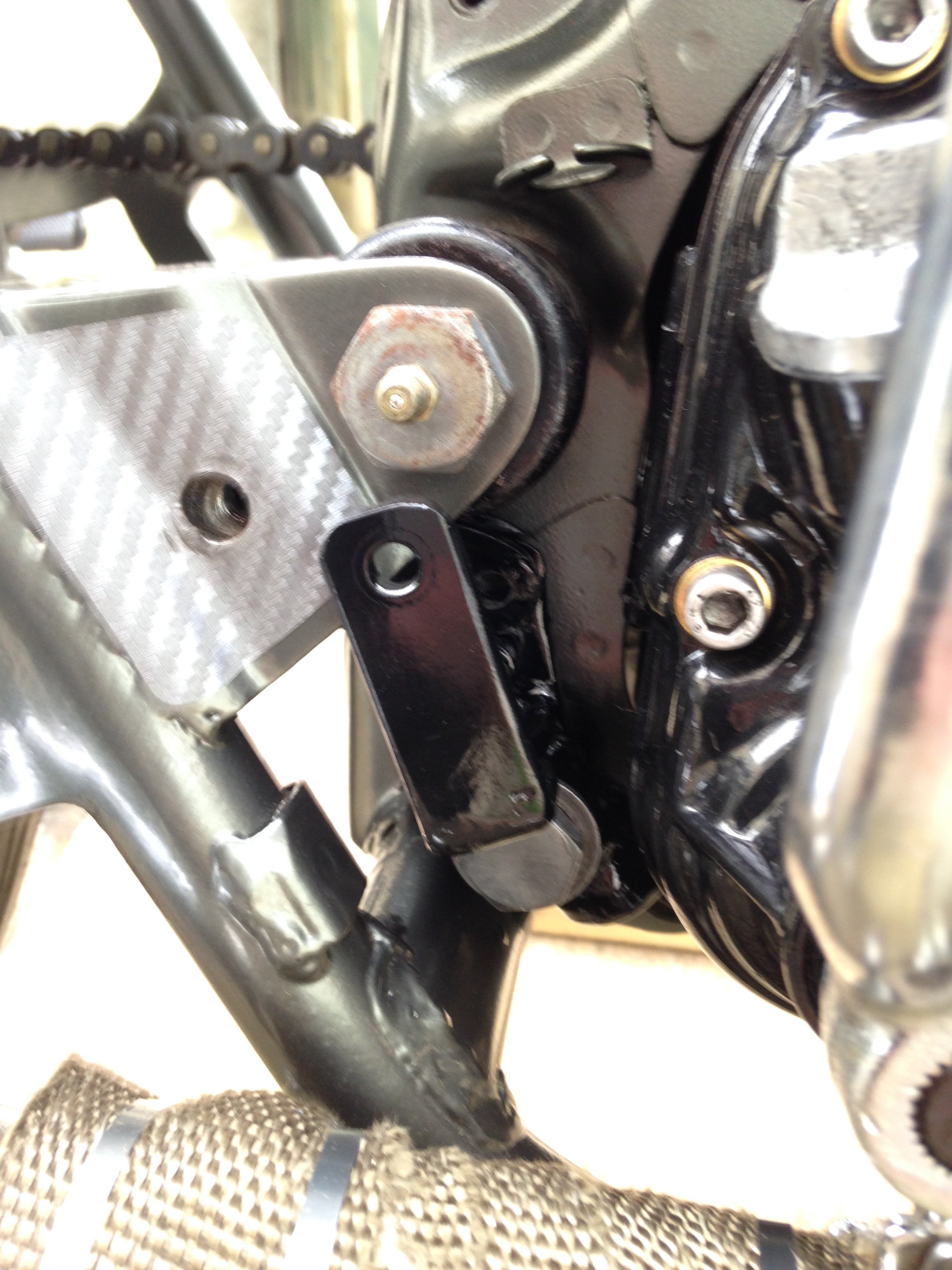

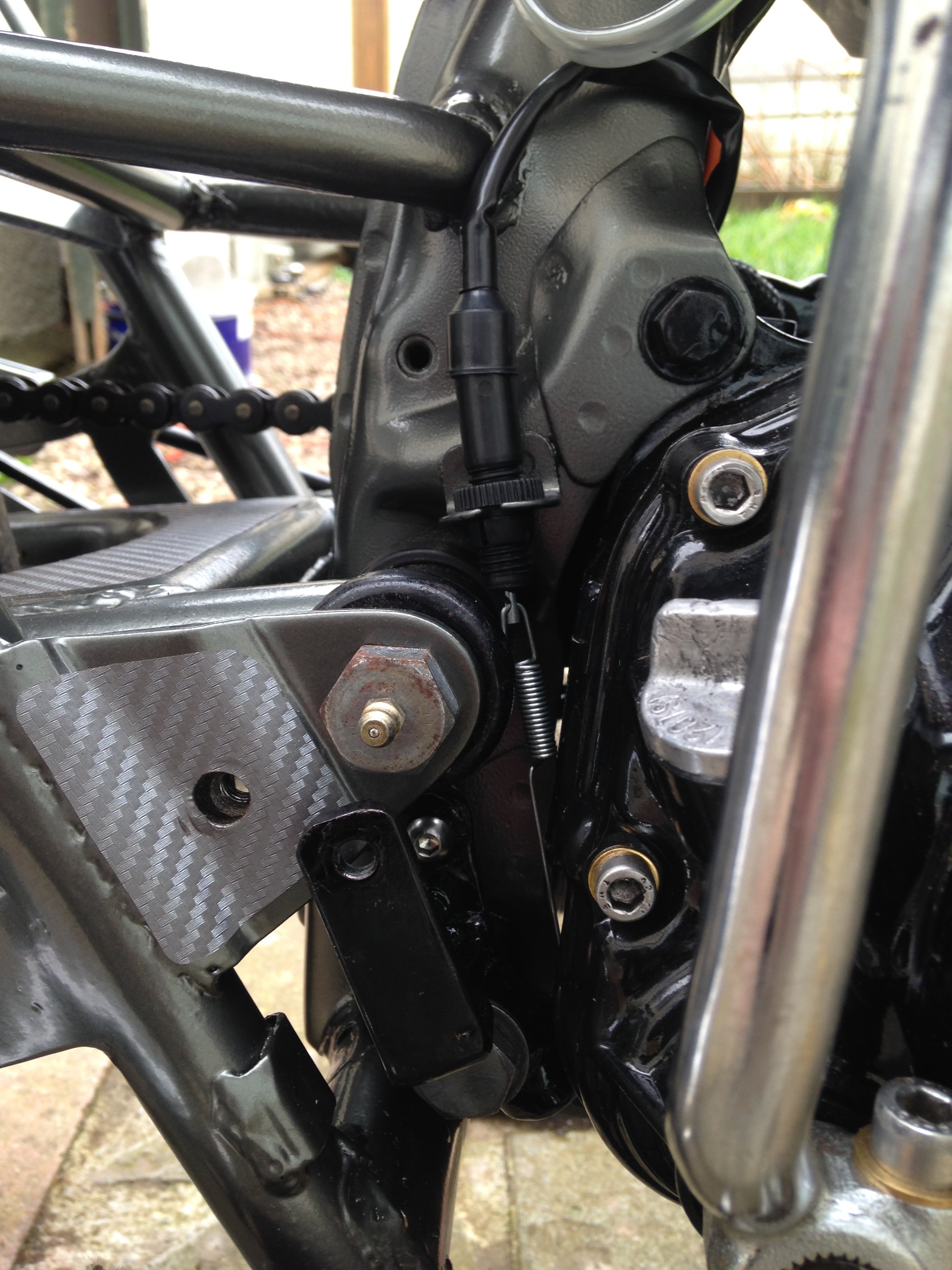

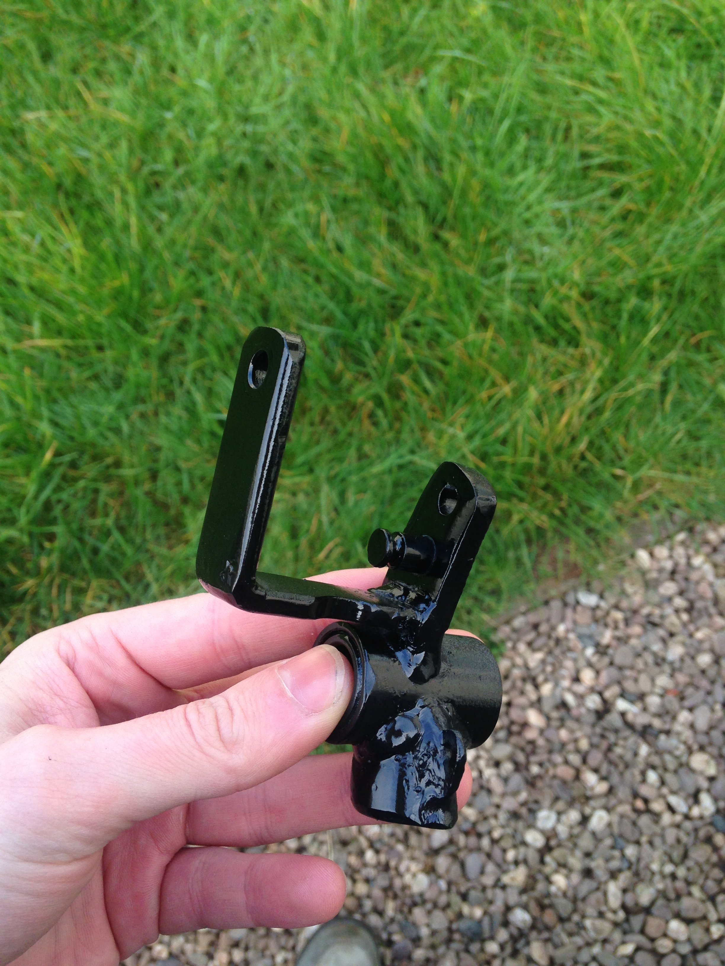

I also fabricated the rear brake bell crank to connect to the rear set.
I don't have the return spring (cut the frame mount off years ago :-[ ::)) or the brake adjuster as the lever didn't have it. If the spring from the drum brake itself aren't strong enough to return the lever satisfactorily I will get a spring and use a bolt tapped into the frame as the mount.
hopefully I will be doing the linkage tomorrow when I can collect my tap and die set from storage.
Sprayed the bellcrank overnight, and fitted it this morning. Works a treat. Think I may just have to add a return spring in future and possibly try and gain more clearance to the exhaust for when the new brake shoes wear. At the minute it stops about 1-2mm short of the exhaust at full engagement, but obviously this will increase in future.
The bellcrank meant I could run a stock brake light switch, so its tidied that area of the bike up now!
I also sprayed up my fairing brackets and my speedo mount as I didn't want it chrome any more, so out with the gloss black!
So its just 2 small indicator brackets, swapping out a few bits of hardware for stainless + brass, and then a few little wiring issues to sort.

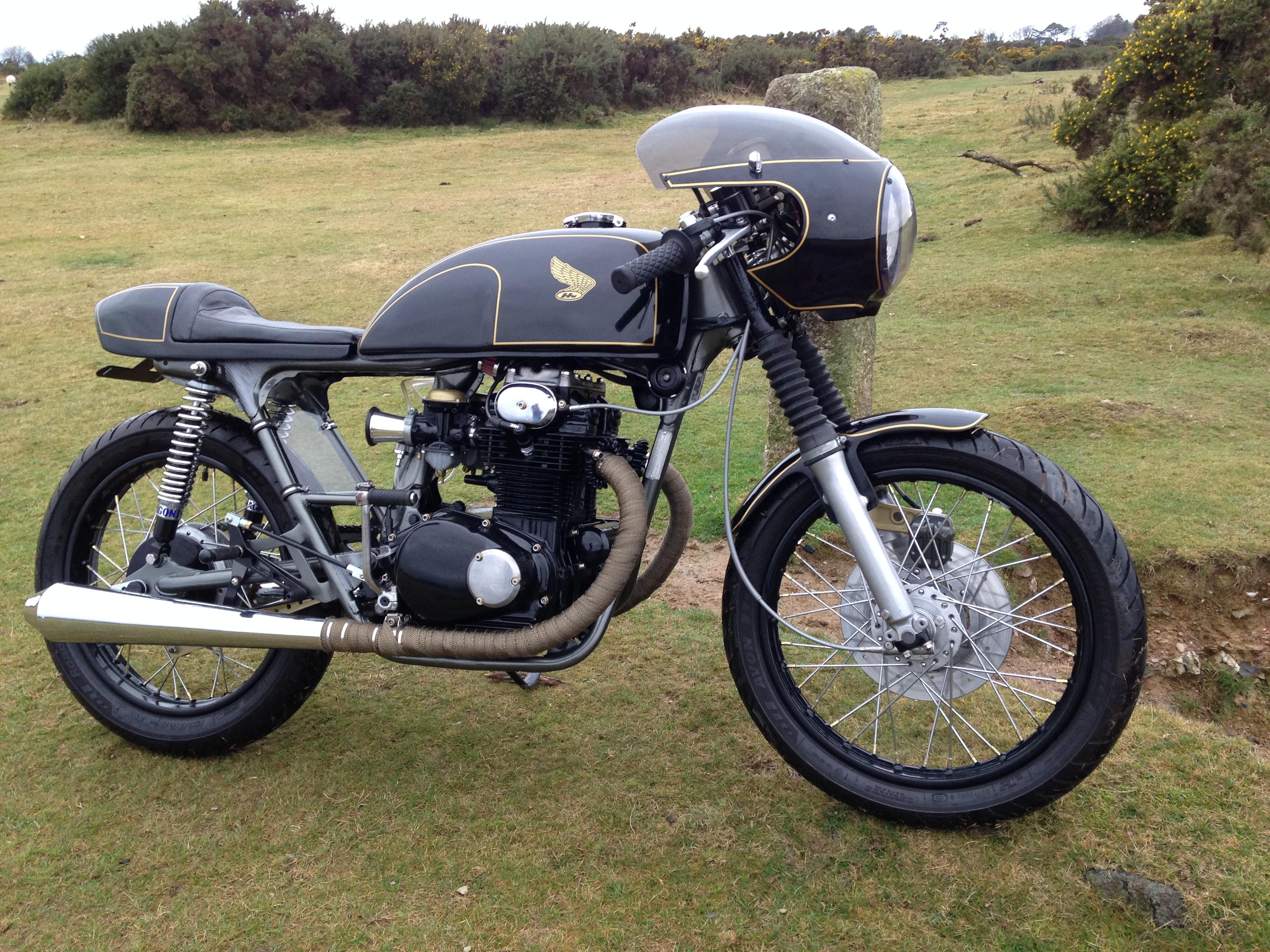

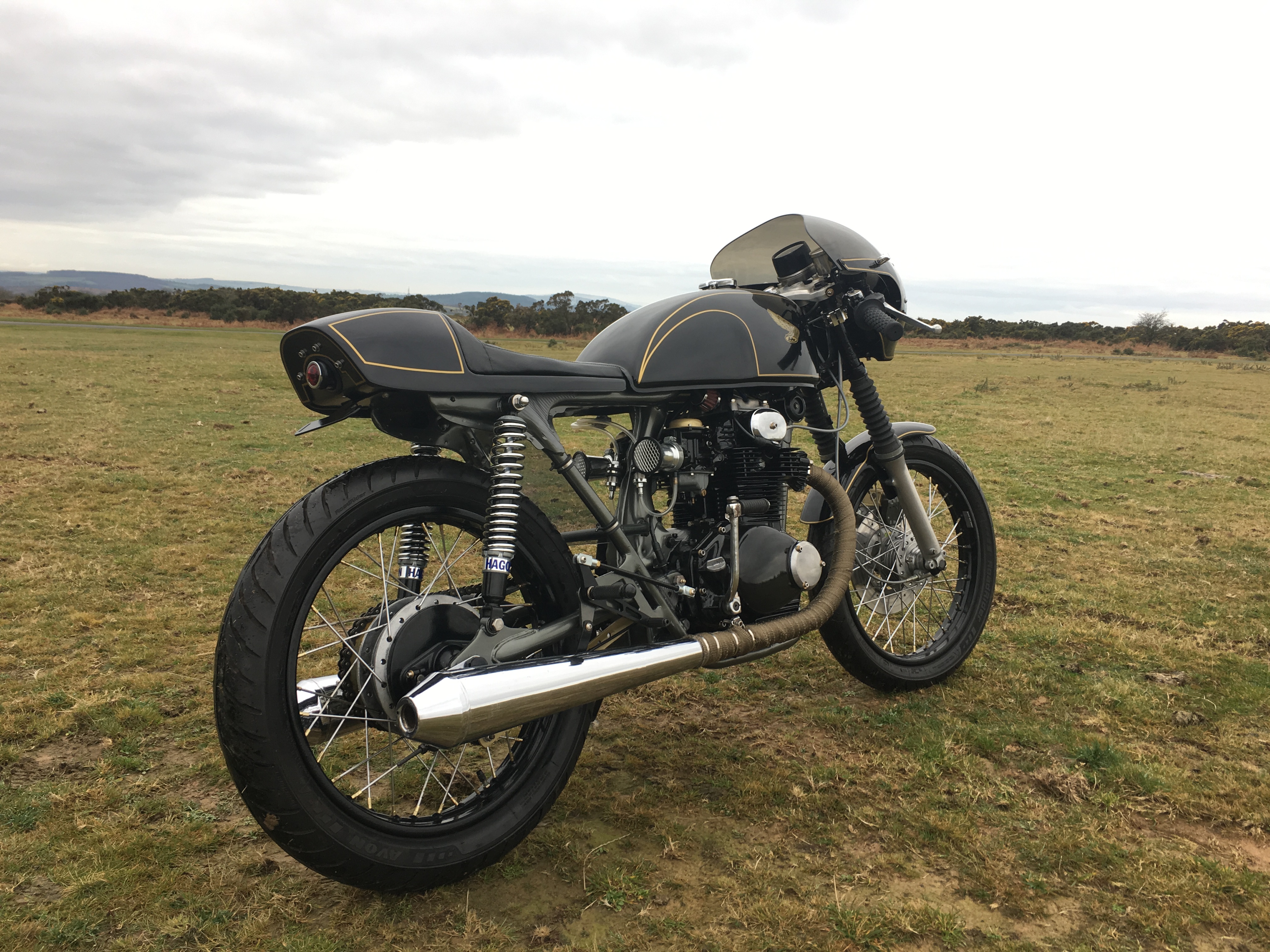

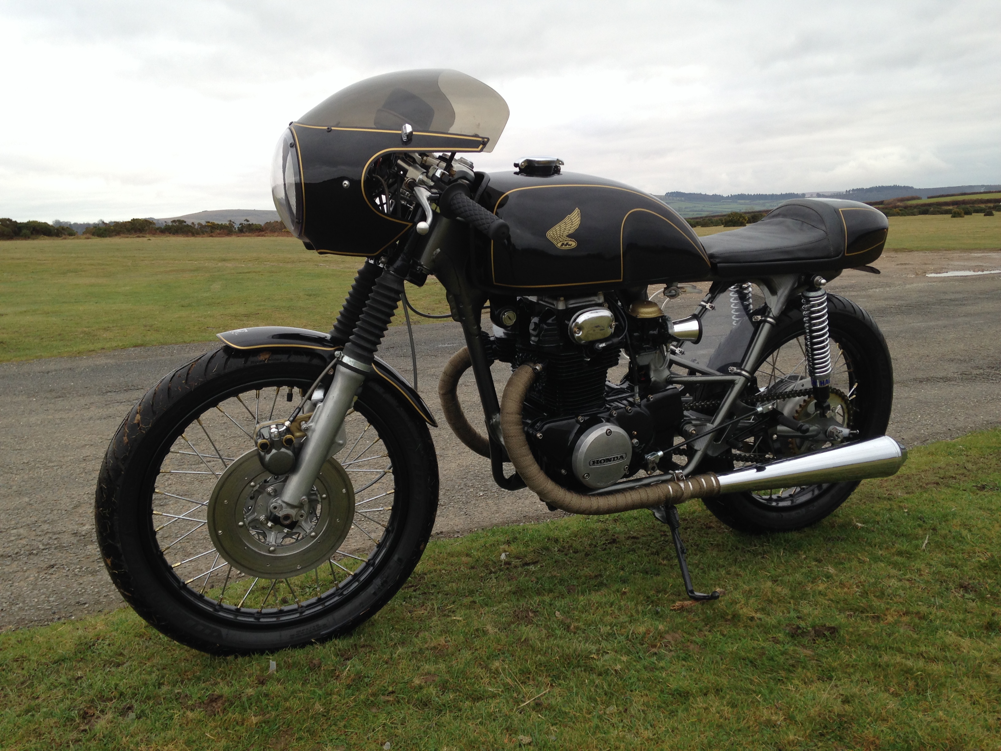

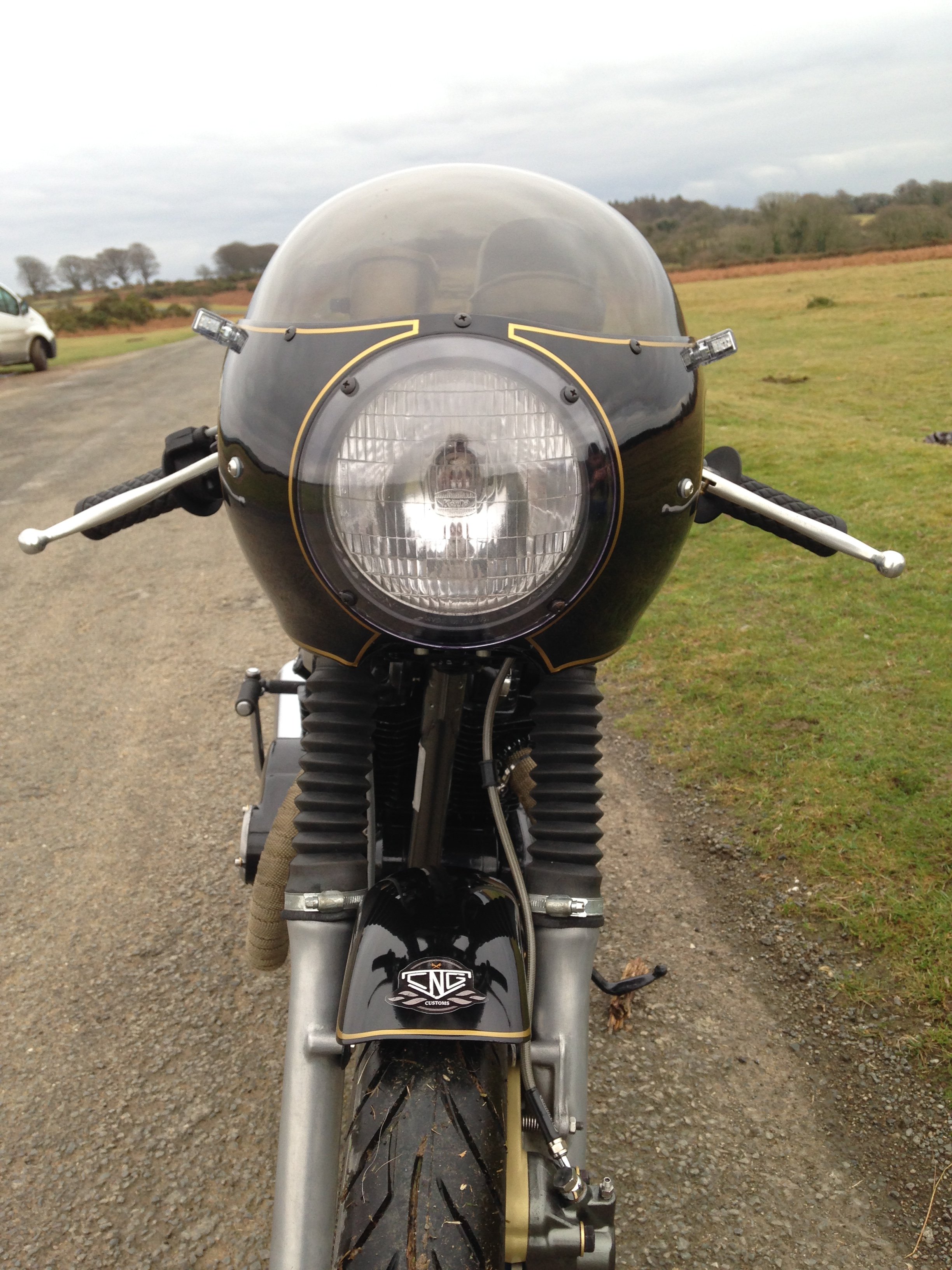

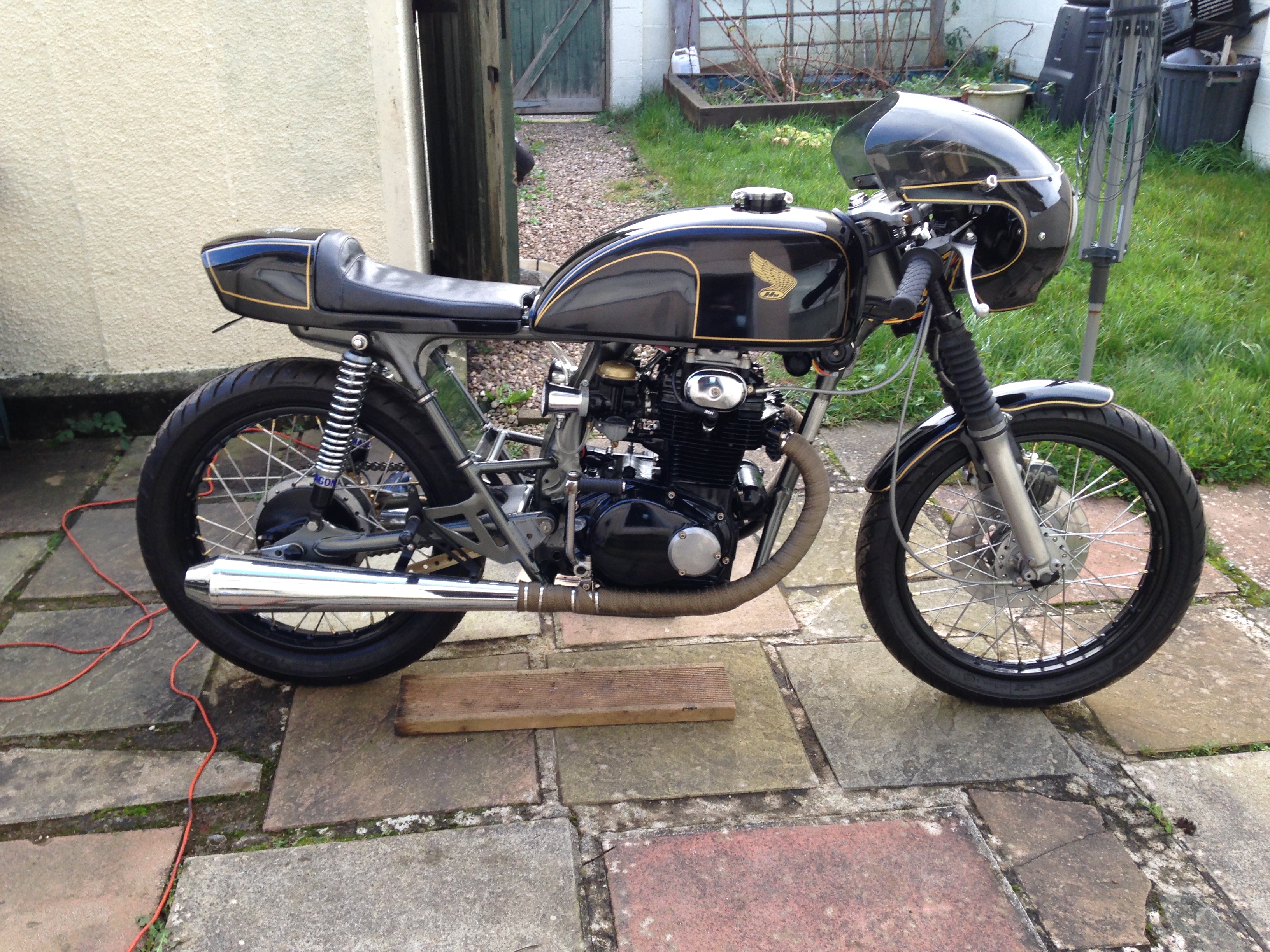

Presenting.....Alil.
Stands for 'A Lesson In Learning', as I wanted to teach myself how to do everything I wanted done on this bike myself. Sure I could have got other to do certain things which would have been tidier and quicker, but I wanted to do everything on this so I know the ins and outs of what was done. I appreciate all the help I have got along the way from all on this forum! Definitely what got me through more than half the build!
Apart from a bit of tinkering with the wiring (on/off switch still isn't playing nicely, only running on one cylinder at the minute) and some new simple rear indicator brackets....she's finished! Hopefully will sort them out and get her MOT'd when i'm back around Easter.
So I got a few finished shots from Dartmoor for you as I know how much you all love pictures.
