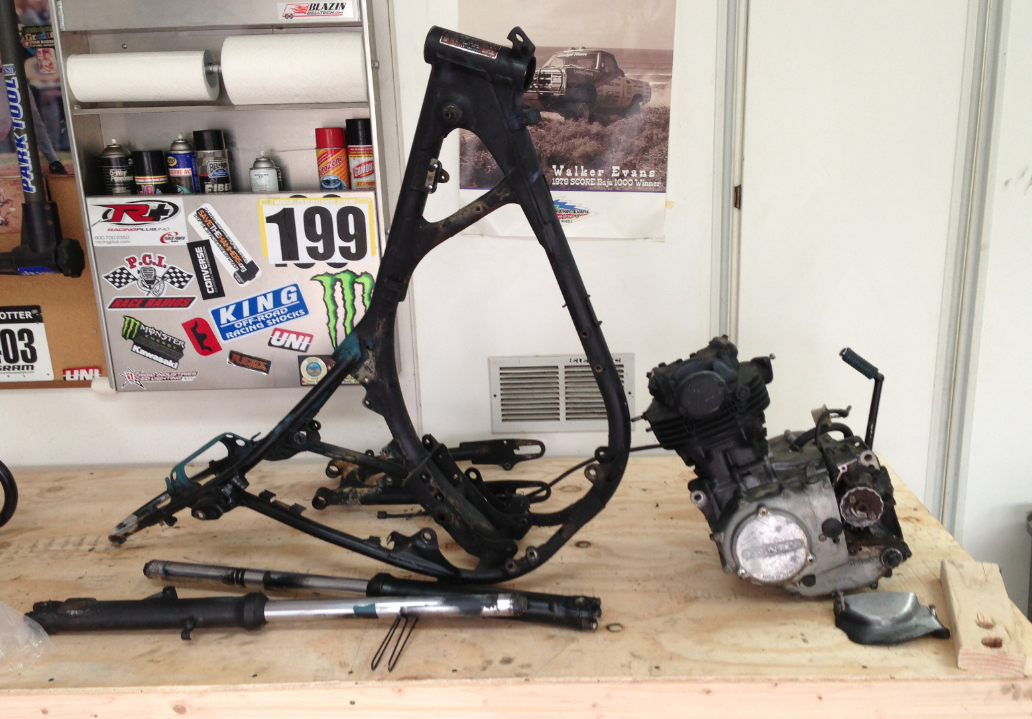

Next was usual tear down. I couldn't believe the amount of spray paint that one of the previous owners put to this thing. Also, I built a little table to make working on the bike easier.

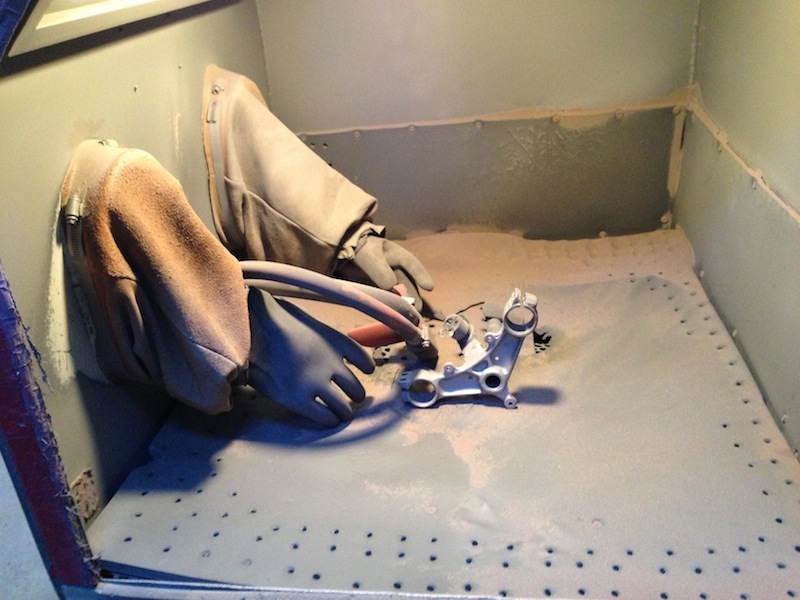

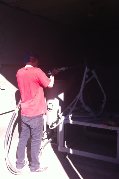

Went and sandblasted everything and got the 40 years of shit/spray paint off.

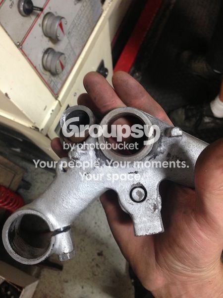

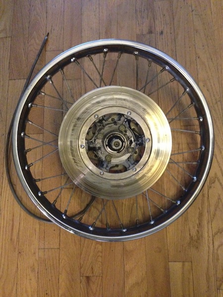

The first thing I wanted to tackle was the front end. I really don't like the 21 inch front wheel and since this bike is going to be ridden 95% on the street, I wanted more of a proportional front and rear wheel. After seeing Jake's cb350 swap, I knew this was the ticket. An 18 inch wheel front and rear I think would be ideal and would have more of a super-moto feel to it while handling a hell of a lot better. Also, I wanted to run a disc brake up front to give it some real stopping power. I searched around and a member of the forum, iContango sold me a complete 73 cb350 front end.

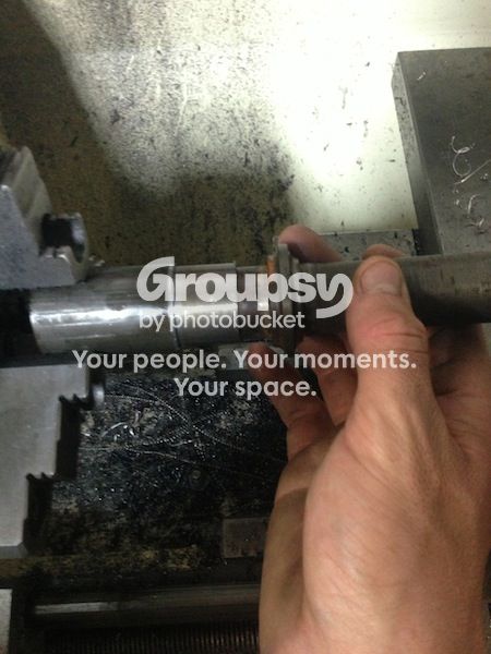

The first thing to do for the front end swap was switch out both of the stems. Since the 250 has a smaller head tube, the 350 stem won't fit.
Sanded the welds flush and pressed out both stems.
Then machined a 3/4in tube to slip over the stem to make up for the size difference with the 350 tree.
Then welded it up

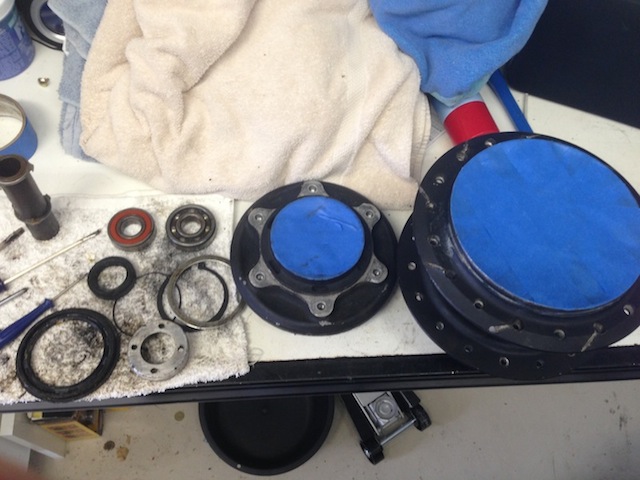

Started to rebuild the rear wheel. The spokes and nipples were so badly rusted that I had to cut them out. pulled all the bearings and stripped the hub. The bearings were actually in pretty good shape but I ordered new dust seals and brake shoes. Masked off the internal parts of the hub. Now off to blast and powder.
