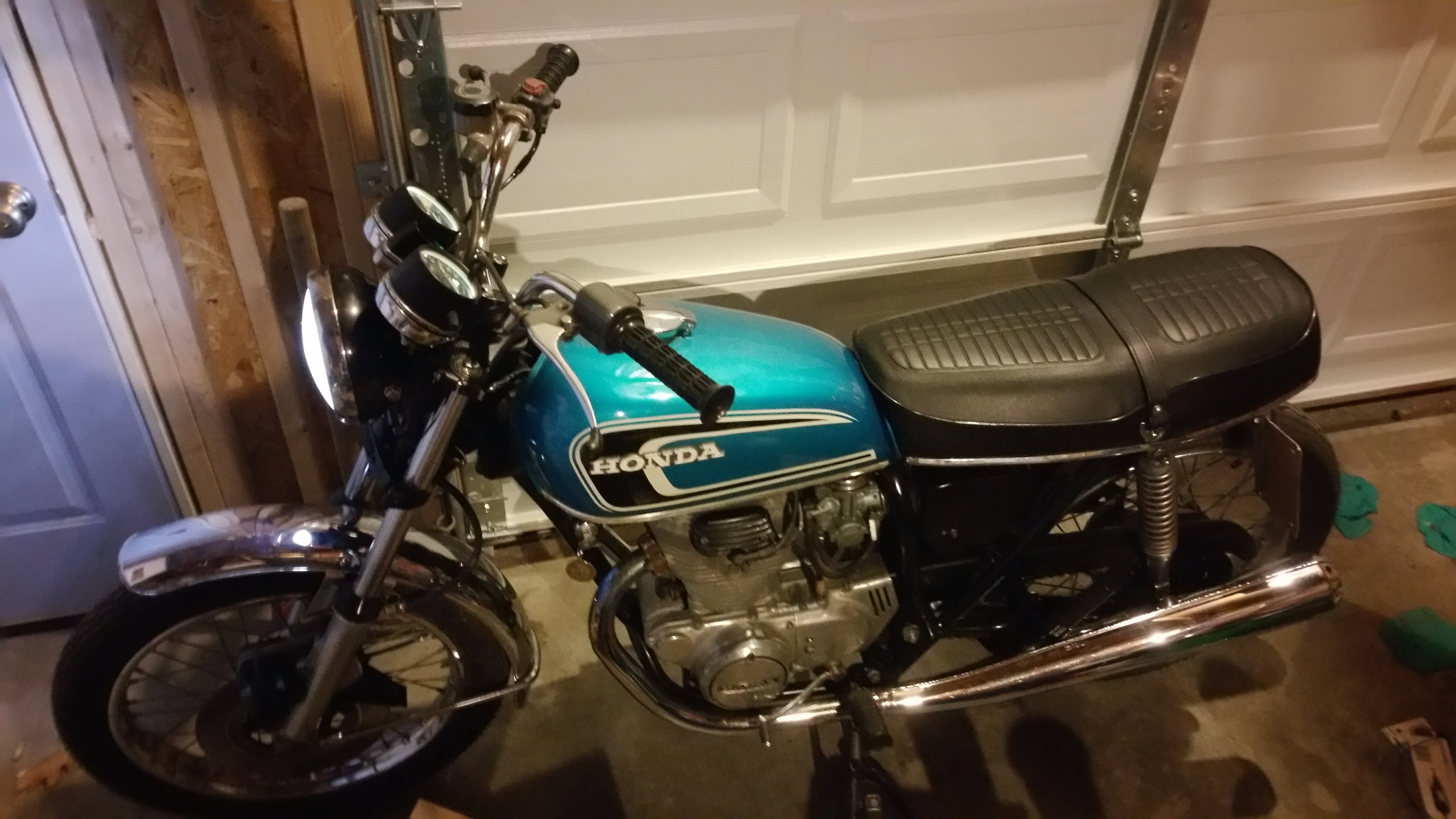

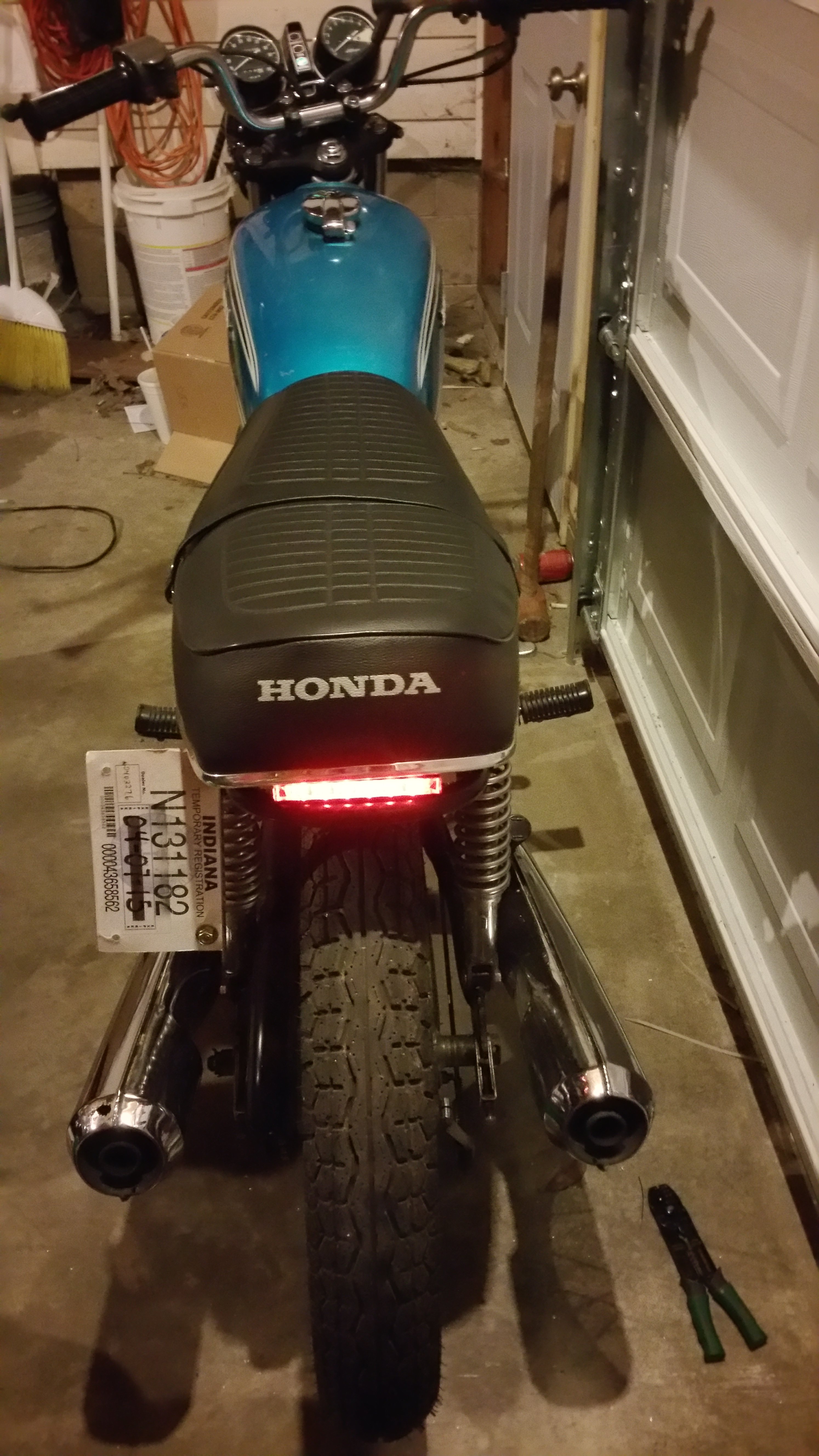

Yeah i love the look of that setup. I'm trying not to move the battery or anything else for that matter. I wont need to change the seat on a whim, but i also dont want it to take an hour haha. Trying to run an aluminum rail down each side of the frame in spots where i can bolt the cafe seat in but wont interfere with the orig seat for 2 up rides. I know theres probably easier ways to do this with a different cafe seat but this is the one i have so im gonna try to make it work before i pay more loot for an easier solution haha im stubborn.
Updated pics. Next step will be rear sets, seat and low rise clip ons.

It is a sharp lookin machine.

its hard to tell in the pics. Is the inner fender inside there?

Might try and get the pad for the seat done tomorrow. Ordered the low rise tarozzis last night. And yes took the plastic inner fender off, replaced with a cut piece of sheet metal. Its zip tied for now haha(you can see them they're white).
Haha i knew youd like that. Found my black ones, need to make the inner fender longer. Its not covering enough.

Update, Tarozzi low rises will be in Monday from fftp. Cut down a doner front fender, kept the stock brake line grommet (not done with the front, need to curve edges on the front) and made a flirt rear fender from what i cut off the front. Fits the rear tire better than the stock one that swallowed it haha.
Also changed my mind about the cafe seat. Going with a modified stock mounted pan with a lower flatter seat.
