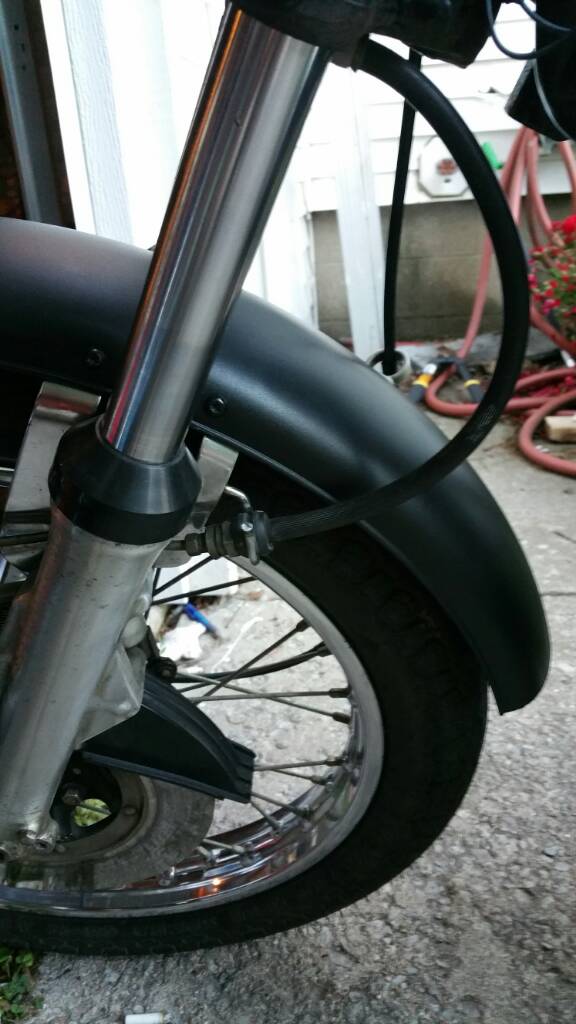

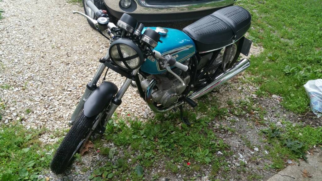

Update, got the Sparck Moto reg/rect all wired up. Mine came pre wired so it was fairly easy plug and play. Installed new front brake pressure switch easy peezy. Cut throttle pull cable to proper length, soldered barrels and installed. Deleted push cable (i know how to shut my bike off if spring gives out), repainted and cut the front fender, now more eye pleasing than the straight cut haha(4in angle grinder... doesnt look half bad imho) as well as repainted the rear flirt fender. Went with satin black instead of flat this time. Seems to match the frame pretty well and doesnt have that grayish look to it without being too shiny. Also redid my license plate bracket with a thicker aluminum L bar. My other one cracked, bent and almost flew off. Live and learn haha anyways heres some pics as it rides now... btw i think the X is cool, i know the purpose of taping the light, its got a cool retro look, i dont ride at night and the led bulb i fitted will not melt the tape i like it so until i get the headlight i want, it stays. Thanks to Trek97 for all the late night and early morning messaging help!!! And a well deserved BOTM for ya! I believe 99% of your votes came from members you've helped, influenced, or inspired like me.

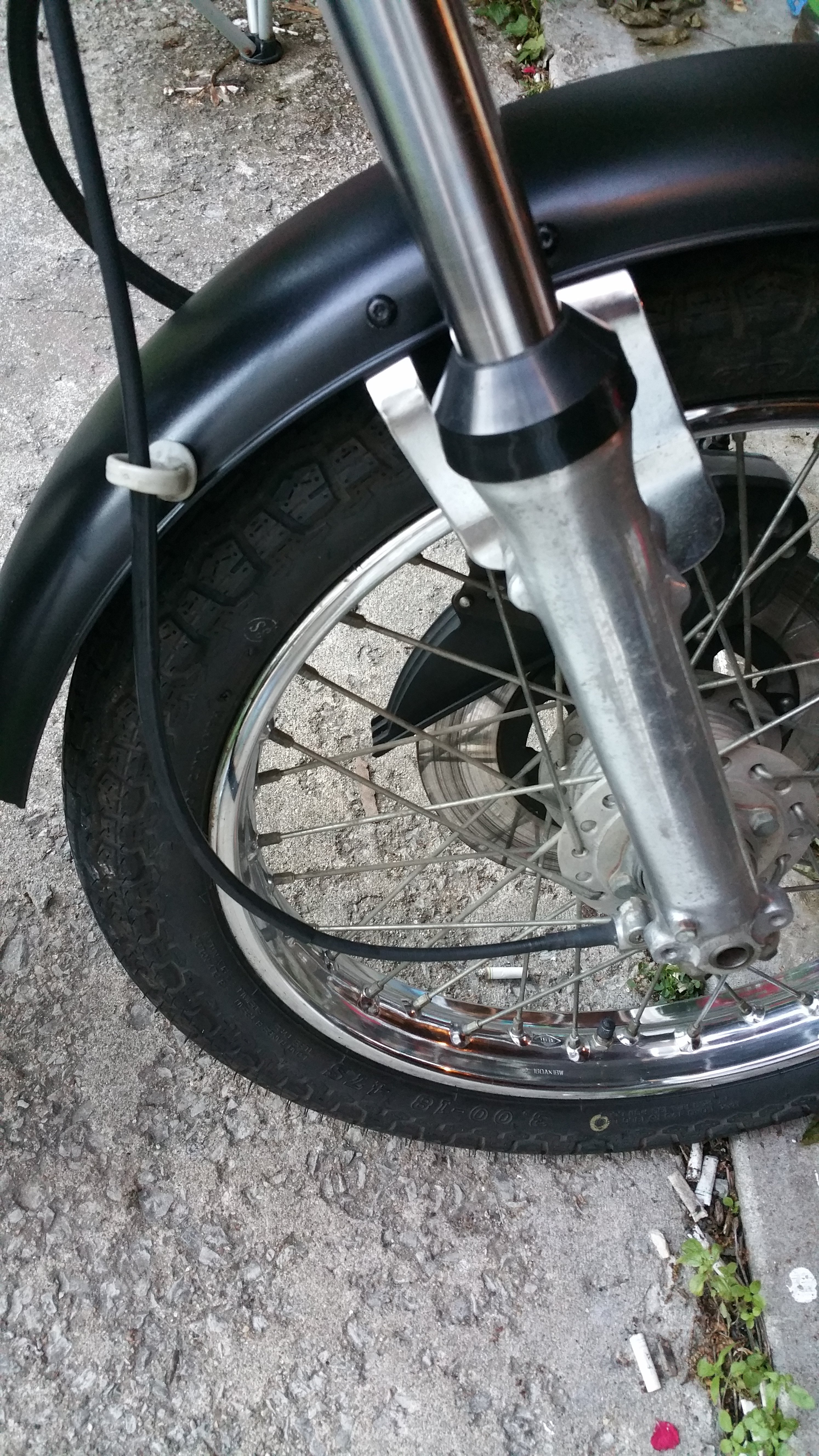

I would re-fit the stay, gives speed cable somewhere to live without rubbing on tyre
Are you talking about the rubber one on the fender? Its on the side not pictured need to paint it black though kinda sticks out now.

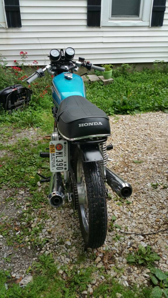

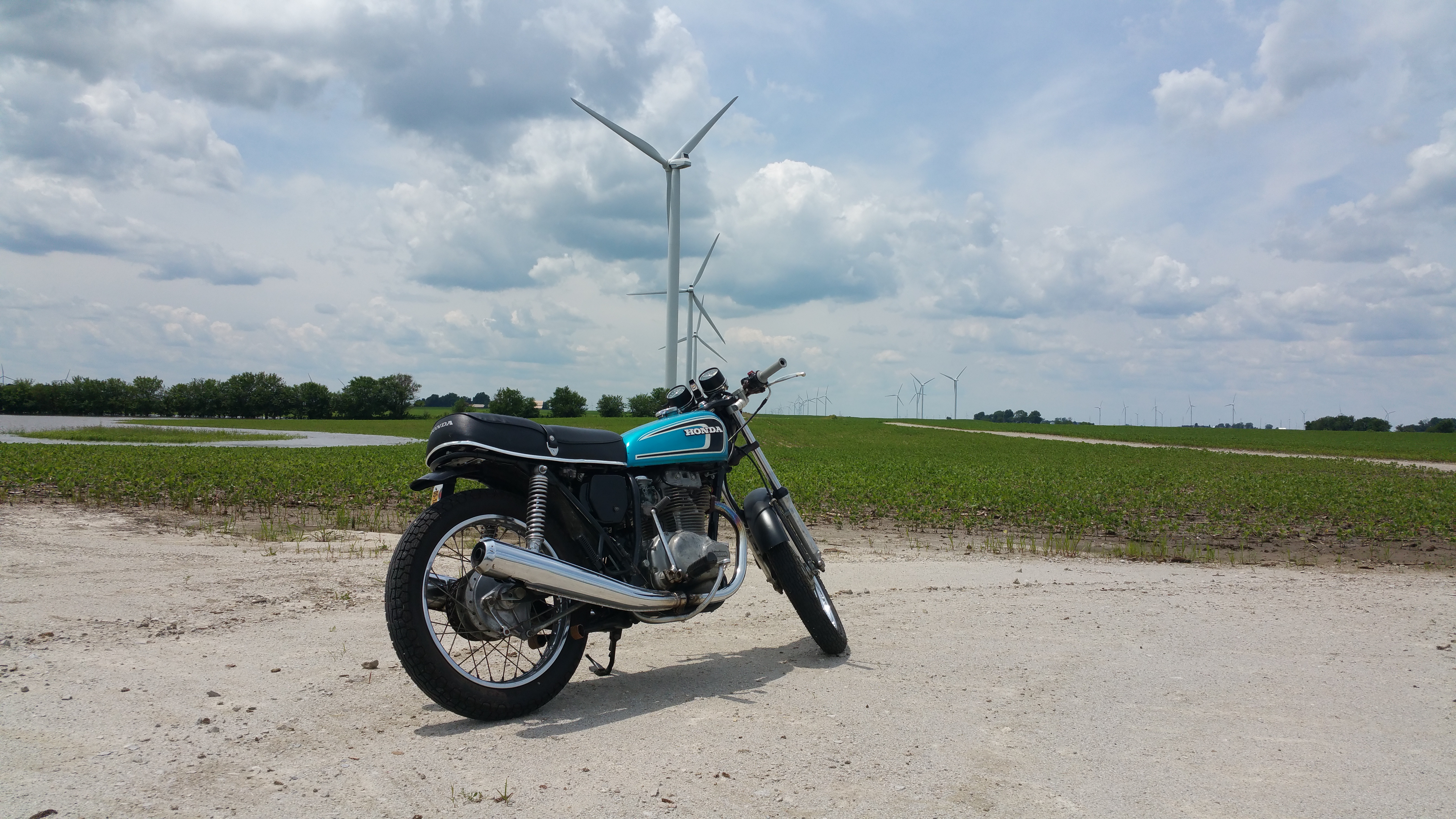

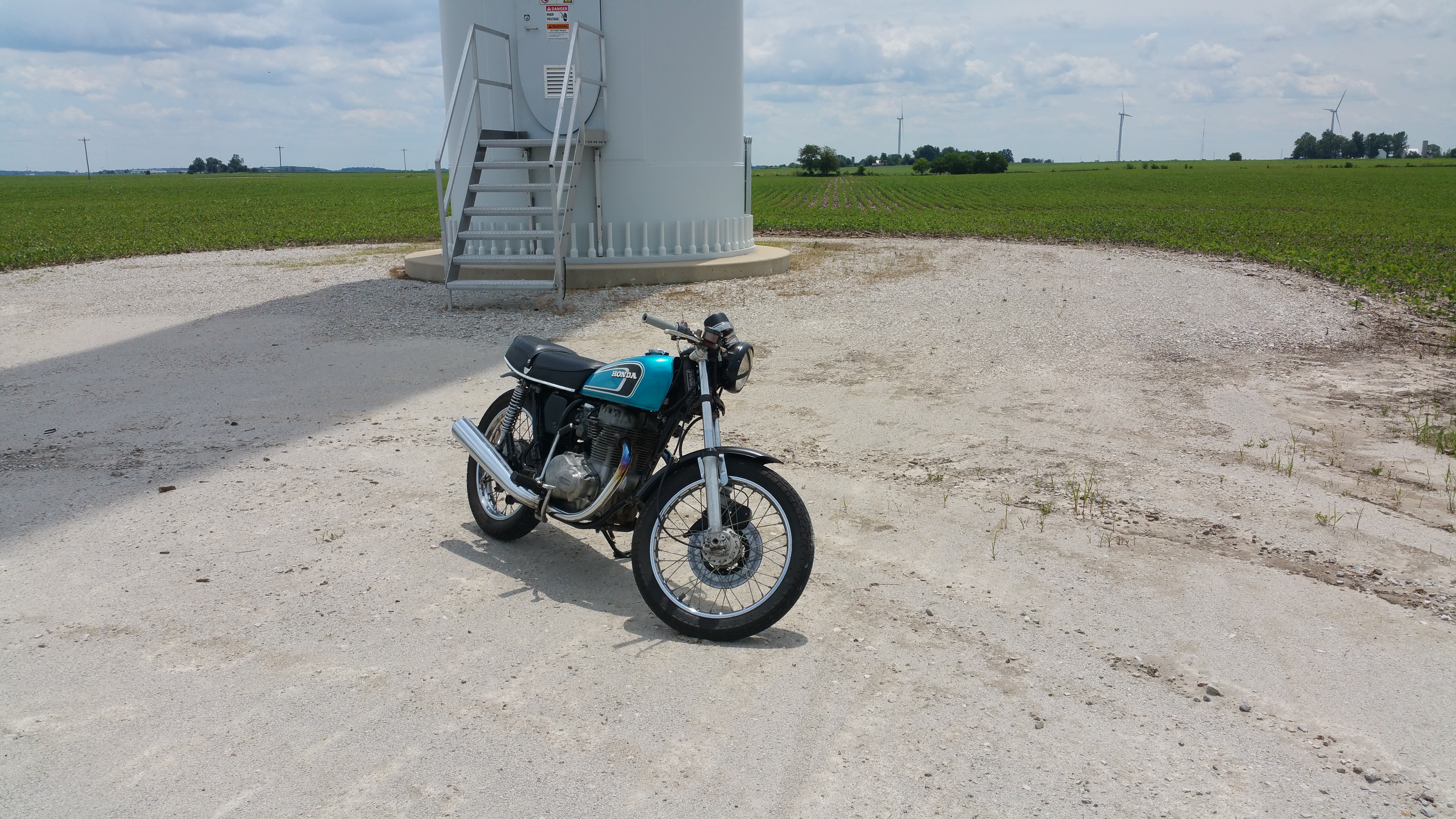

Headlight finally on its way. Painting side covers satin canyon black to match hl bezel, fenders etc. Removed annoying reflecter ears from forks. Put about 100miles on it today heres a few glamour shots as is... Seat in a couple weeks, found tuffside.com has some very nice ready to go seats but still cant decide if i want to with the hump or flat brat style argh.

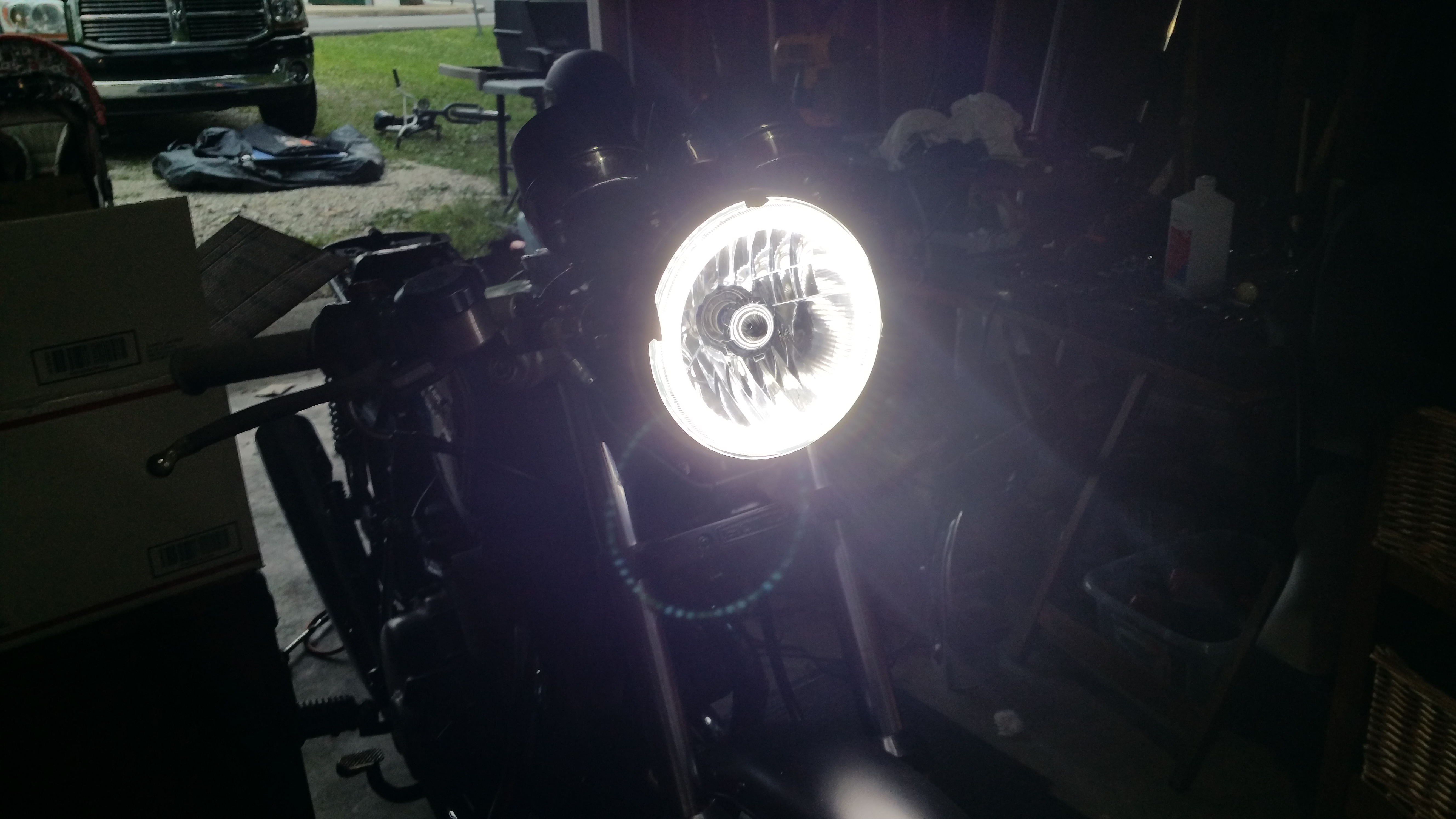

48led halo + h4 7" headlight
Was built for Harley 7" bezel. 360 bezel is just shy of that and also has many tabs in the way of installation. Cut unwanted/unneeded tabs off, still wouldnt squeeze in. So, i cut the bezel at 6 o'clock(bottom), stretched a lil, and boom, not so perfect fit haha. Tabs to mount bezel to bucket were kept and utilized. I was very surprised the 2 bolt holes lined up after cutting/stretching to get the new lamp in. Bucket was too shallow so I cut the back out so the new lamps rubber gasket fits tightly in the new hole in the bucket. All i wanted the headlight for was the 48led halo for dawn/dusk riding since I don't ride at night. Its a death wish on no light county roads with all the critters and drunkerds. So I've only hooked up the halo to my battery running a switch from a apace heater I tore apart, BONUS, it slid perfectly into the old bar holes in the TTT.
Anyways, a lil electrical tape hides the bottom cut and it looks dam good. Getting lots of weird looks and thumbs up from those in the know.

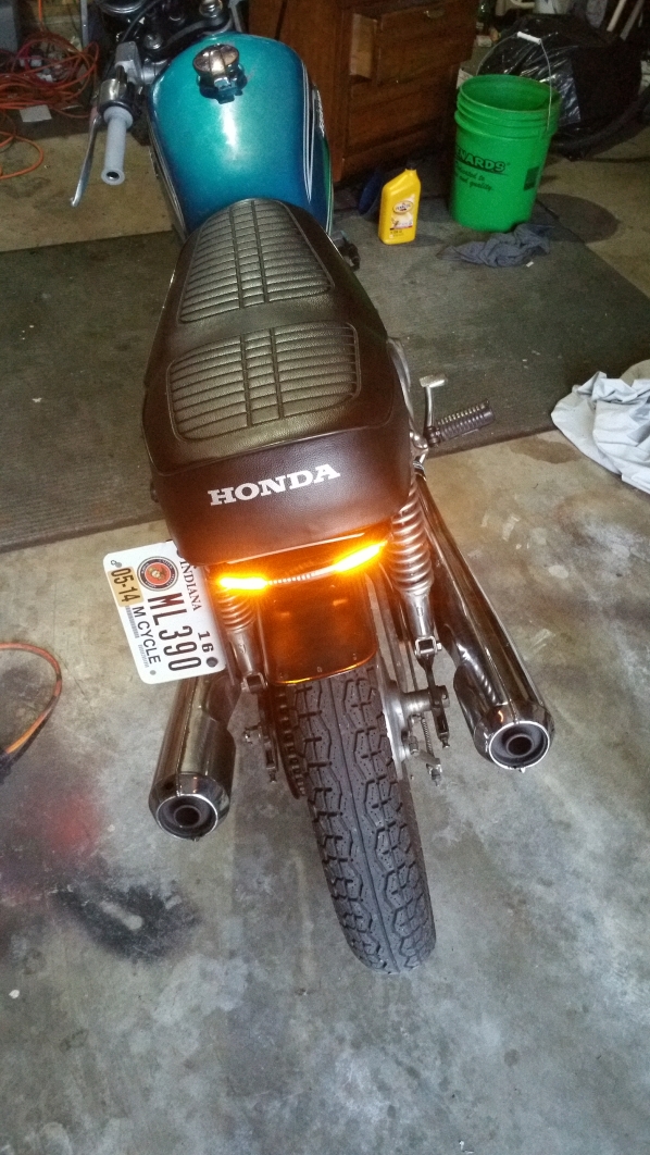

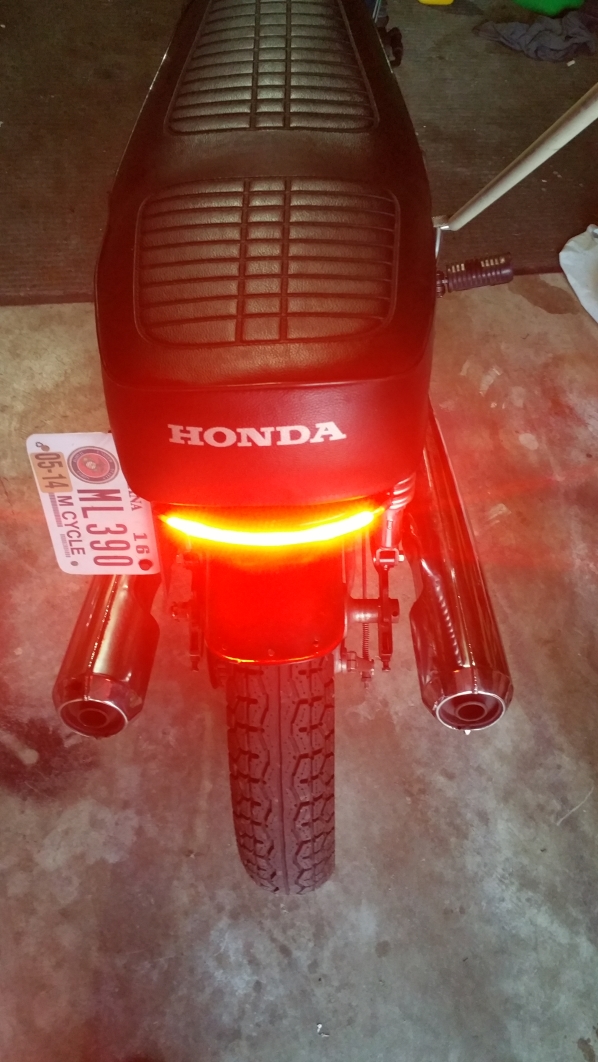

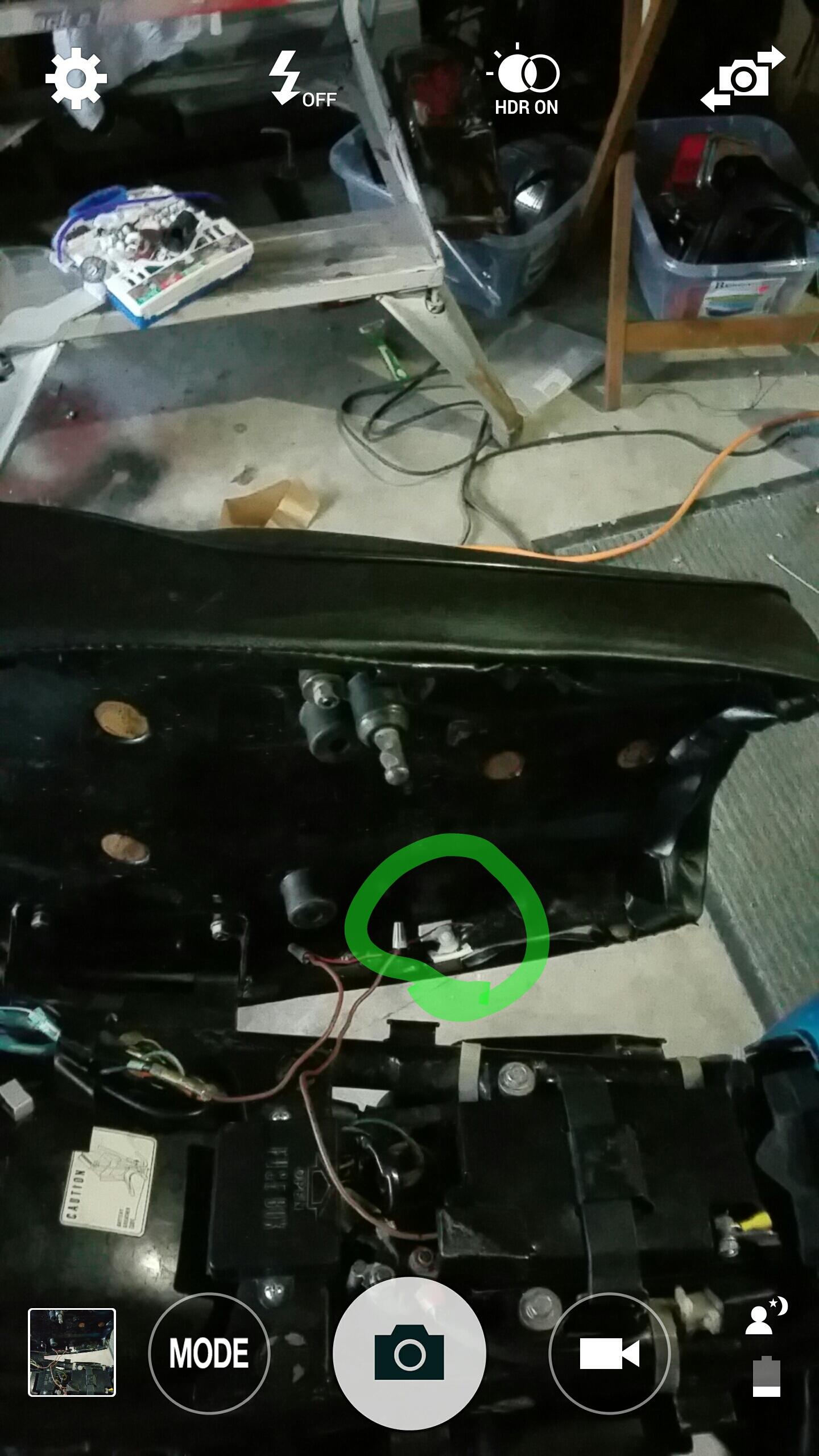

Miss mail womans 2nd visit was to give me this, the rear hoop led running/brake/signal light. Simple install and wiring. Ran running light to hidden switch under seat (reminds me of hot rodders with shaved doors and hidden solenoids).
Signals just both come on at the same time, no flash. I know ive seen people using led signal correctors and i tried the pilot brand ones i had with no luck. Matt ( SparckMoto) do u make these? Cant remember who was selling them, maybe crazypj ?
Anyways, I'm happy with the product, bright enough running light and very bright brake/sig lights. And I've got no probs using my arm sigs as usual until i can fix.
