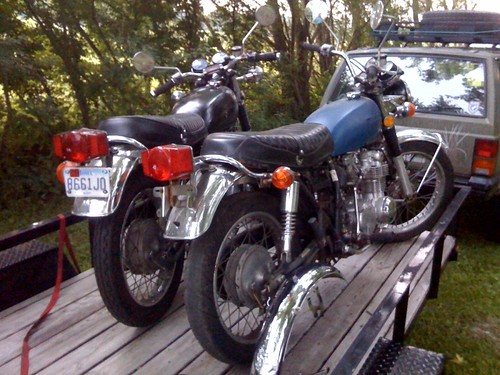

Here are the 2 bikes when Jordan (TurdFurguson) picked them up in June 09.

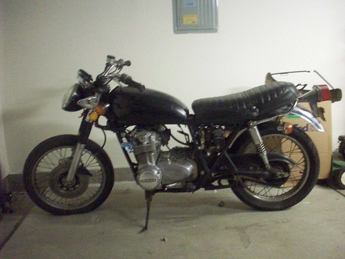

Here is the bike when I brought it home in November (jordan stole some parts for his bike...part of the deal)
As you can see I have my work cut out for me....I have already rebuilt the carbs and have more of the bike pulled apart. I will update it with some newer pics tonight! Thanks for looking!!

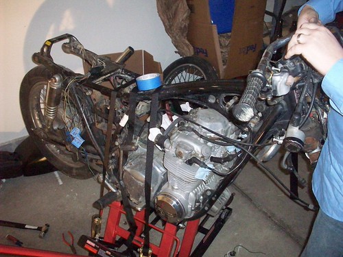

TF came down and we did some work last night...mainly beer drinking and commenting that I will never get this done...haha!
Got the rear stripped down, undid the mess that is the wiring located in the headlight and managed to get them all pulled out of the bars. I am pretty much at the point to start rebuilding. I need to cut the frame and get the tubing necessary to to form/weld a hoop on the rear. Once that is complete, I am going to mock up a seat pan and then get one laser cut and form it here at work.

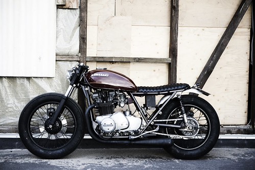

This is the look I am going for....I am thinking it would be classified more of a Cafe??

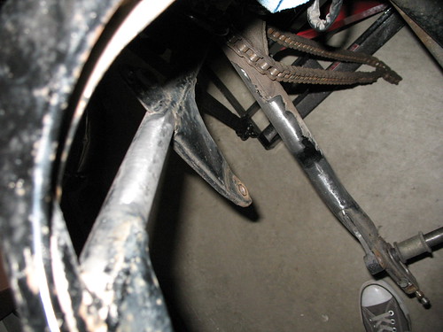

I did a little bit of surgery last night, well more of an amputation for now.
Before:
After:
Now to find some tubing to finish the rear hoop.

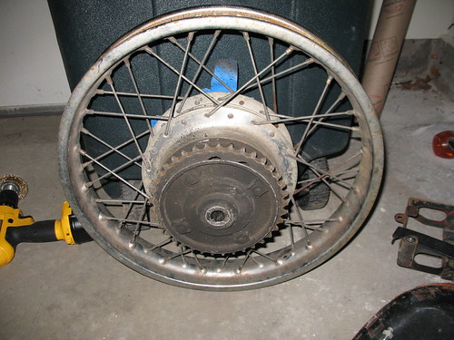

This last week and weekend, I pulled off the rear wheel and front and have the tires off. Wheels are ready for a good clean and some paint. I cut and ground off the stock seat hinge point, tabs for the chain guard, and a few others for side covers.
This next week I plan to get the tube I bought bent and get the rear hoop made, then touch up the frame with paint.

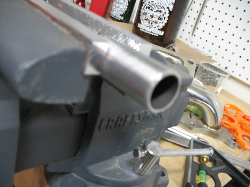

Rear hoop bent and formed to correct width along with the slugs to sleeve it to the frame. (today I will be cutting the hoop to create an angle with the rear hoop...pics later)

Hold on to your hats! I have a second update for this week! Its kind of hard to believe it's not weeks in between as usual. Anyway, I made some relief cuts to the rear hoop and then built a fixture with extra material here at work to hold the sucker in place. Going to weld it up tomorrow and then take it home and shorten the length!
Before cuts
After cuts and held in fixture (just threw it together)
The cuts were my first time doing it. I drew it out on AutoCAD and then taped the template on the tube and cut away. It will look better after being welded and then smoothed out. Stay tuned!
Re: 74' CB550 WM-Style Build
Well here is the finished hoop. I after getting it welded, smoothed, and cut to length, I am not liking the angle. I made it too steep. I am bummed. Don't get me wrong, I tried it on there before I welded it and thought it looked good. Oh well, you live and learn. I am going to use a Press Brake at work today to bump the angle. If that doesn't work, i will make another rear hoop.
