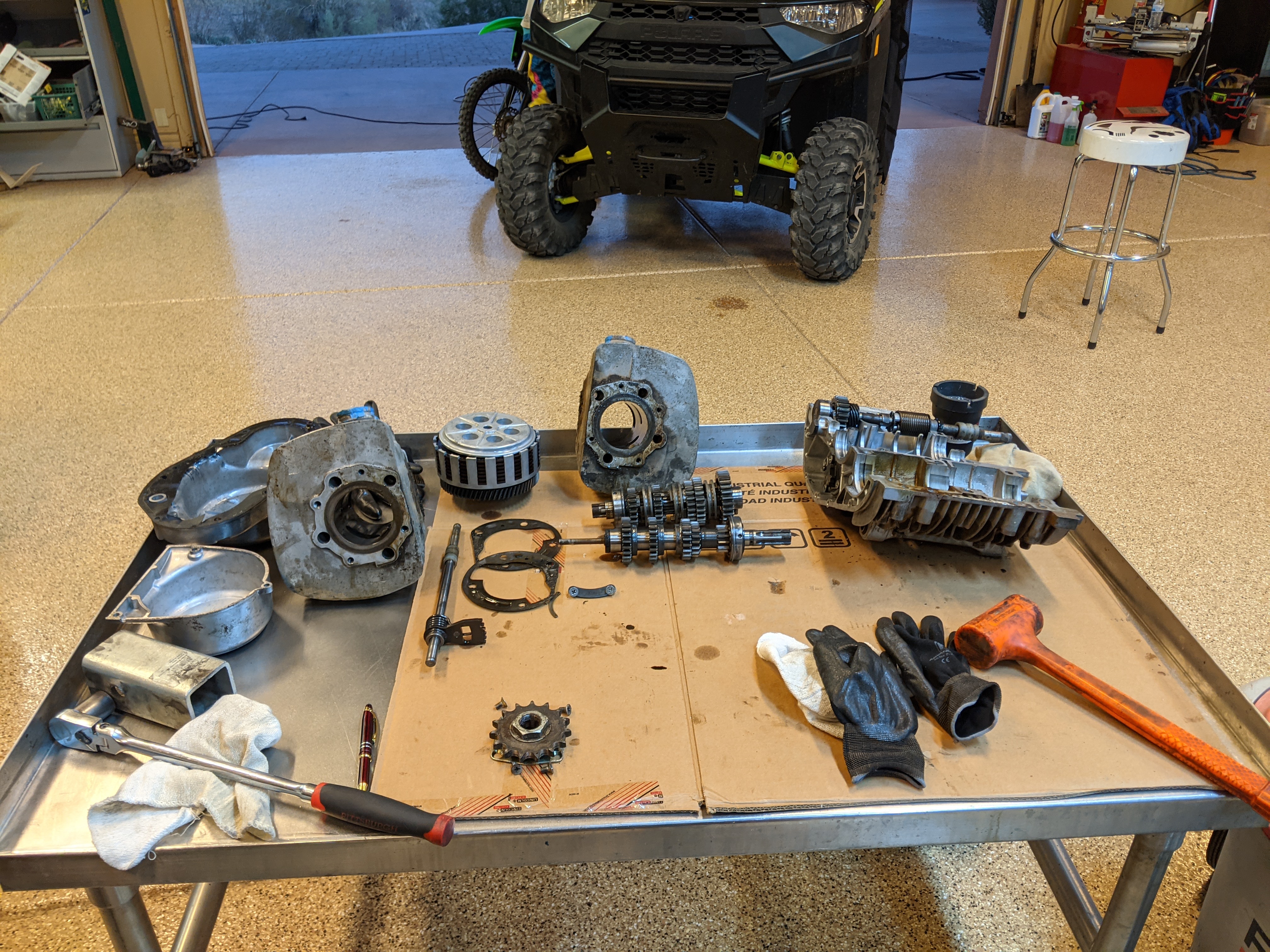

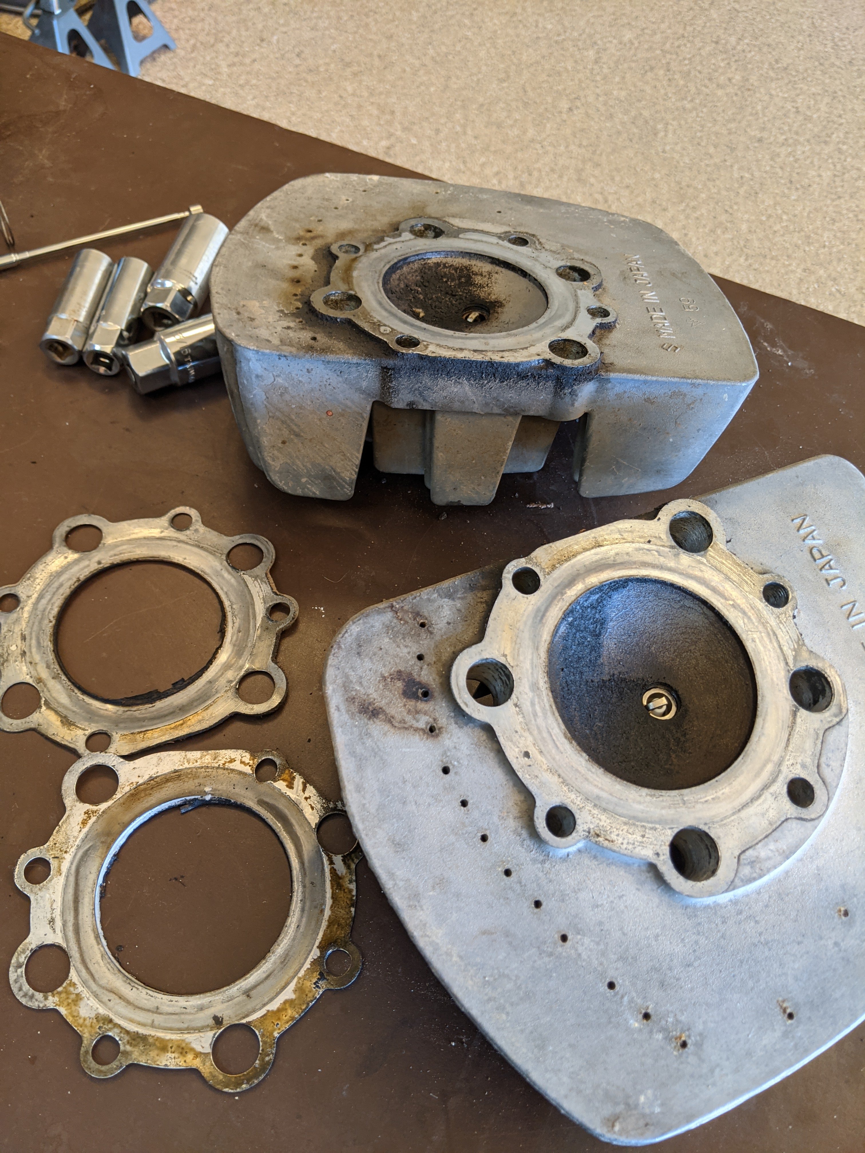

So I will be attempting to raise the dead. We will be calling her Phoenix, rising from the ashes. I think I have a pretty decent starting point. The bike came to me in pieces, but it looks like I have most of the parts. First things first, the engine. Drained the oil, which looked like new, no joke, like it came out of a fresh bottle, good news. The cylinder heads were already off, so no compression test. Pistons look good and also no visible or feeling of anything in the cylinders, all moves freely. \
I was going to take apart the entire engine, but it appears to be in good shape, no leaking, free moving, etc. I think I would like to attempt to get it running first. If a full rebuild is needed, we will take that on later. Not planning on a full resto, more of a cafe style I think. I will for sure be staying away from hacking anything that could keep this bike from a full resto in the future. We plan on riding it, using it, etc for now.
Problem 1. Noticed we are missing one of the oil feed lines, the ones with the banjo bolts and small check valves in them. The other one feels very brittle and I am afraid it will crack. This is our first problem, where to find or how to fab this part. I would prefer to fab or purchase something other than plastic to replace both lines. Hoping someone here has dealt with this and has some suggestions.
Problem 2. Cylinder head gaskets. Again, finding this part appears problematic. I do have both old metal gaskets, but would rather use new gaskets. Any ideas or past experience in reusing the old ones ?
Once I sort the above 2 problems out, then onto the carbs. Rebuild kits available ?
Here are some pics to get things started. I have also included a pic of a build my neighbor just finished, a HD 883 Enduro build. If anyone has questions on that build, I can for sure help as everything was documented and all custom part designs are saved.

Nice period cafe racer. Pipes appear to be Basanni which had a great reputation back in the day. They can be cleaned out and repacked cheaply. There are better pipes available now but at a cost. I'd keep those and I would keep the color scheme. It's a tribute to teh wporks Suzuki racers of the early 70s.
I stay away from carb kits because the parts are rarely accurate enough. Jets and needles are available. Pistons are also available if you need them. What are less available are crank parts. The big end bearings can be hard to find but they last a long time if there's not rust in the crank. Seals go hard and I'd strongly recommend you split the bottom end and replace the crank outer seals and transmission seals.

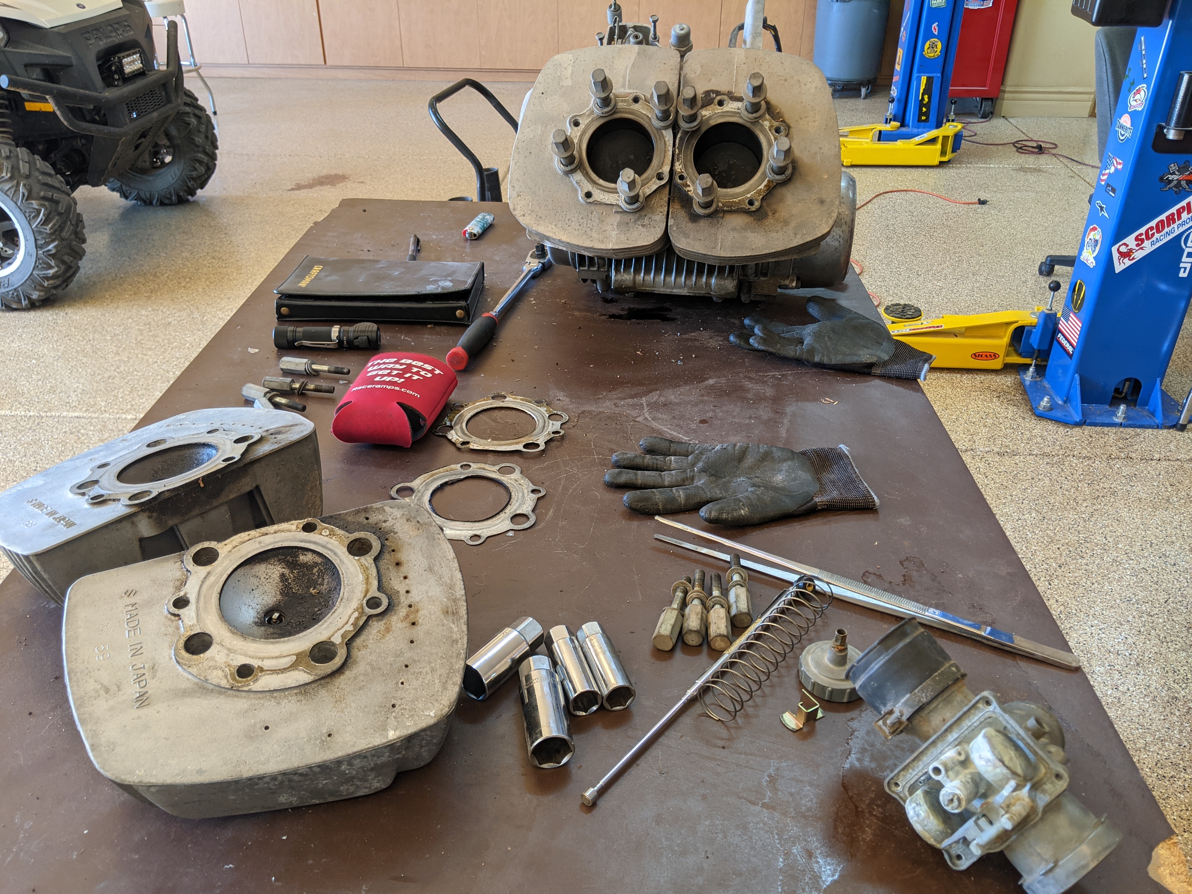

So.... I am in over my head. Glad I decided to split the bottom, do it right the first time. I will for sure be needing some technical info when putting it back together. I labeled most bolts and bagged them, but parts fell off during the tear down which I am not sure where they belong. Next step is removing the pistons (which look pretty good to me, but I am far from an expert). I am slightly concerned about the rust on the one side of the crank and in the bottom of the case, but not sure if that is a issue. Then onto cleaning everything. Please chime in if you notice anything in the pics that looks concerning. More posts to come soon.

Couple of observations/questions. That brown goop in one crankcase half. Is it rusty oil or rusty water? Both sides should have some oil in the bottom end after the bike has been run. Not a huge amount but should be wet with oil.
Pistons look old style. Clean them up and measure ring gap and clearance.
Get a workshop manual or FSM (Factory Service Manual) to see the steps and download a copy of parts book.
Gears wear and whine so inspect the teeth and research the oil dam modification to increase oil capacity.
The rest is all pretty simple, so take your time and ask questions if you are not sure. And be careful with all matching surfaces. Try to clean them without scratching and do not use any sort of power tool on the faces or else it will never seal again.

Thanks for the reply. this is exactly the kind of advice I am looking for. This is my first engine full rebuild, so not any exp really. I have a link to a FSM, but it is really hard to navigate as it is not in a PDF style format, it is in HTML, click for each page, no directory or ability to move quickly in the manual. Any info on where to obtain a full FSM in either PDF or good old school paper would be awesome. Same thing for the parts book.
I will inspect all gears for wear.
As far as the oil dam mod, from what I read this is a 1974, which has the extra 200cc of oil that solved that problem. The case is stamped 1400cc. Please let me know if I am mistaken about this and still need to do a mod.
I have sourced a old media blaster from a neighbor and am in the process of restoring it, not much to it that I can see. I have already found new gloves for it as the originals were heat worn. I bought 50lbs of medium coarse walnut shells for blasting. That being said, I have never used a media blaster and am also uncertain about using the walnut shells on all surfaces. Any input on those items would be greatly appreciated.
