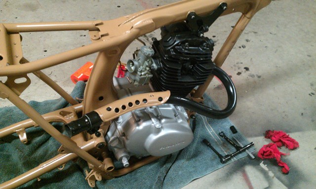

Here are shots of the "after". Everything has just been rattle canned with Dupicolors high heat engine paints. Again, keeping this build cheap!

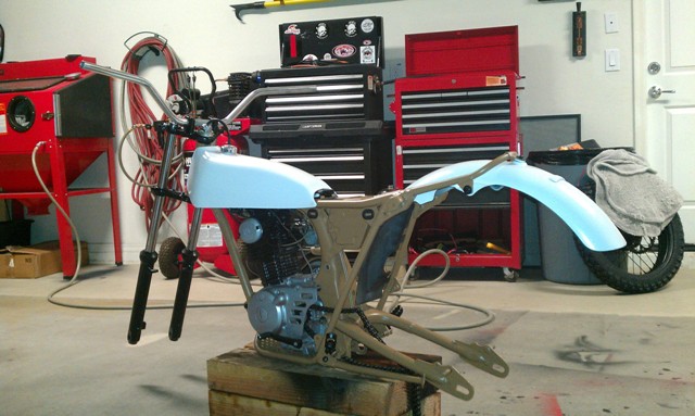

Got a little bit done today....
Blasted tank, painted tank, new fork seals, blasted and painted lowers, polished tubes. Painted rear fender to match tank. The gas tank does need some body work but for now I can live with it.
Mounted tires and ended up giving the rear tire a pinch flat in the tube. So, would have had those installed today as well if it weren't for my mess up.Put new rubber on the kick start and shift lever. Managed to scratch up my rims installing the tires too. >:(

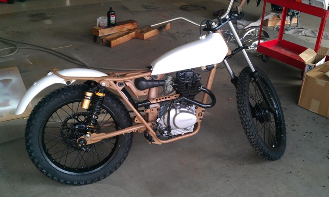

I got the wheels and tires on the bike. The Kenda tires look real cool. All I need is to locate a seat, muffler and put a throttle on and I think I am ready to go. If anyone has a resource for after market mufflers please let me know. I believe the pipe is only a 1 1/4" and the stock mufflers seem to be unobtainium!
I threw in the "before" pic just to show the difference.....

Is yours the model with alloy rims? What shocks are you using?

The shocks are cheapo ones off of ebay. My budget is real small on this bike. After all the searching around for a muffler, I may just have to go with a Sammy Miller kit.

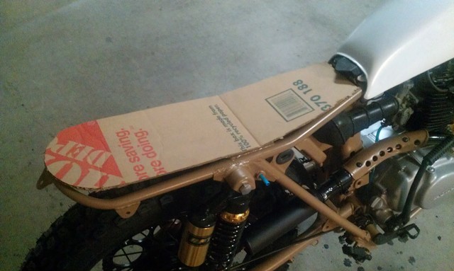

Decided to paint the handle bars the same color as the engine. The bike came with a "muffler in a bag". It has stamped on the side something about being certified with the US Forestry Service. Anyways, the muffler was all broken up inside. No packing or anything. I media blasted it, painted it and tried to put all the pieces back in with new packing the way I think it is supposed to go. Just waiting for new fuel line to come in as well as new throttle and then I will be good do go. I also took rear fender off and made a template for my seat pan. Looks like I am heading towards a "Tracker" look on this one. I have a 1/8" piece of aluminum sheet that I will be cutting out and shaping for the seat pan.

Made the seat pan today out of 5052 1/8" aluminum. Now I just need to figure out how I want to mount it.
