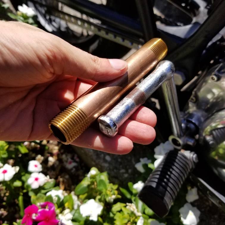

Found a brass pipe nipple, seams the right diameter to slip over the kicker if I chop the end nub off. Couple of fancy holes and drill and tap the end of the kick lever for a retaining bolt should be a nice touch
