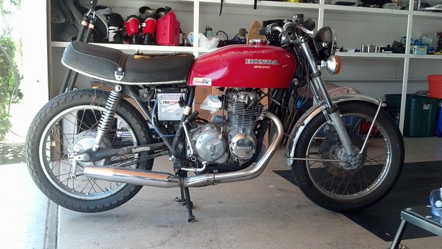

Im using that light, mounted directly to the bottom of the seat pan, with a modded plate bracket off like a 400t or something, and no hoop..looks pretty darn good..
Excuse the upholstery, it was a test run.
