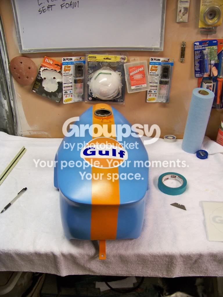

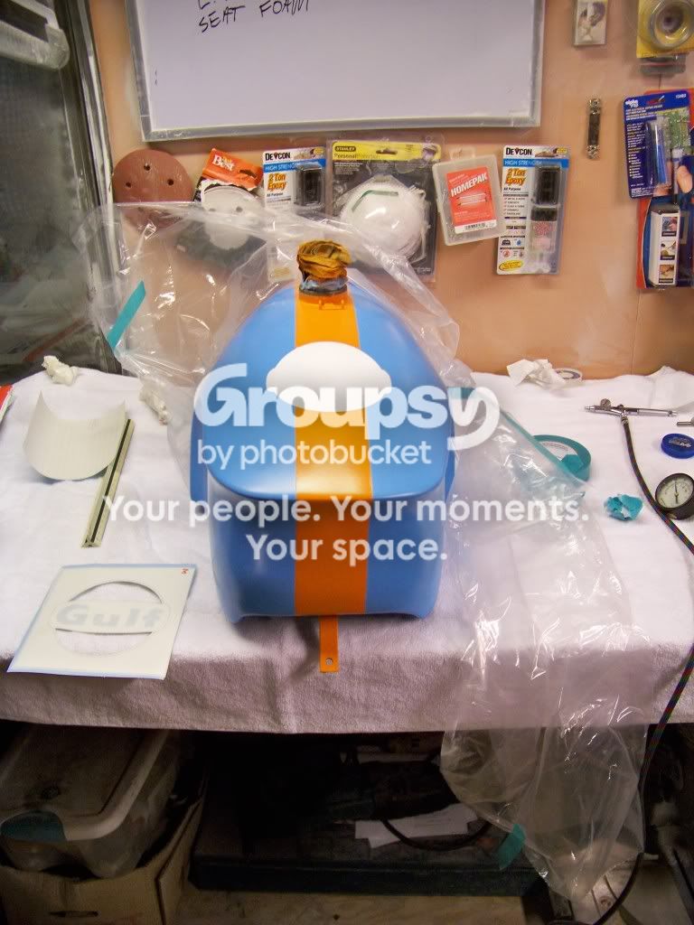

Here is a little blast from the past. I finally found out that I had saved these to my camera itself, not to the card. Here they are, from paint night!
A raw logo:
proud papa
High tech body shop fast-dry technique
In the raw
