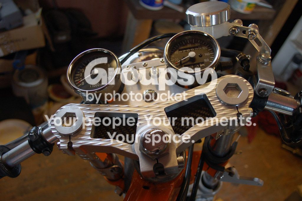

The top clamp arrived from Swagger today. Beautiful.
Re: '75 CB550K1 Gulf - carbon
Aw man, I'm so glad you dig it Chris! I kinda took the reins and ran with it so I'm pleased that you are pleased. As soon as you get around to it I'd love to see a similar view angle but on the bike. I think that'd be a nice pic for the blog header!

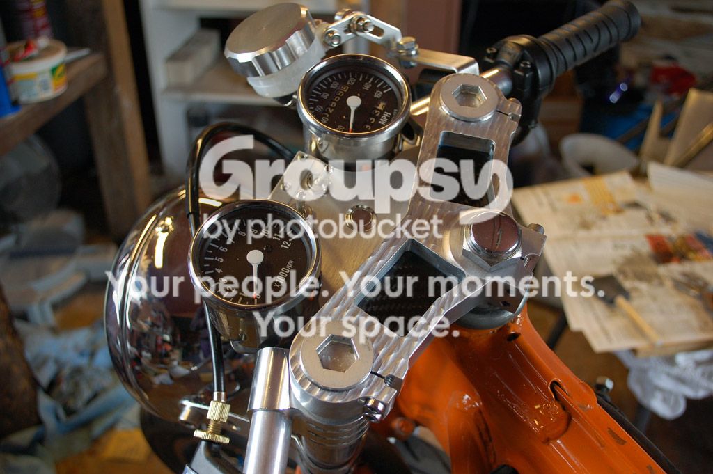

I got the clamp wrestled on last night. Levers polished, bracket for the MC reservoir made, and clip ons trimmed down 1".
Lee, I'll get a better pic for you without all that crap in the background...

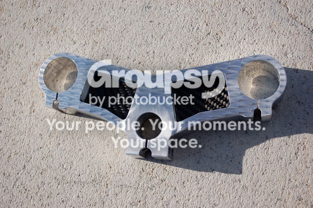

I think the pockets are to collect the envy-laden tears from fellow bikers at meet ups.
HAHAHA! You guys can make me smile on the shittiest of days!
@PJ: They were originally gonna be simple cut-outs to drop some of the massive weight of the original piece but I ran into some.....features, that begged for something to hide behind. Hence the inserts. I'd planned to epoxy them in place but these are just gooped in with RTV. It occurs though that they could be raised up closer to the upper surface with some simple spacers under them so change can be had.
...but yeah, this is the real reason; to collect the sweet nectar of human whinging.

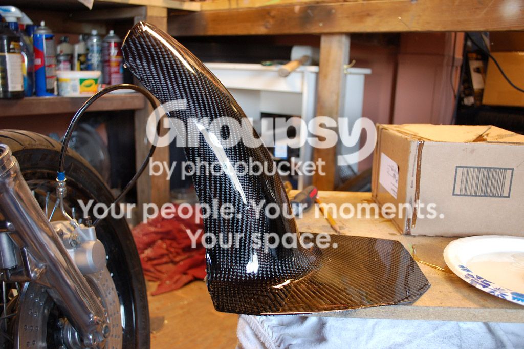

Well. The rear tire hugger is out of the mold and ready to be trimmed. This one gave me the biggest headache of the three carbon pieces. I misjudged my resin kick time and had to frantically finish laying the carbon about half way through. As such there were quite a few imperfections. I ended up giving it a skim coat of resin afterward to fill the pinholes. It will get sanded down and urethane clear coated.
Originally, I wasn't going to leave much exposed carbon on any of these pieces, but the more I look at it, the less I want to cover it. The front fender will get just a touch of blue paint, the rear none, and the belly pan will still get the same exposed pinstripe of carbon.
Re: '75 CB550K1 Gulf - last of the carbon
Oh my, that is beautiful. I love the look of carbon fibre, definitely have to leave some exposed.
Awesome looking piece Ringo. Raising the bar for sure.
