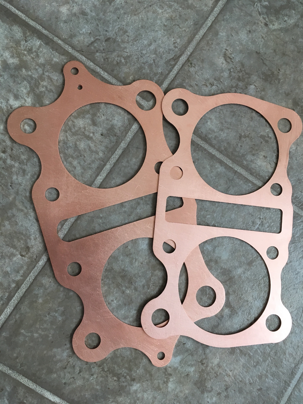

Got my copper gaskets from Lani today. Went with .063 head and .032 base, which brings it to .043 total clearance. .004 more than I’d like, but should be fine. Will put it all together (again) this week.
