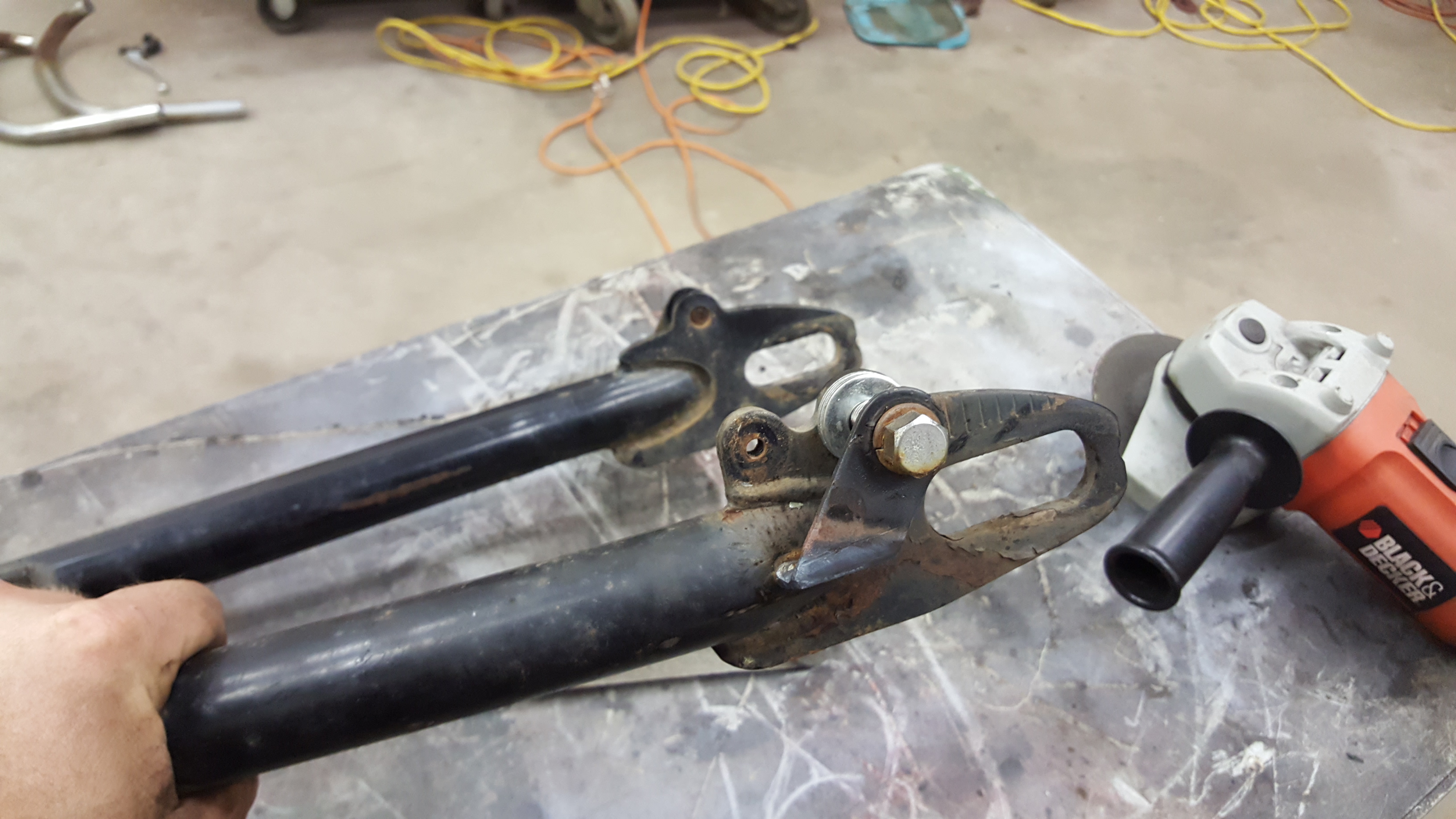

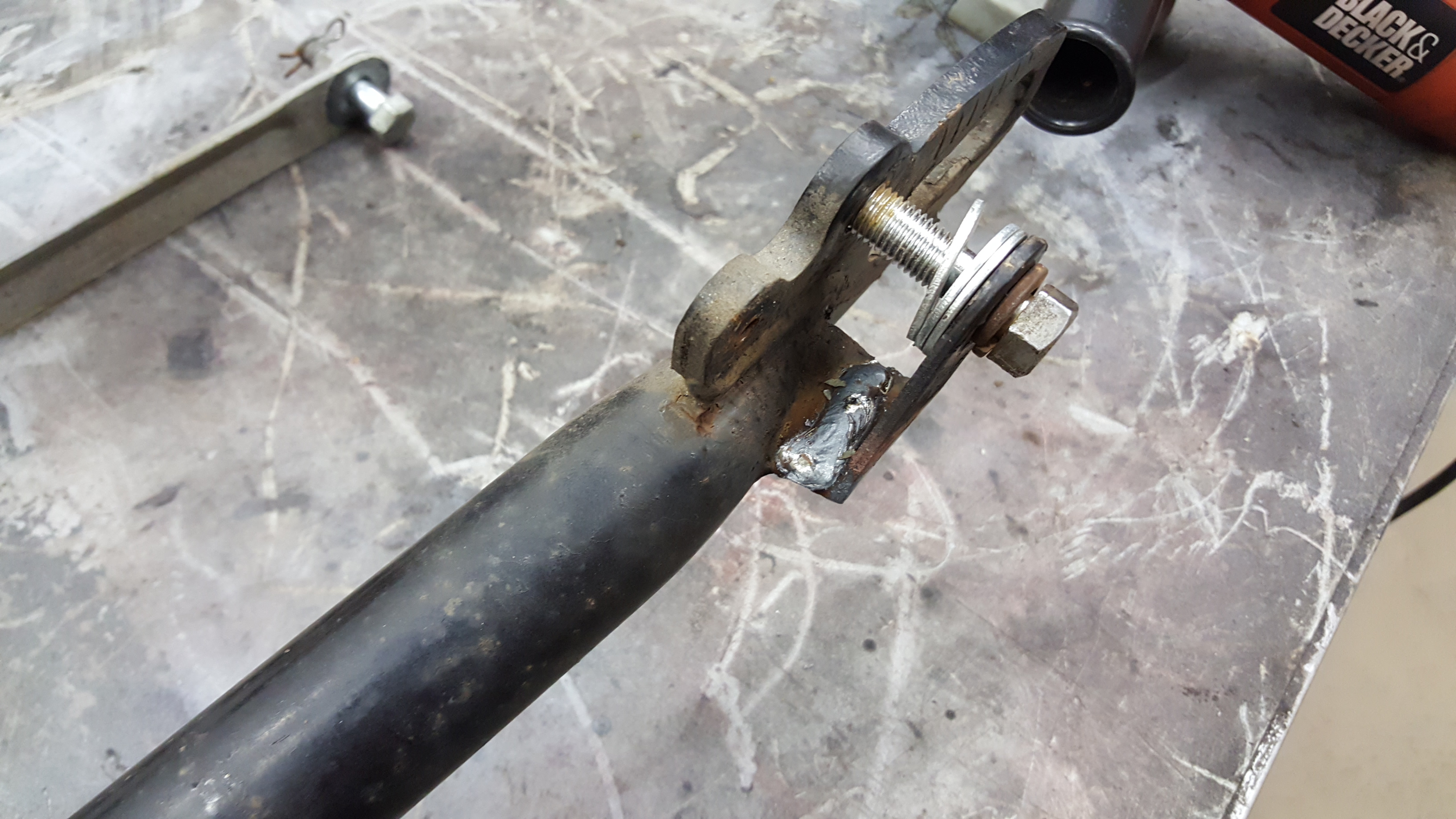

After the frame was stripped I started hacking off all the tabs.
I also hacked the right-side exhaust/passenger peg mount and trimmed it down. No passengers on this ride!
Then I widened the left-side swing-arm mount for the shock... had to space the wider shocks away from the chain a bit.

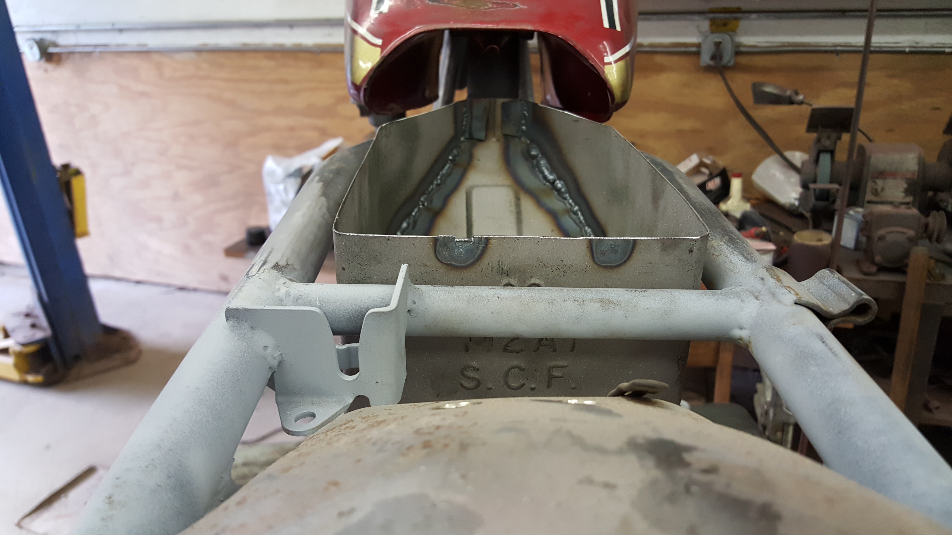

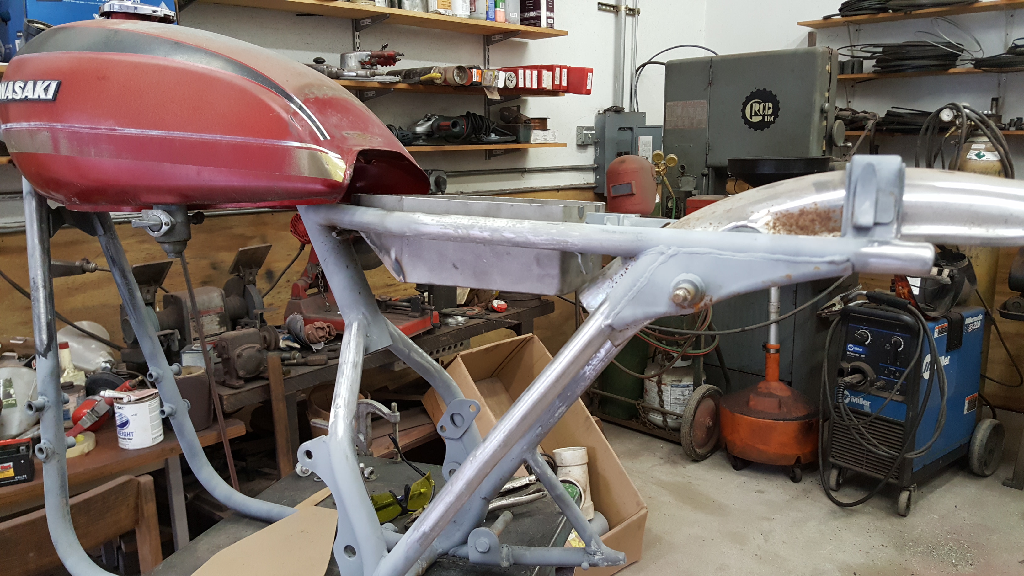

I picked up an ammo box from a local army surplus. Took to hacking it up, and making a couple brackets for it to fit as a new battery box. Didn't come out too bad as a first attempt. Also worked out re-locating the rear fender. I really like this line.
As you can see, trying to keep as many stock parts as possible on this bike.

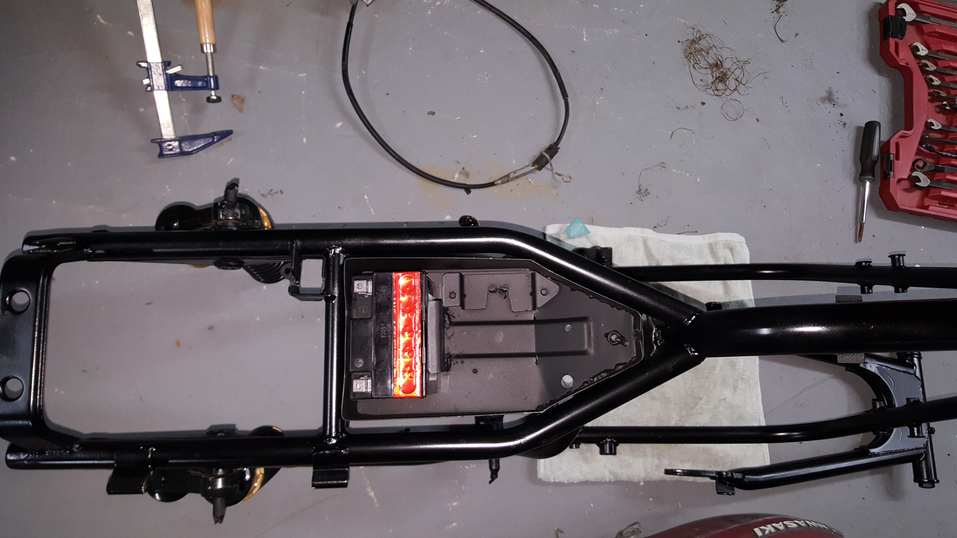

Took a weekend and painted everything up! You can see inside the battery box how I hacked the mount for the regulator off the original box and welded it to the bottom. Also welded in a place to mount the battery to and the starter solenoid.
Everything painted up nice! The battery box is just in flat primer to prevent rust. It will still need some fixes. You can also see the new shocks... $59 on ebay... can't complain.

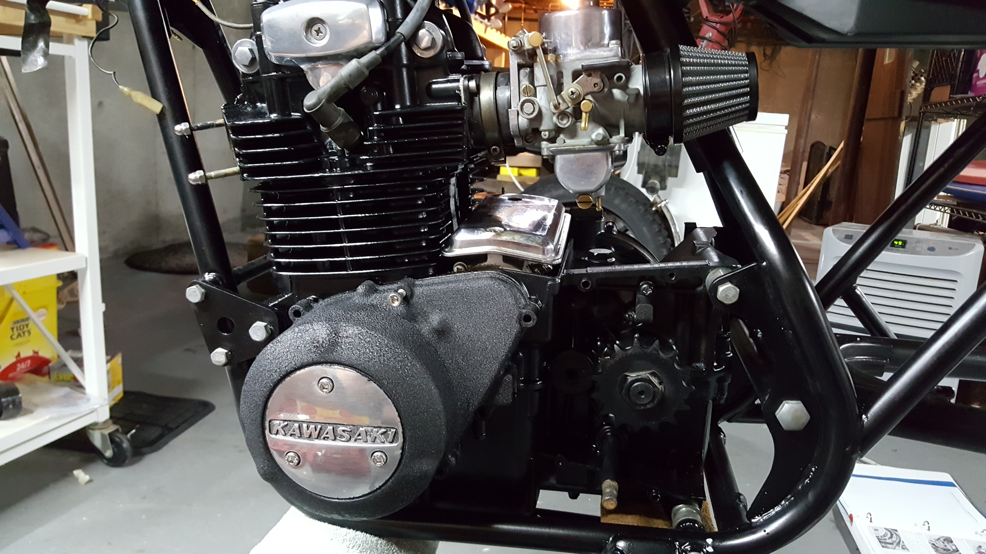

Got the engine back in and started POLISHING! Timing covers, valve adjustment covers, and the letters on the cases are the ONLY parts being polished... thank God. Nearly killed myself doing all the polishing on the GS750 a few years back... will NOT do that again.
This time around... WRINKLE finish everywhere!
Also, new tires came in. Kenda K270's... 3.50 x 18. Should do the trick.

DannyMotor said:
also got in some cheap shocks, need to space them away from the chain... so I added about 3/16 of material into the lower mount on the swing arm.
You need a bolt with a longer shoulder so it goes through the eye of the shock. Using that bolt with the thread will eat away at the shock rubber.

As for the lower shock bolt, the shocks have a steel bushing that goes between the rubber bushing and the bolt... so no worries about shredded rubber! I may need to get a LONGER bolt, however, as only 3 or 4 threads will bite now that I've extended it.

The wrinkle looks nice - what brand paint did you use for that?
Is that a Kz400 seat? I picked one up that looks almost exactly the same from a salvage yard not too long ago, but I have no idea what its from, except that its a Kawasaki.
Re: 75' KZ400
Yup, that's the stock KZ400D seat, I think the S had a strap across it.
I used VHT Super Wrinkle or Wrinkle Plus (can't remember)... but you have to do three medium coats and wait 5 minutes between coats... if you put it on too thin or let it dry too fast it won't wrinkle up.

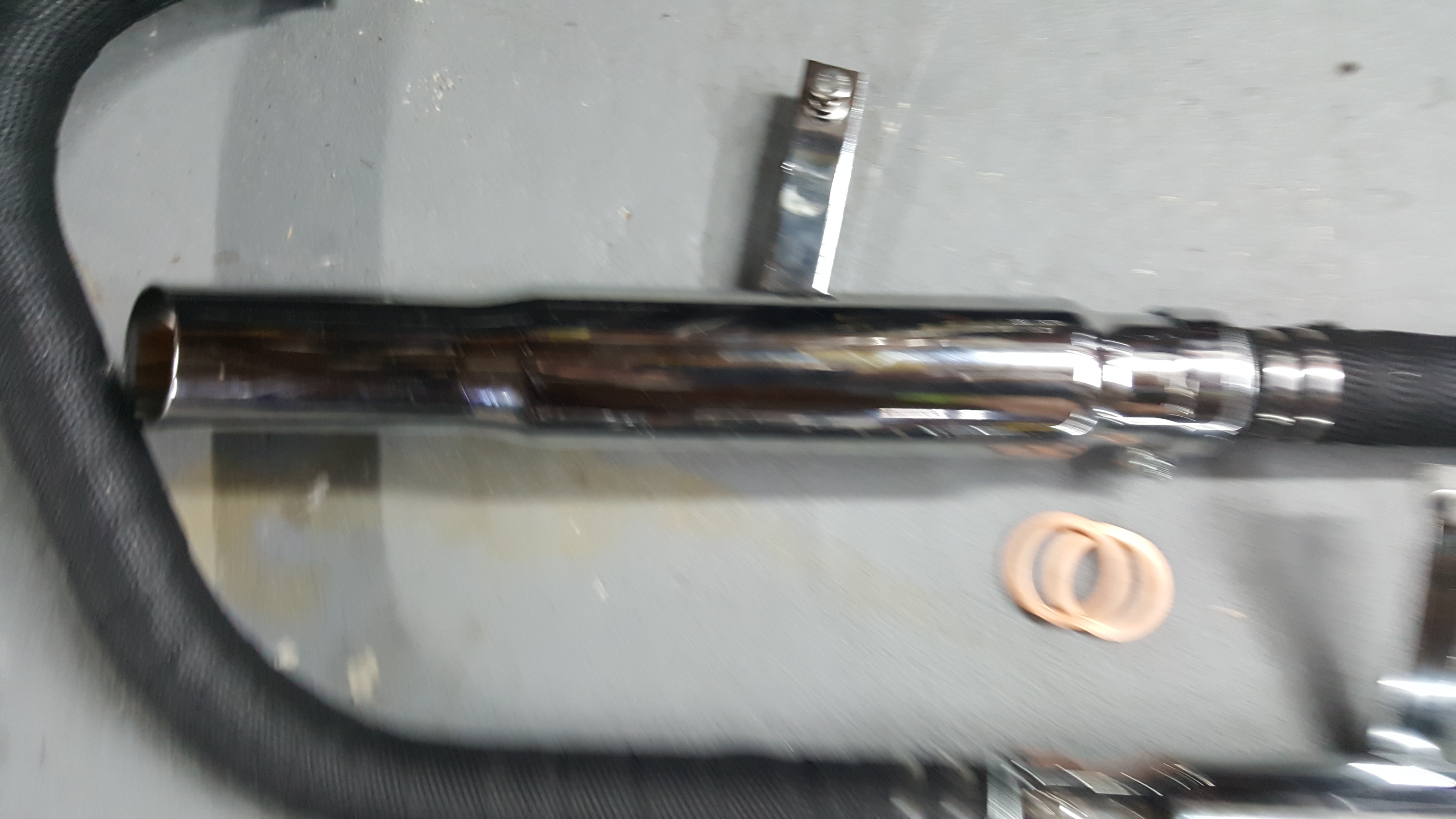

I also got around to wrapping the down-tubes for the exhaust. Just have to polish up the clamp rings, which should be done tonight. More pictures tomorrow!
