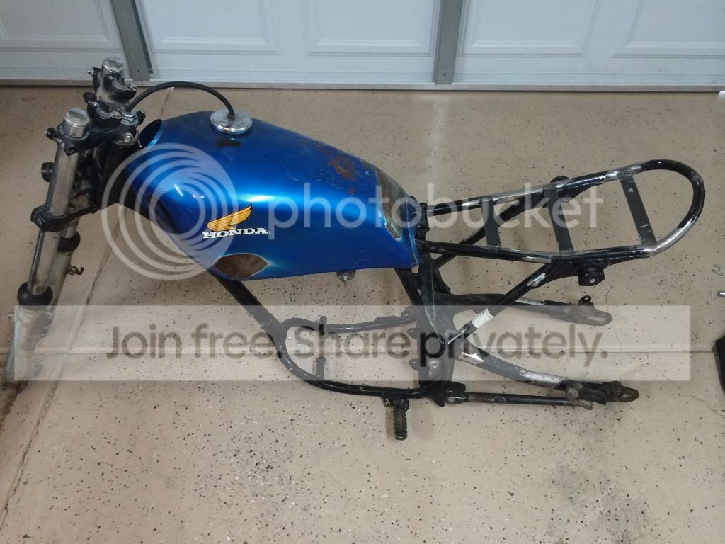

Hello everyone, I'm finally building a thread for my xl250. It all started when I saw the xl285 from pipeburn and fell in love. I have been wanting to build a bike for a long time but I'm finally getting to it! I picked up this 76 xl250 from a guy in Phoenix AZ for only $450. So here she is when I bought it (about 2 months ago)
First things first, stripped it down!
Fully stripped!

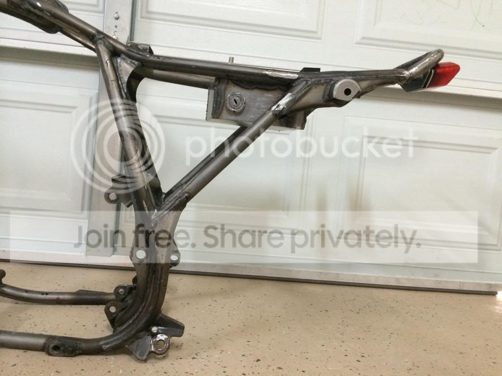

Modified and de-tabed frame

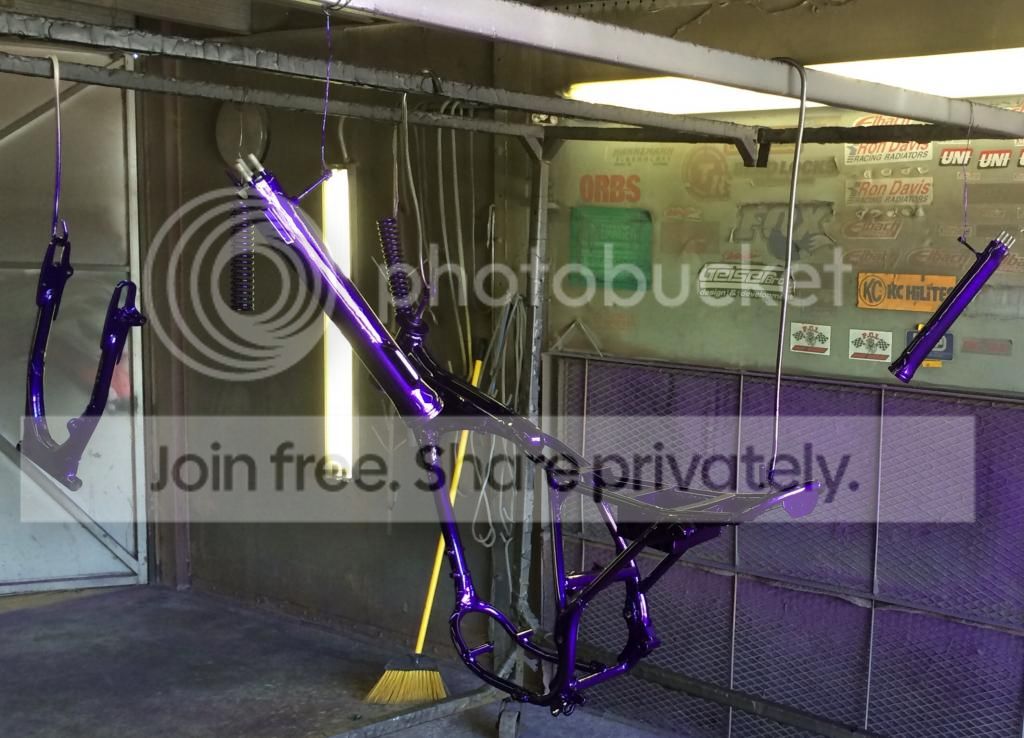

Just picked up the frame and part from powder coating! The in engine is still being built for the next week or 2! I'm trying to get it done this month but we will see.
There will be more pictures as I continue this built

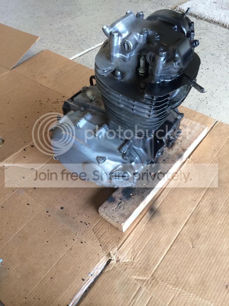

I painted the engine after hours of cleaning
