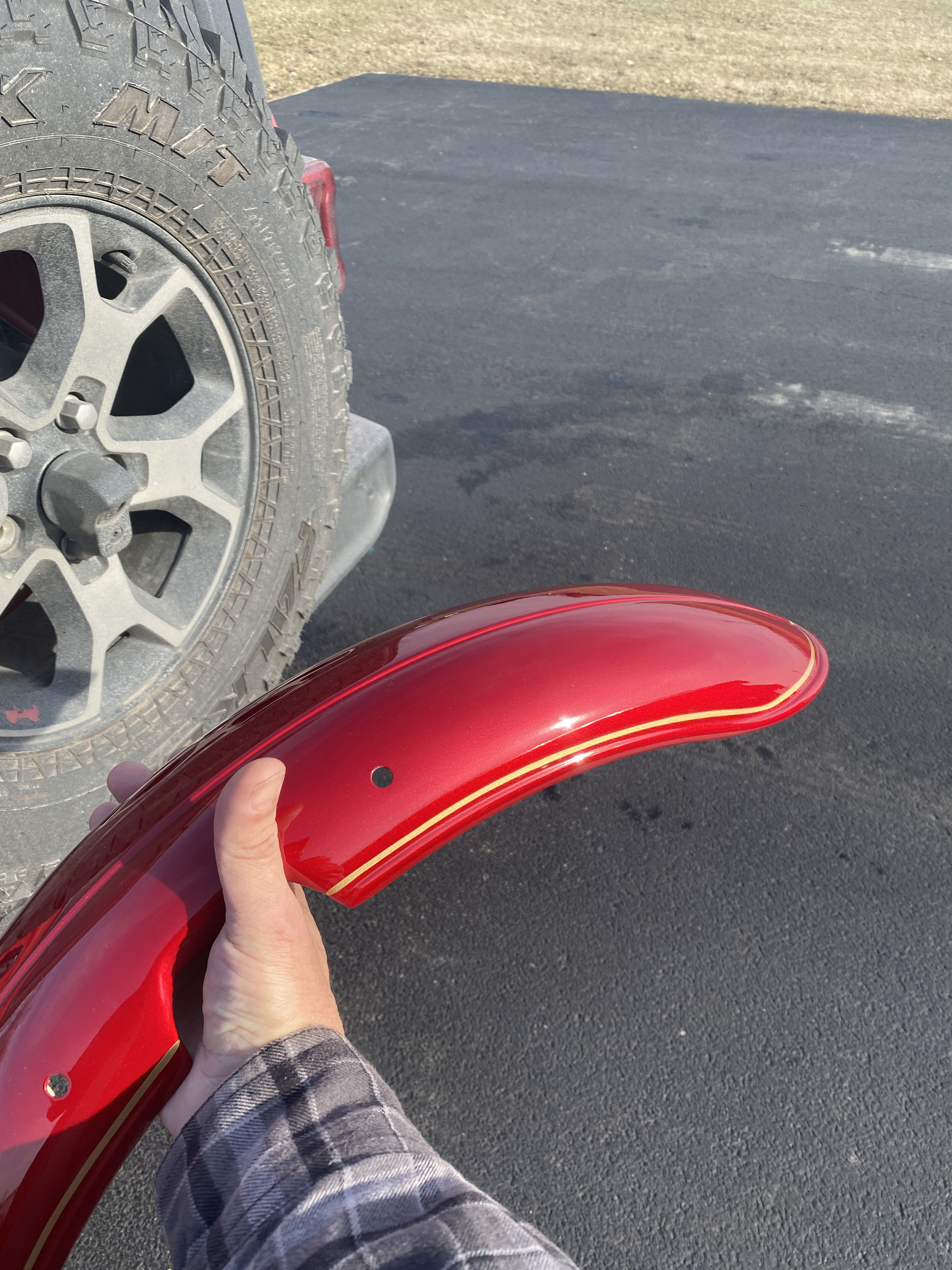

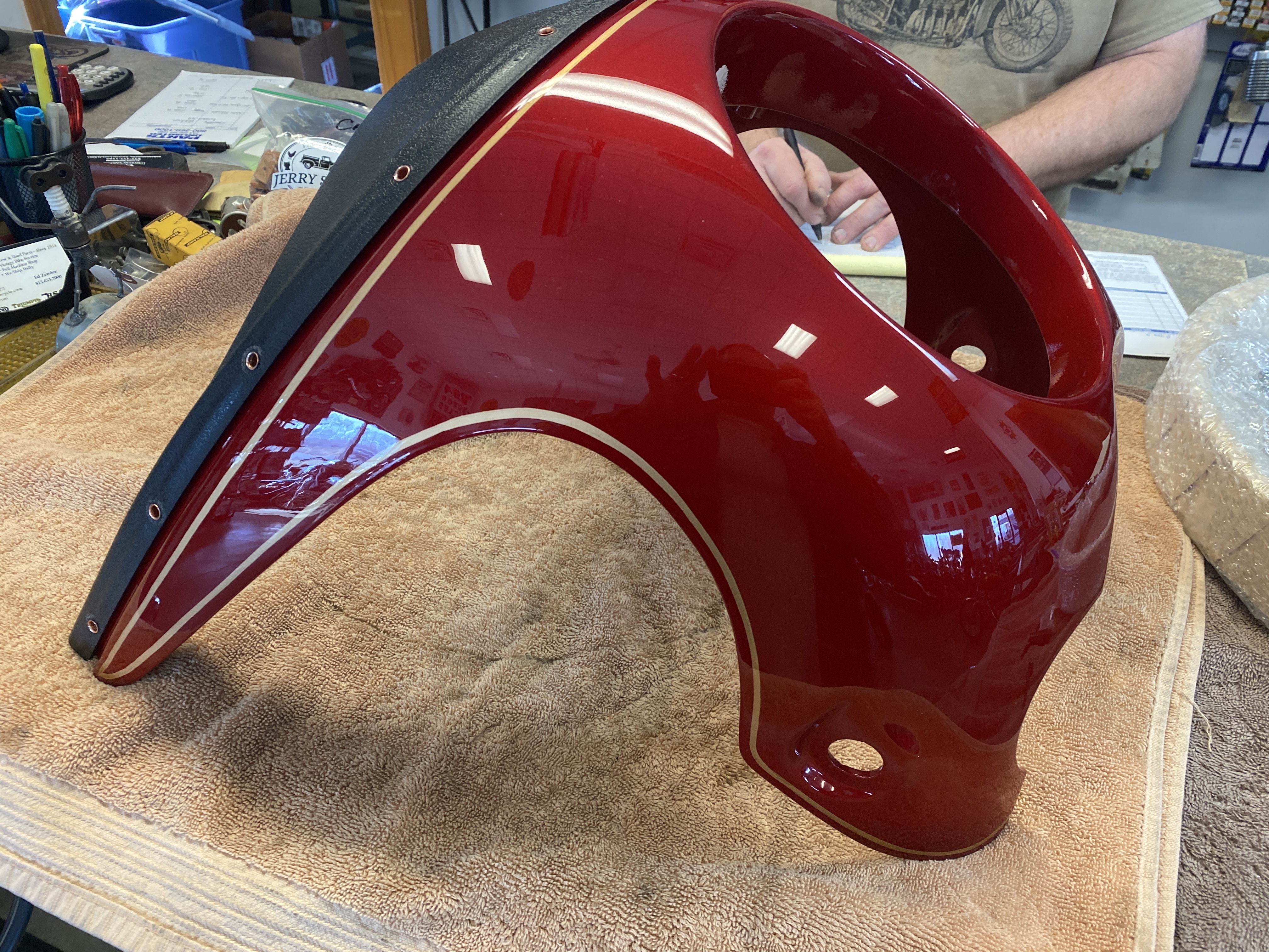

On my way home from picking up the paint work... it turned out beautiful. I’ll post pics of the rest after I get home
I got the front fender mounted up. I’m also swapping in all the bolts I can get to with stainless bolts and nuts from “The Bolt Guy” very nice and complete kit they put together.
