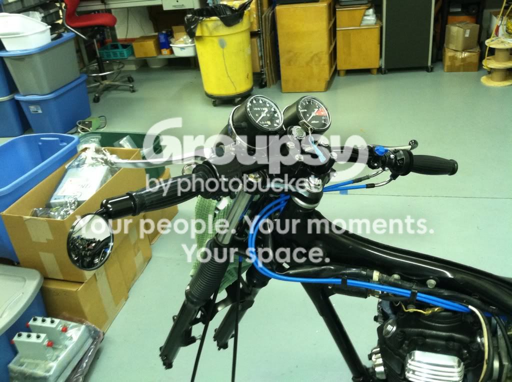

I painted the covers with help from my girlfriend. Got the wiring mostly finished; the horn doesn't work though, and I don't know why. I feel like the button isn't making a connection, but whatever, I'll figure it out sooner or later. I also said whatever to my stock muffler. I got one off of DCC and had to weld on a new adapter to fit. 2 bucks and 50 cents later at auto zone and I had the right size. I also tried my mirrors, which I immediately thought looked ridiculous. So also thanks to a tip, dime city also came to my rescue there. In, the mail. Here are some pictures.
lil paint
new exhaust.
Ugly mirrors on drag bars... must save for later date
oh yeah the whole light in blue headlight tint was wayyyy too blue when i turned it on; so i definitely stole the stripe-age idea from milehigh's 450. his is in yellow and looks way sick so i ripped it off bad, sorry man. :D

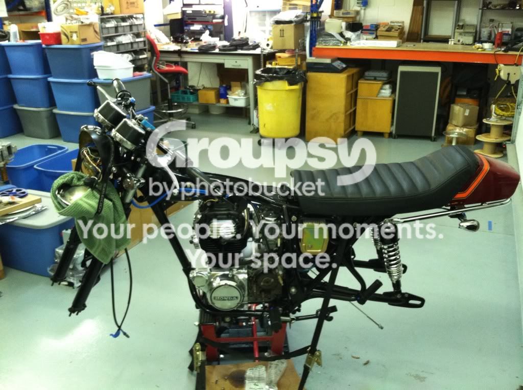

Here are some more pictures of what has been getting done.
rear wheel, on. waiting on new brake pads for front brake and a new chain.

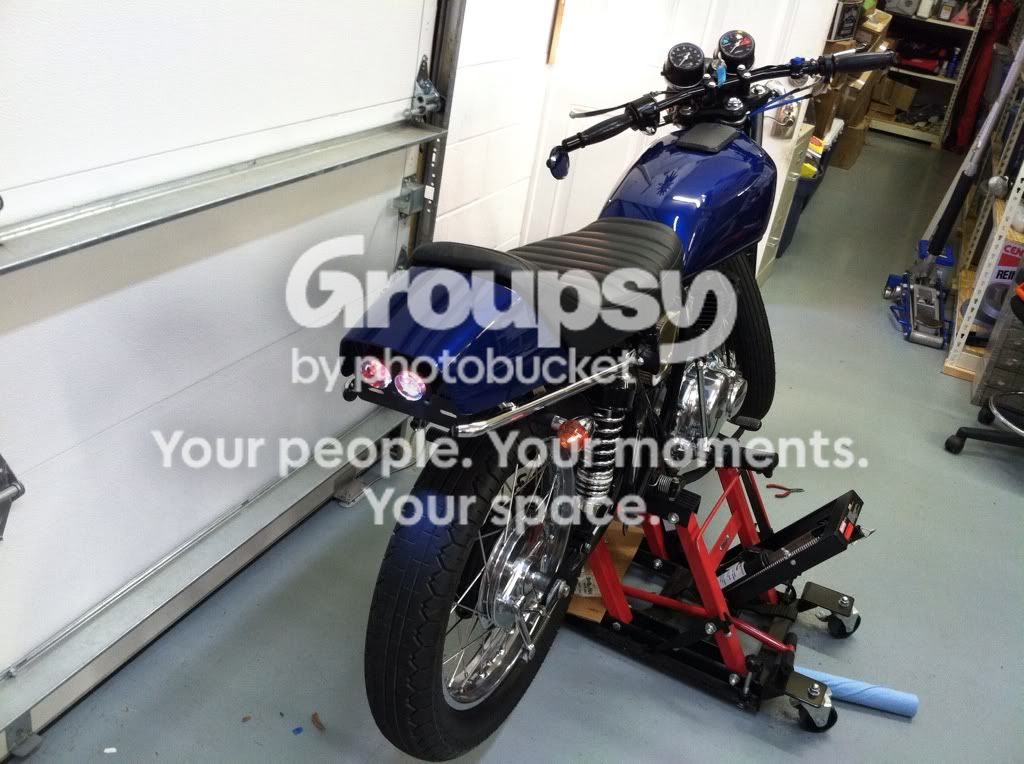

thanks for kind words dudes. its all coming together, and finally starting to look like it. the tank and cowl are back from painting and I set them up for some shots. i love that blue, it turned out reallllly nice. ;D the front wheel goes on tomorrow. and we'll be rolling....
Wow, very pretty blue that happens to be around my favorite color of blue. My bike is not to far off from that. 8) You are about about done looks like bro.
