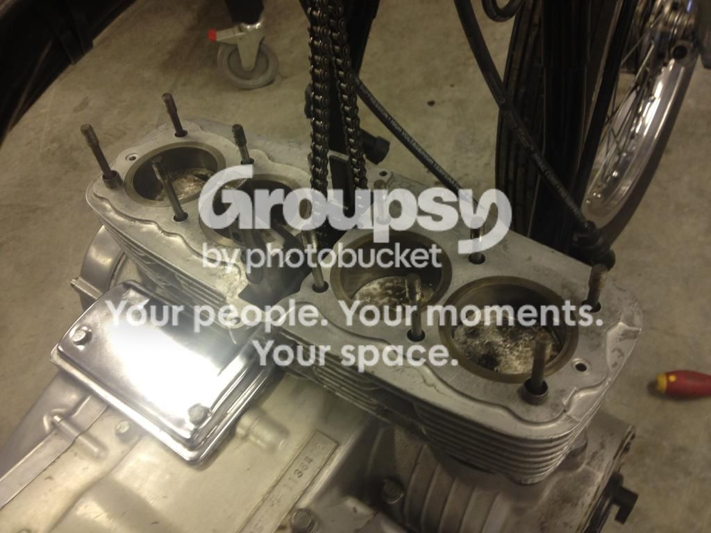

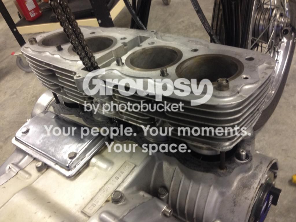

I found a 592 kit(Henry Abe), with cylinders..... But the cylinder block was from a CB500!
The cylinder walls are pretty thin, and the OD of the sleeve is thinner than The CB550's. Was the sleeves in the H.A. kit of a smaller diameter than the standard 550? Or is this a case of overbored 500 standard cylinders?
My CB550 sleeves OD
The CB500 sleeves OD. Is this to thin or is this the sleeves from the H.A. Kit and ok?
Hope someone can help me? Thanks!

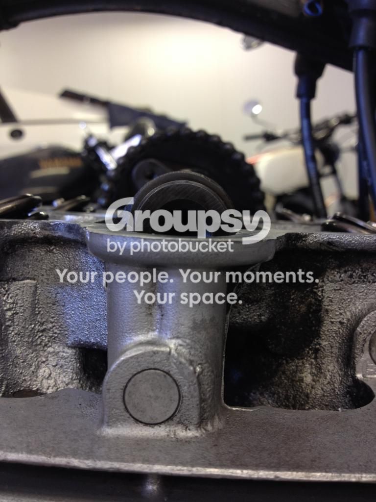

I did not stop there!
650 cam in place!

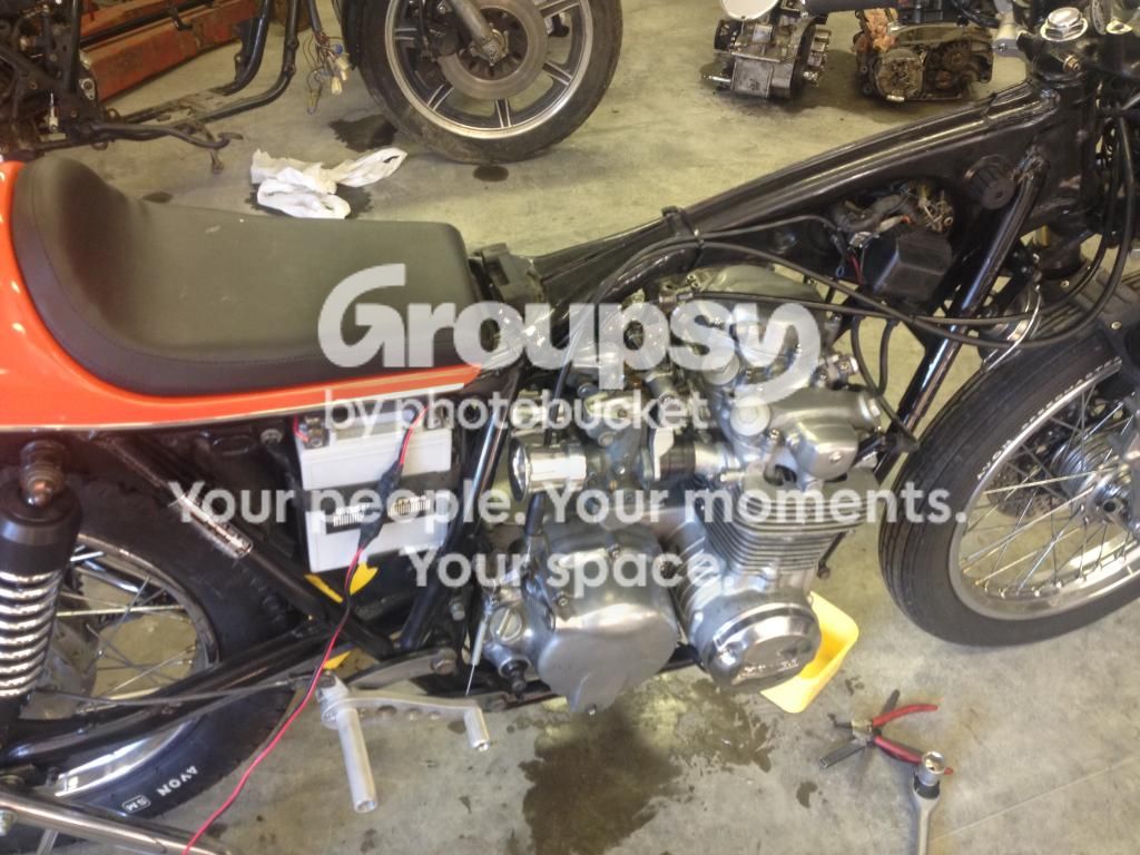

New clutch!
Opened the carbs to adjust the needle, was set on the top position....... I moved it to the middle position.
The carbs installed.
Exhaust an tank in place!
Tomorrow I will attempt to start it up.... :)
