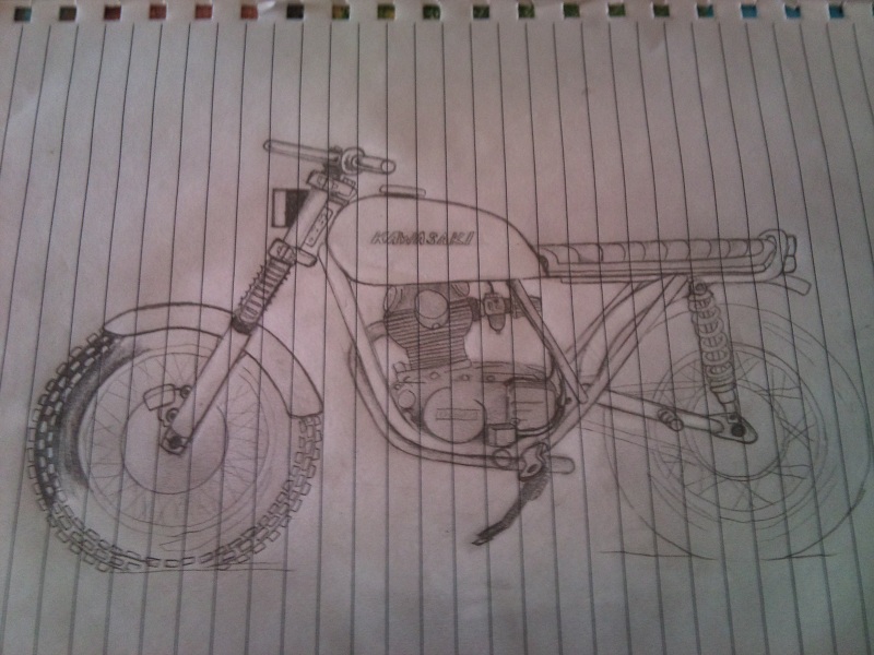

And here is a quick sketch on how I want her to look, Some of the mods will include
Larger rear shocks
Larger aggressive tires
Custom aluminum seat pan
Front rack
Rear rack
Rubber fork boots
Twin headlights
Custom handle bar paddle shifter
Tail light and blinkers (tucked in under rear rack)
Hidden wiring harness
Air pod
I think I got it all...

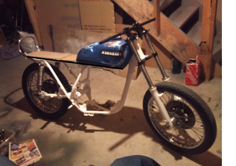

:D Hello. I am Dat. I am from Viet Nam. I am 24. Can you help me about some problems?
Can you help me how to make the bike in the direction parallel to the ground as the two shown below

Hi, Dat. I guess I just got lucky with my kz200. The way I would level my bike would be by lowering the front end,by loosening the fork tube bolts and sliding the forks up a little at a time. The other would be trying out some different size shocks on the back end. I hope that helps.
