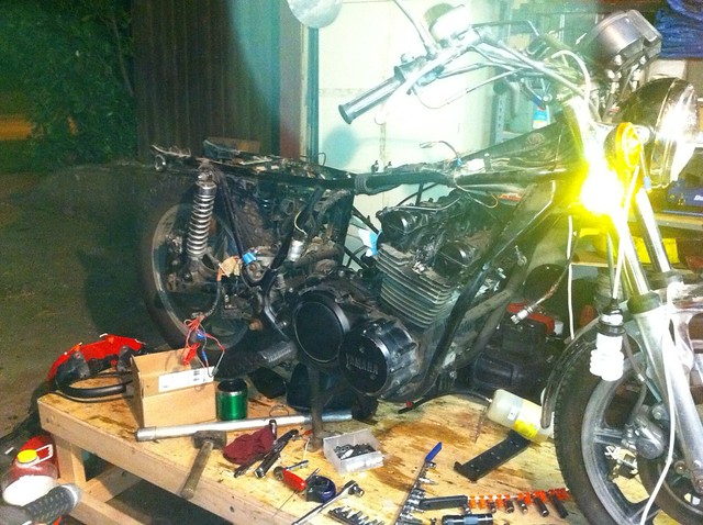

Made a little progress on the disassembly tonight.
Pipe, rear pegs, tail section, carbs all off.
Started to remove the wiring loom and rear wheel but its late and I decided to call it a night instead of breaking something.
I've got too many irons in the fire, but I'm still chipping away at it.
Got the rear wheel off, the spline and gear look in really good shape!
Removed that ugly ass battery box (right in the bin) and got the rear half of the wiring harness off.
Caliper ready to be removed with the rear master cylinder and ready to be rebuilt.

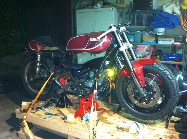

Finally, a litte bit of progress. Well at least some photos.
Since I got the engine out, its easy to move the frame around and mock up some lines so I slapped the forks on, no bearings in yet, and threw the weeks and tank on it. This is what I've got so far:
Both tire are the same width, 120, but the front, on the wider and smaller R1 rim dwarfs the rear, skinny looking tire. I may have to try a Kenda 130/80 18 to get the look I am after.
You can really see it here.
Also, the shinko tire is taller than the normal road tire that would be on the R1 and there isn't enough clearance on the fender so I'll either have to grind off the mounts on the forks or work up some slick hidden bracket to lift the fender up a little bit. I'd only need 1/4" really
I'm planning on using the original yamaha tail section in the cafe seat.
What do you think:

I'm also planning on a smaller batter, and relocated electrics to keep the fram as open as I can. There will probably be 1" - 3/4" of an inch visible of a box holding the electrics under the seat. Otherwise, I'd like to keep the center of the frame pretty much open.
Thats all for now. I'll need to do some grinding and cutting before I get to far down the seat layout, just to make sure I have a good idea of how I can attache a the seat.
Looks Good....I'd say keep it a lil longer, short and stubby is cool too. It depends on how tall you are I guess
