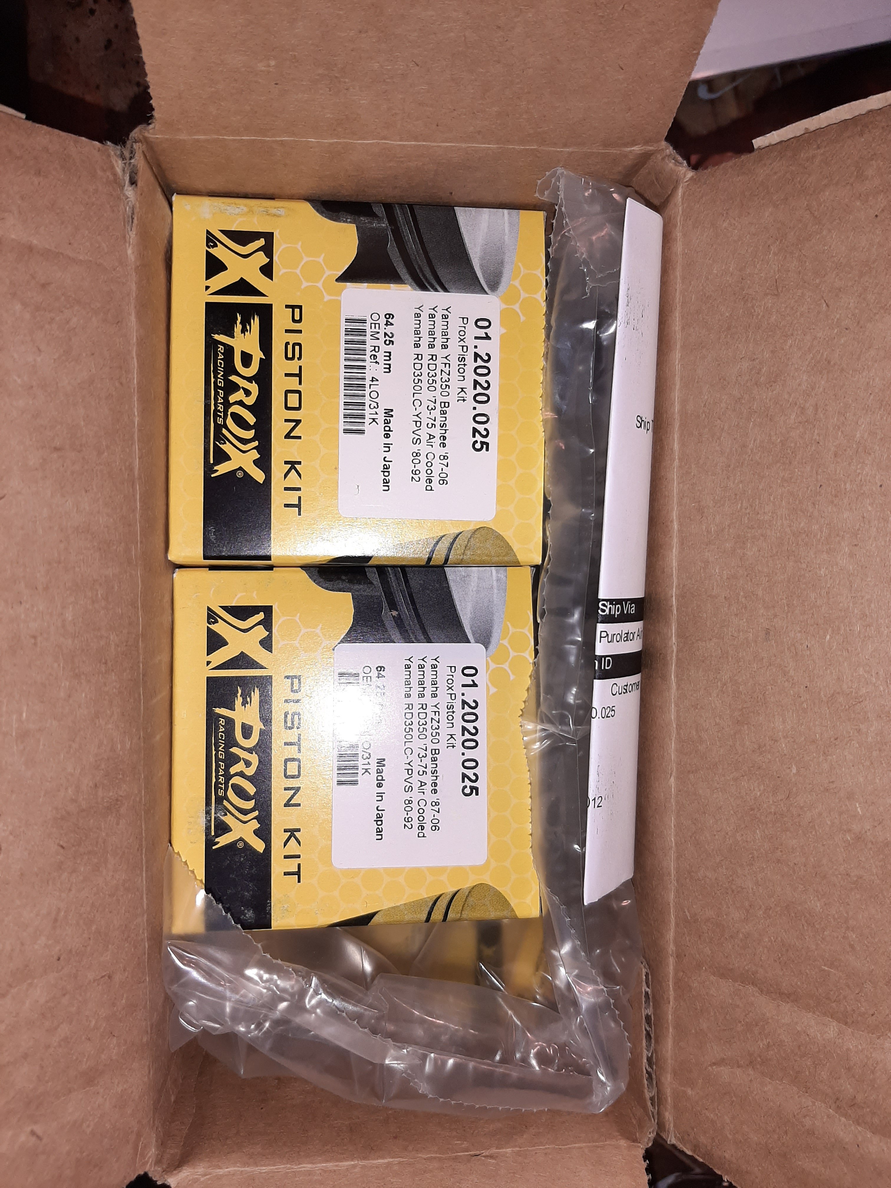

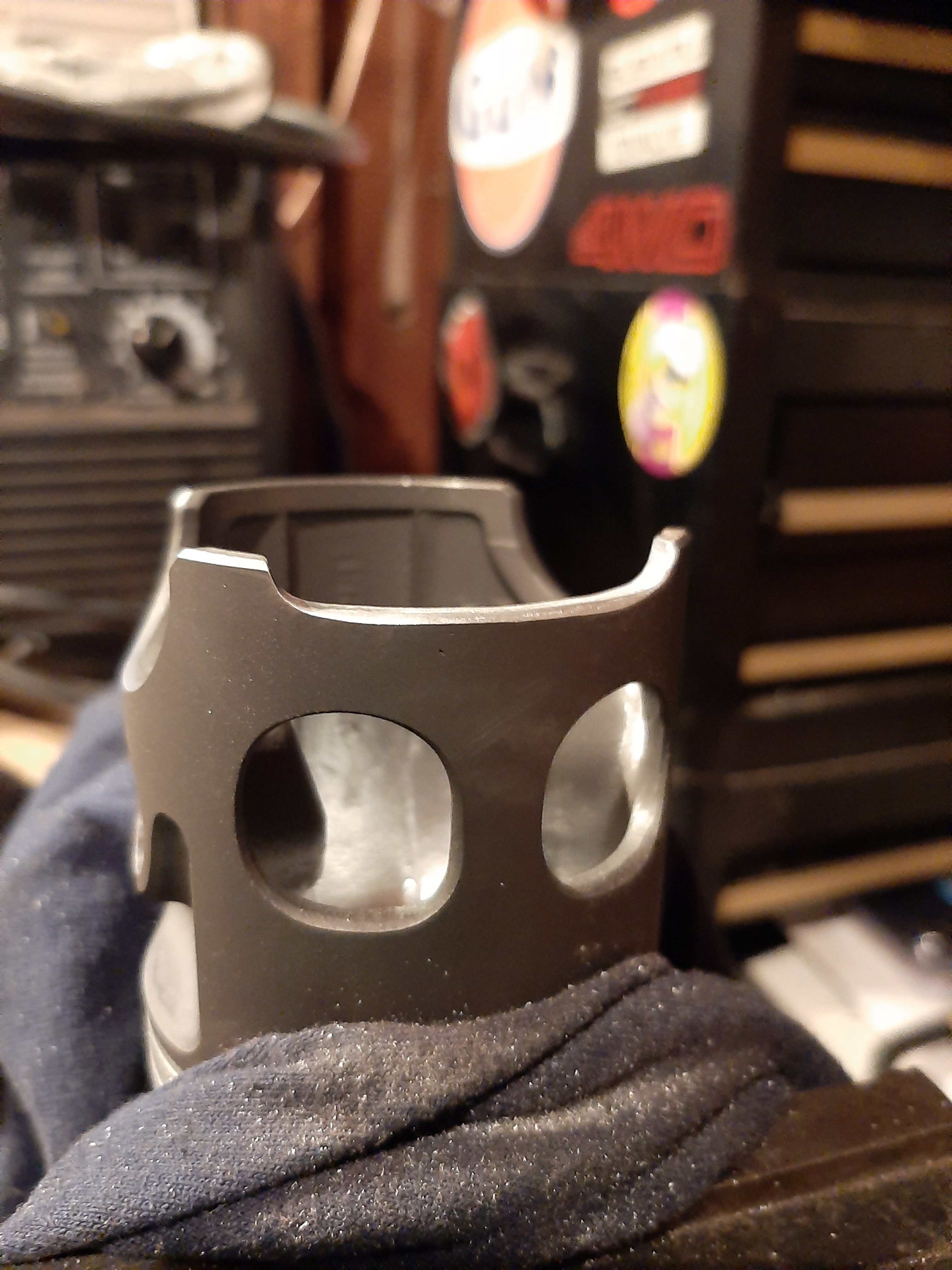

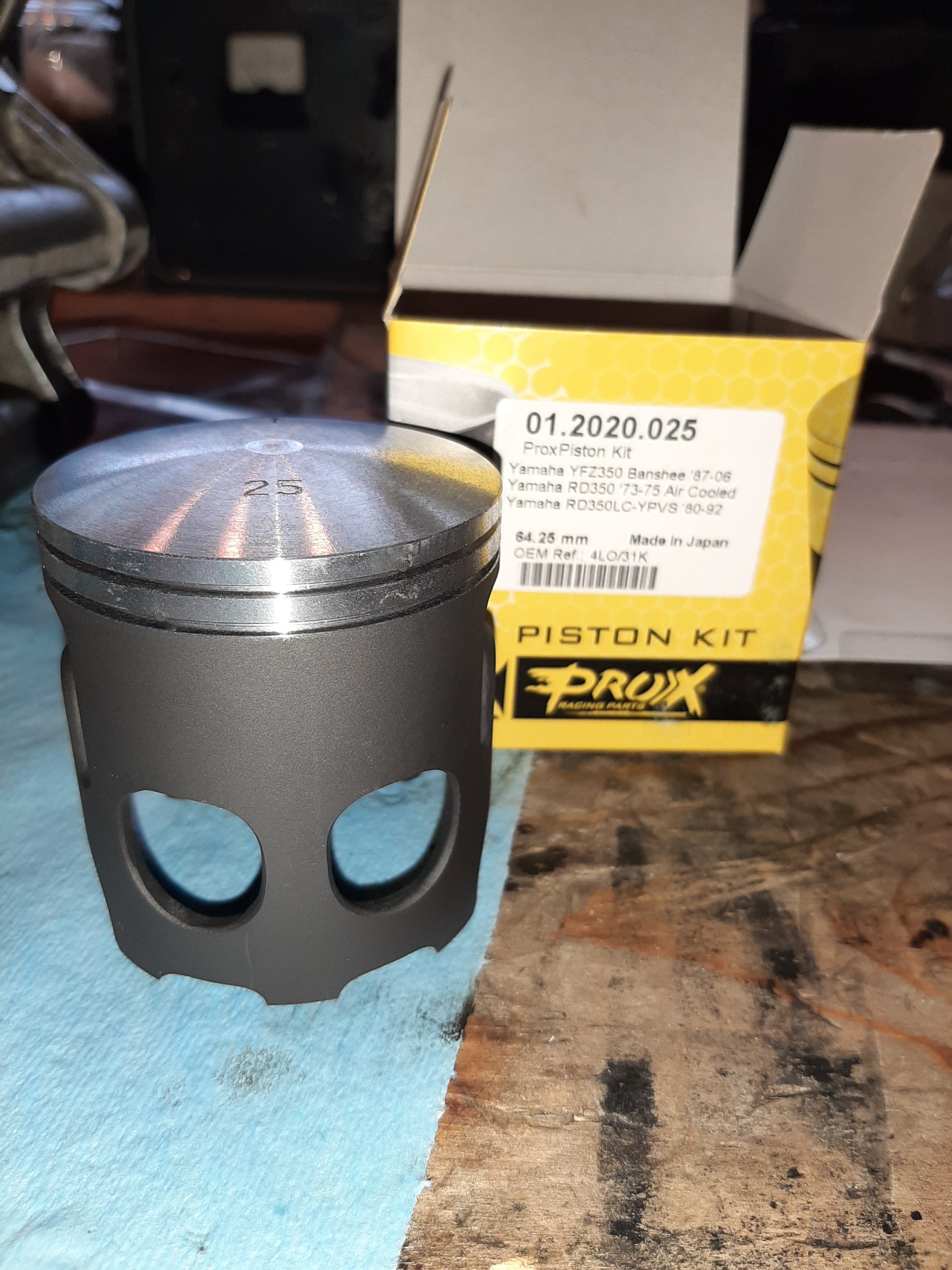

I'm going to do a little write up on how I modified Banshee pistons to work with the RD. There are many places online where you can order pistons for the RD, you will notice in most that you can add a $20-ish modification. It's where they take a water cooled RZ or Banshee piston and modify it to work with the air cooled RD. Without the mod the pistons can interfere with cylinder porting and cause all kinds of mean, nasty, ugly things to happen. My main reasoning for choosing this method came down to cost and availability here in Nova Scotia especially during COVID, however there were some technical points to look at as well. RD pistons are worth their weight in gold and generally only come in .5 step sizes. I only wanted to go up .25 and Banshee pistons come in every imaginable step at a reasonable price. Another thing to consider is that these are water cooled pistons going into an air cooled motor, you'll have to make your own choice between cast and forged pistons based on how much and how fast your expecting them to expand. This may also change how much clearance you machine for, just food for thought. I used a hand file to remove the tabs off the bottom of the skirts, it only took around 10 min a side, just take your time and go slow. Before I started and once completed I weighed my pistons on a Canadian. . . "Piston Scale"... that will measure grams very closely. This is something I would consider an optional step. In my case they were still within the range of difference that I got them from the factory, so it was good enough for me. Pics below, any questions feel free to ask.

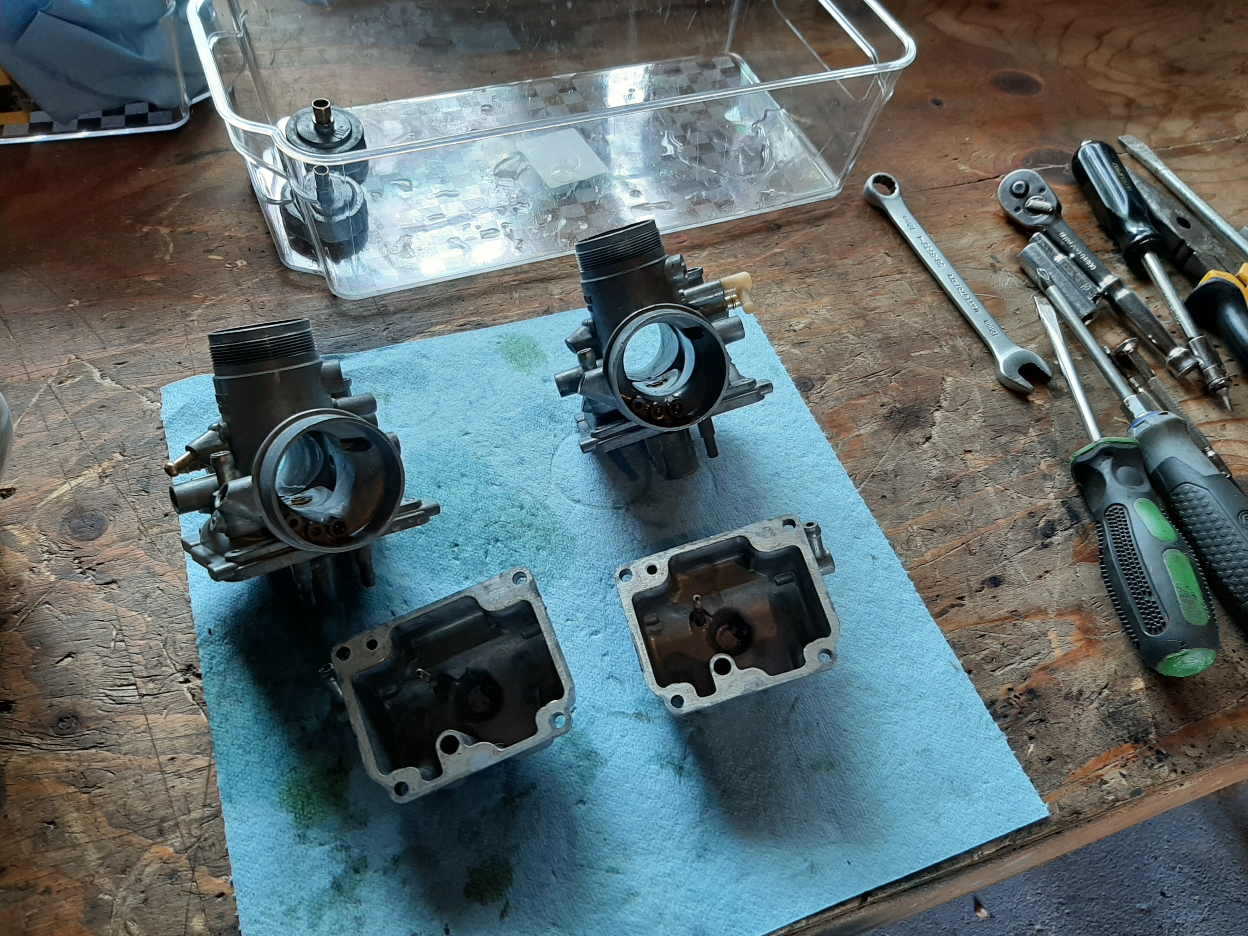

With how busy I've been it's been hard to find time to add to the build thread. I've made significant advancements on the build, and I'm feeling motivated today so here's some pics of the carbs disassembled and the kit I used to clean them generously donated by a friendly neighbor. The reason I went with foam pod filters is that I've heard the RD's don't like anything with a backing plate. Like you'd see with a K&N style that includes a chrome back plate. I read something a few years back about it causing turbulence in the carbs and I don't want to set myself up for that headache. If anyone on here can confirm or deny that, I'd be curious.

I can't confirm or deny the backing plate but I can say a lot of folks I know with RD'd use Uni-Foam filters exclusively so there must be something to it.
