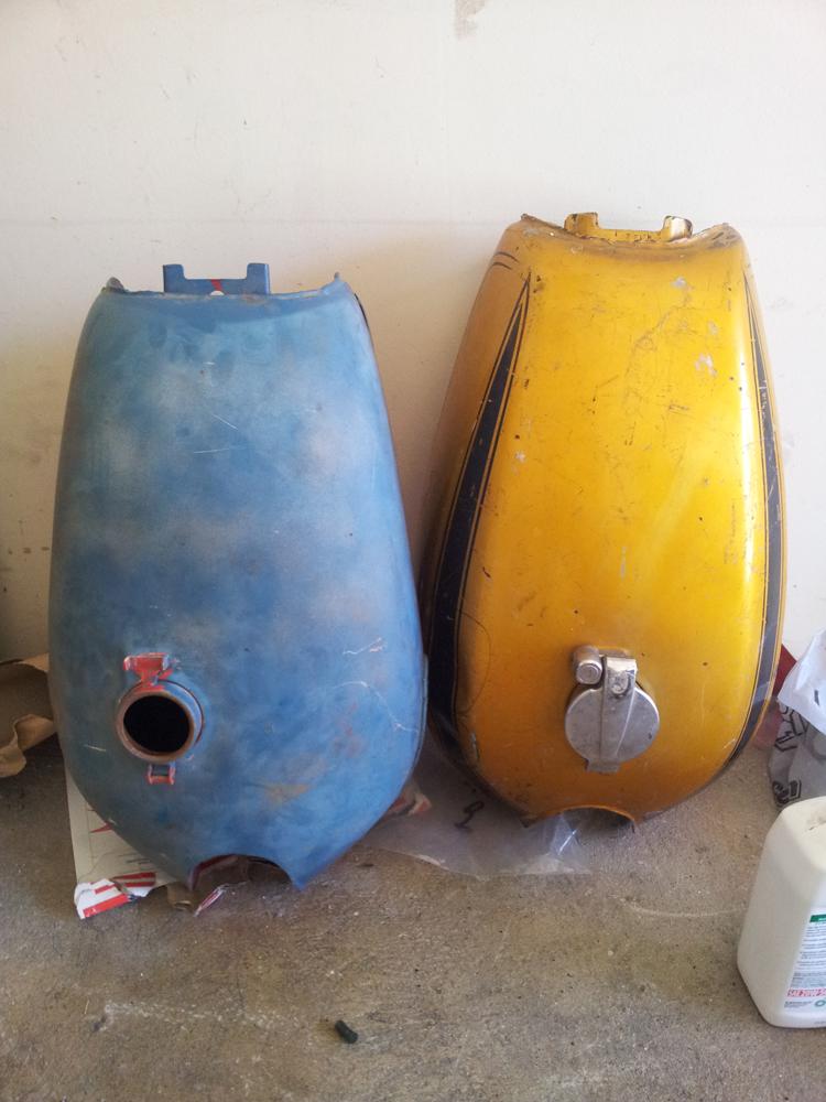

I picked up an early 70's CB350 and a CB450 tank. The 450 fit the frame better, but it just seemed too big for the build. The 350 tank didn't fit at all! I had to modify (aka bang the shit out of it) to get it to fit over that weird "hump" in the center tube. The mid and early frames on these CBs were beautiful...why the hell did they change them in '78? Was it cheaper? Did they use less metal? Lighter? I don't get it...

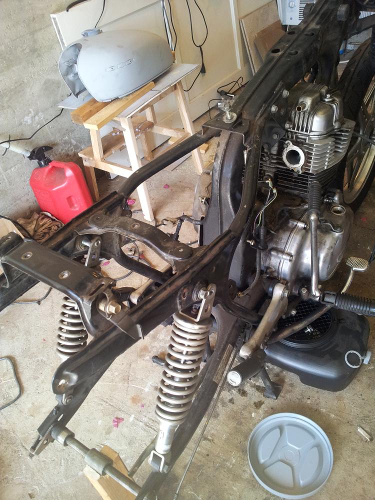

Here is were I stand today. I hacked off that hideous ass-end and welded on my "custom" loop. I ordered some straight DOM tubing on Ebay. I made a bending "jig" out of particle board and heated and bent the straight tubing around the jig using my Oxy-Acetylene setup. The fact that you can bend AND weld with a torch setup is why it's my favorite. And, its way more fun to do than stick or mig.
I used the "slug" technique to connect the old tubing with the new. It feels stronger than the original. Here's an explination if your interested: http://dirtygursmetric.blogspot.com/2012/04/slugging-bout-damn-time.html
Any thoughts on the loop? I'm concerned that its a little low, but I tried to follow the line of the bottom of the tank. It's hard to tell at this point. I'm expecting to have to get taller rear shocks to match up with the new loop.
Still need to fab and weld the braces from the lower frame...

Looks good so far and it allows you to make 2 more improvements. First, you can replace those ugly, inefficient curved tubes that run from the swingarm pivot to the upper shock mount with straight pieces of tubing. It will be stronger, lighter and as a bonus, look better. Second, you can replace the upper shock mount with a stud and do away with the double clevis type shocks. That will give you a much better selection of available rear shocks. Since you have it apart and have the torch and skills, I would replace the lower shock mount with a U channel with 3 mounting lower bolt holes so you can use eye to eye shocks and have some adjustment for length and angle built in.
Funny you say that -- I was just looking for double clevis shocks and they are few and far between. This sounds like good advise. It looks like it's 14" from eye to eye. Is this a "standard" size? I've seen a ton of 13" (which is the same length as the stock ones) but less of the 14s. Can you think of any downside to going with a longer shock? I guess that I don't really have a choice...
The adjustable U channel is a good idea. Any example links?

Once you weld a nice gusset in for the shock mount those will be plenty long.
And you run out of gas doing any kind of quality welding ;)

Man, I'm def gonna do that just so I can say 'gusset'...BTW I wish that I saw your seat hoop deal before I started. That's a solid, man. I'll look you up on the next one if your still doing em...
Sorry I don't have a picture of mine. It was done on my CB350 racebike so I could pick the best angle for my shocks. I had the swingarm lengthened by 2" and the top shock mount redone. I needed the lower shock mount set up for an eye since Ohlins doesn't do a clevis mount in that shock. Randy Illg at Framecrafters in IL did the work for me.

Wow! 4000 miles? You should be having withdrawals by now. Well, thanks anyways -- I'll see what I can come up with. I think that I need to do a "gusset" as suggested before...I just need to find the right gauge steel to do so. Dime City has a "universal mount" but I'm not sure how great it is...and they show a picture with a cross member connecting the two studs:
