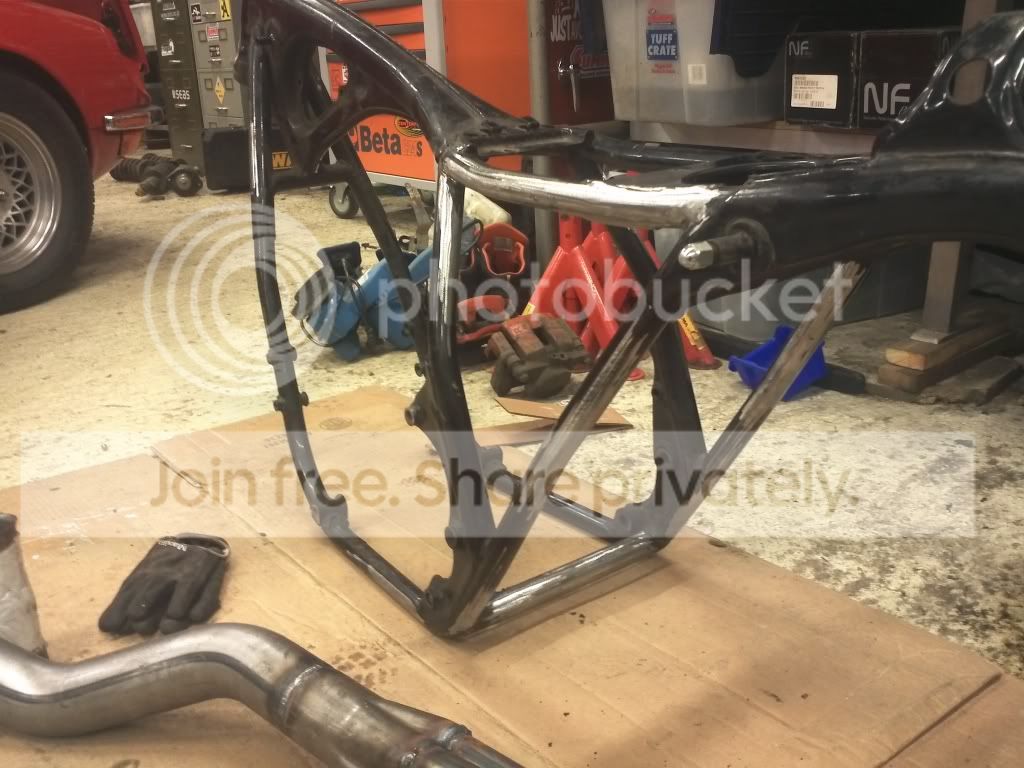

stripped the frame..
engine will be rebuildt, probably getting the heads ported, everything will be blasted and repainted or polished.

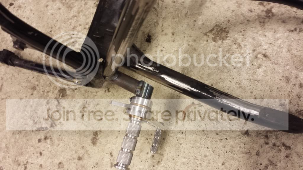

Here i am testing the seating position after installing mounts for rear sets.
Rear set mounting points

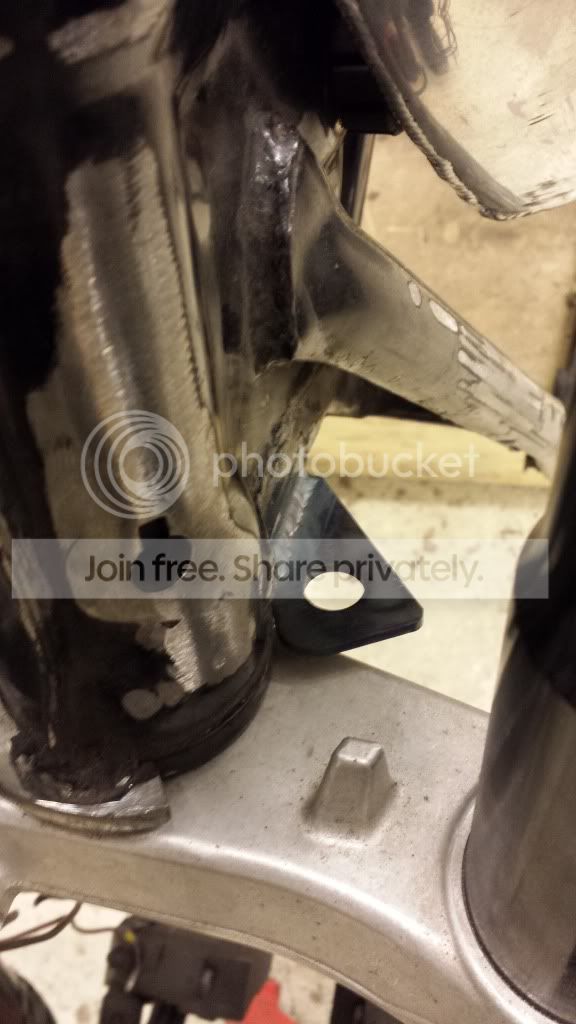

Made a steering stop that uses the posts on the gsxr fork.

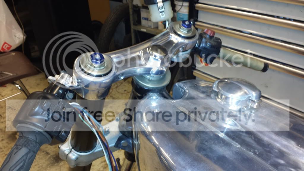

Motogadget gauge, upper fork yoke will be a cognitomoto retro piece.
