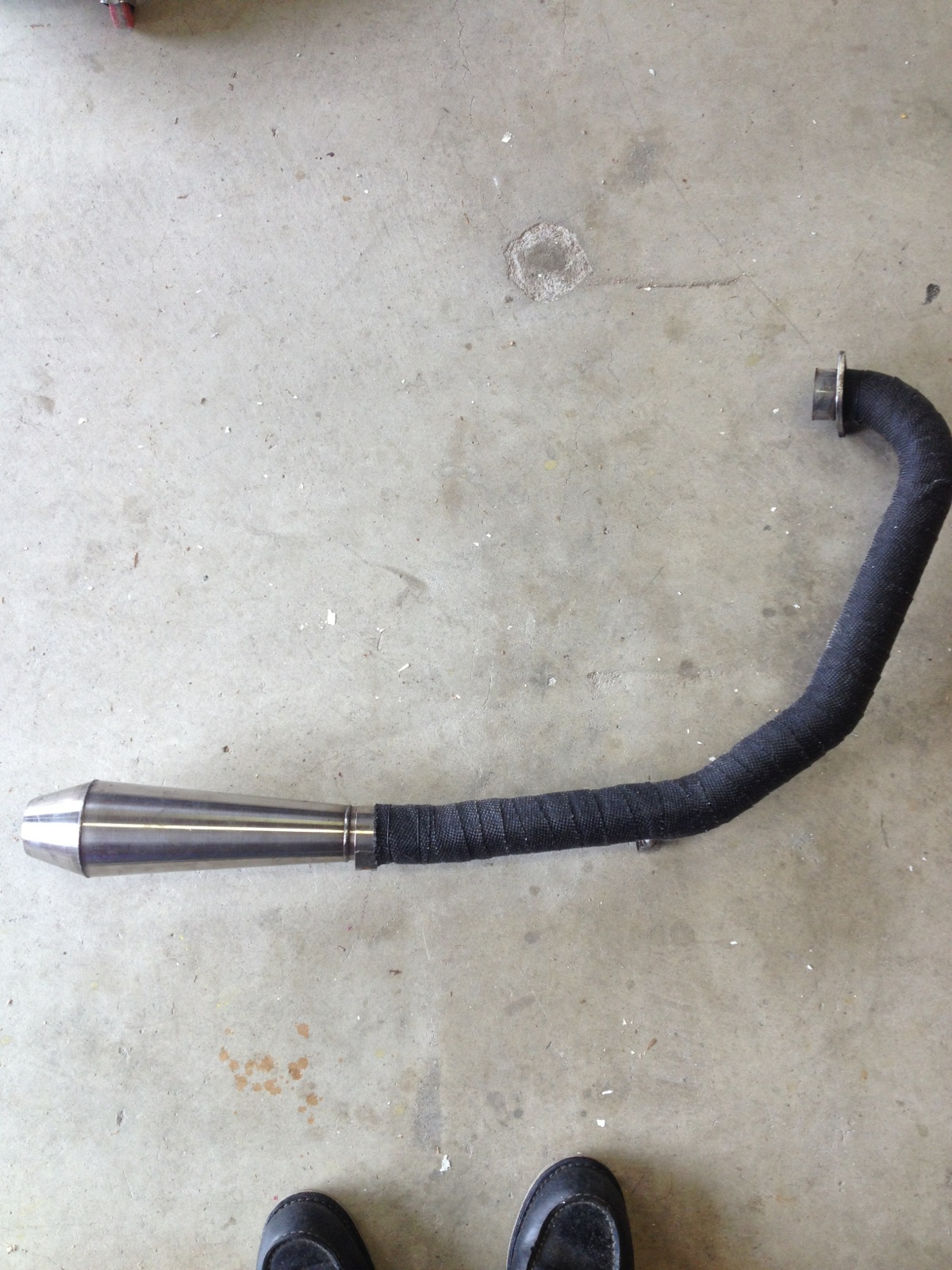

Wrapped my exhaust this morning, sounds pretty different, someone was telling me its bad for the header, I have always herd it was better...
Any opinions?

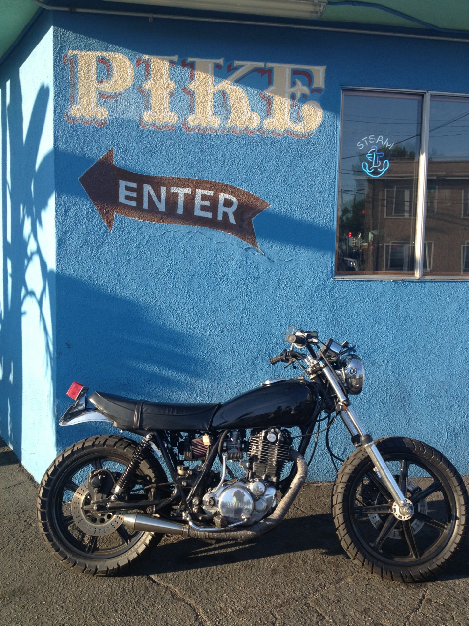

my sr has taken a desert sled turn thinking about putting a skid plate on it, finally have the jetting alot better thanks to teledan

Nice work man! How do you like those tires? I am thinking about getting a pair for my XT.

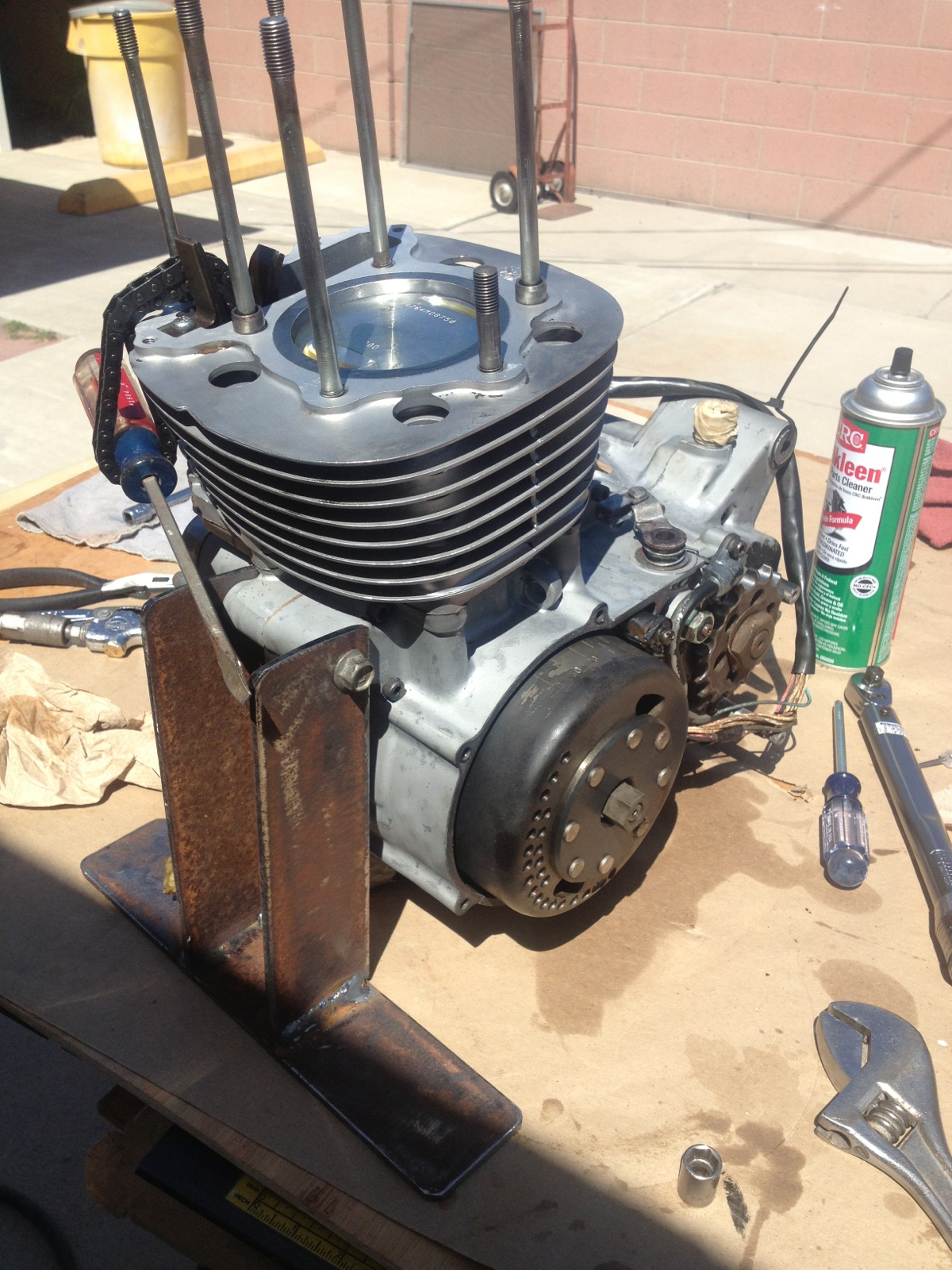

Bike has been smoking more and completely soaked a spark plug in oil, its time to freshen up the top end. pulled the motor out and baking soda blasted the block.

tore it apart my rocker faces are worn out my cam has wear, cylinder is coned. Ordered new cam rockers and a slightly bigger piston. Ordered the new rocker box oiler hopefully to prevent future wear. also blasted the top end.

What did you blast it with? Looks a lot like vapor blasting but most don't have that setup available.
78 SR500 Desert Sled
I'd assume a really thorough soda blasting job?

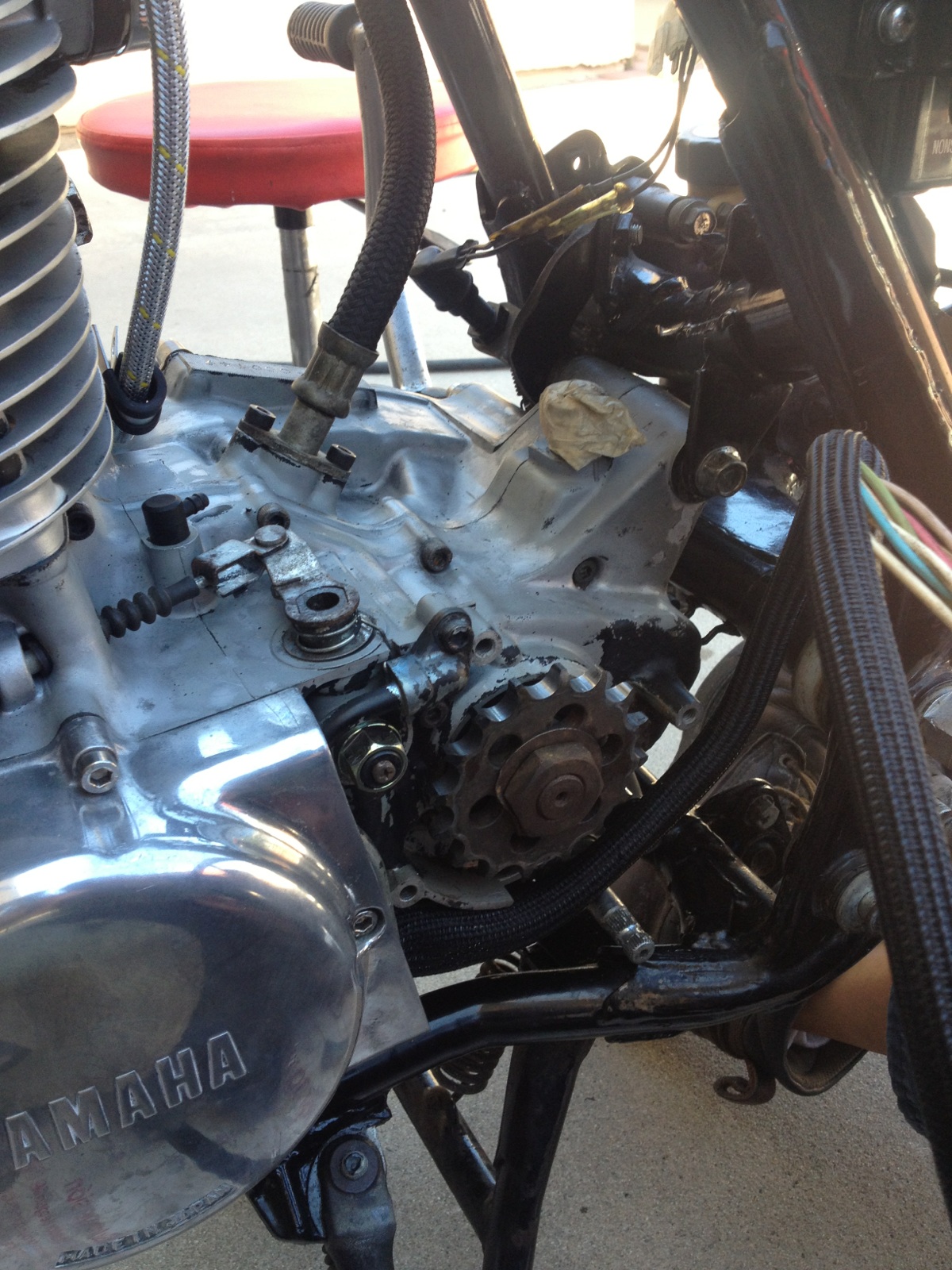

Engine went back together pretty smoothly, i blasted the top end in my neighbors blasting cabinet with glass bead. threw a torq cone in the exhaust port i notice a lot less reversion then before. the wires coming from my stator were in pretty rough shape, i wrapped them in water proof heat shrink individually and put new loom around them. just riding around breaking it in now.

i just went with the stock yamaha cam, i should have went with a johnson with the roller rockers.
